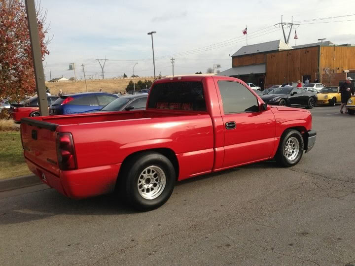

Check out this video on YouTube:
Red truck lays down 1000hp ++ - YouTube
Spiked 1075 but true hp was 1004.38 rwhp
6 liter block
Stock crank
Forged 5 over pistons
Stock 317 unported heads
Isky 218 camshaft from stock48
Pt88 t4 turbo
4l80e

What exhaust side on the turbo and what downpipe size?

96 ar
4 inch down pipe, 4 inch exhaust to diesel muffler

How much boost? What fuel?

Stock rods ? What's your fuel system ?
