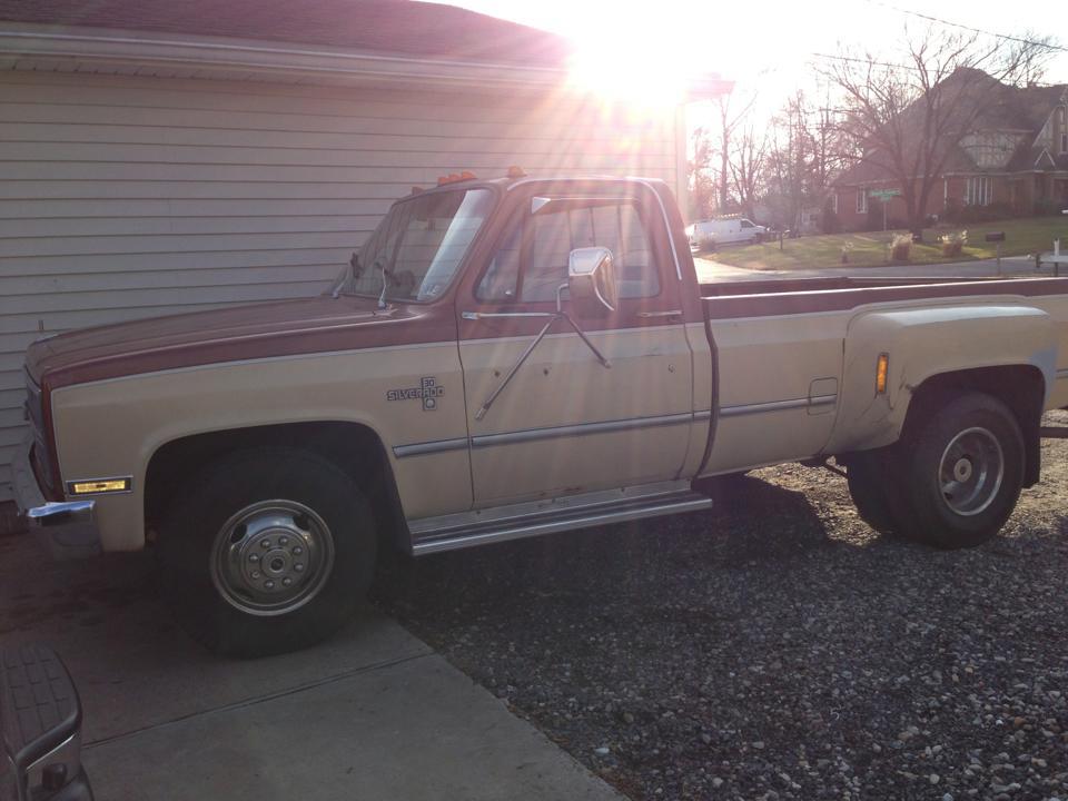

Ok buddy just got back to me, I am wrong as far as it being a EFI. It is infact a 92 engine, is a mechanical. So this makes life that much easier. It will have to get better MPGs then this BBC. I believe the truck has either 456's or 410's in it.. Here is a pic. Truck has almost no rust, dad is the 3rd owner of it. Only mods were gona do it lower it with a flip kit, put the reg style mirrors, remove the running boards. Paint will keep the orig 30 y/o patina,LOL. Truck has 2 dings in the body and that little bit of damage you see on the rear fender. Will make sure to clean the under hood up nice when and if we def do the swap. Truck is full power, everything still works, it drives like a cadi..

Sweet rig, I love those old single cab duallies.
The only issue you may run into is the AC and turbo clearance. If you can find a banks sidwinder manifold then you would have it made. If you dont need AC then problem solved there too.
