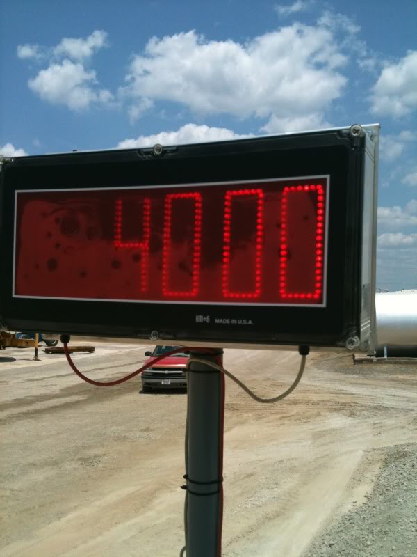

Yea im not sure mine all works together well. 4.88's with 29.5x10.5 MT's, 3800 stall. Last time out wih this setup it ran 1.57 60ft 11.92@110. My slicks are heavy with the 15x10 steel wheels and i run 20x8.5 up front (78# each). Heres my weight on street tires and i think 1/4 tank of gas.

Was that weight with you in the truck ? Pretty dang light.
Mine was 4140 lbs with 1/3 tank of gas (street wheels\tires) and me inside too.

Yea that was without me. Its 4180 with me in it. I will have to go pull out the old slips and look at all the 60's i dont remember what it was on nitrous. My dyno sheet reads less than it is (gotta multiply by 1.1).

I think it was 1/4 tank and the list is
Sway bar is removed, went from iron block to aluminum block, relocated battery under bed, removed tow hooks, empty washer bottle, battery tray, tray under intake system, jack and tools, spare and winch, plate winch bolts to, crossmember between bed and cab, evap system, built a custom fuel cell to go where spare was, swapped rear bumper for rollpan, center jump seat removed
Thats all i can think of right now, may be all of it i dont remember.
Heres a pic the day i went to the scales. I took this then drove 5 mins down the road and weighed
