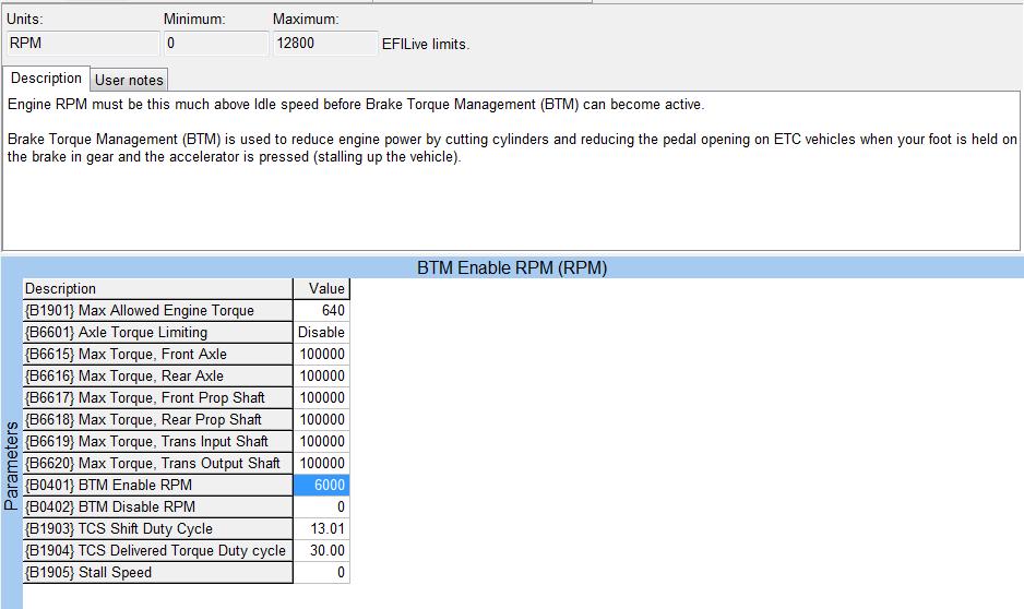

If you pushing threw the brakes you might think about upgrading your brake lines to SS, they may give you a little more holding power... Also check out your tune and make sure your brake torque managment is 4000+.... Also you might want to log a launch to see if you getting any "False Knock" (which pulls timing) due to brake stalling the verter...

I'll try flasing it next time. Is brake torque management different from regular torque management? I have all my torque management turned off.

Originally Posted by circusboy
I'll try flasing it next time. Is brake torque management different from regular torque management? I have all might torque management turned off.
Yep it is....
