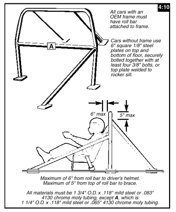

if the truck has un-altered floors, firewall and frame rails (wheel tubs are okay), then a 5-point roll bar is good til 10.00 1/4 mile (6.40 1/8-mile).

How would you do a 5-point in a reg cab? Four corners with a V on the back bars?

5pt roll bar.
