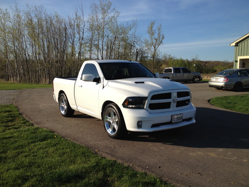

Belltech 964SP is the kit everyone uses. My 15rt had it.
I would suggest f150 front sway bar links with the kit to help correct front sway bar angle.
If you really want it proper, the Spohn Adjustable rear control arms and panhard bar. IT really give the rear of a truck a positive feel(all delrin bushings)
my old rt

would this one be good enough ? Belltech 2/4 Drop Kit With Street Performance Shocks 2009-2018 Ram 1500 2WD Regular Cab also do I need the hellwig rear sway bar as well?
