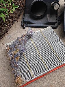

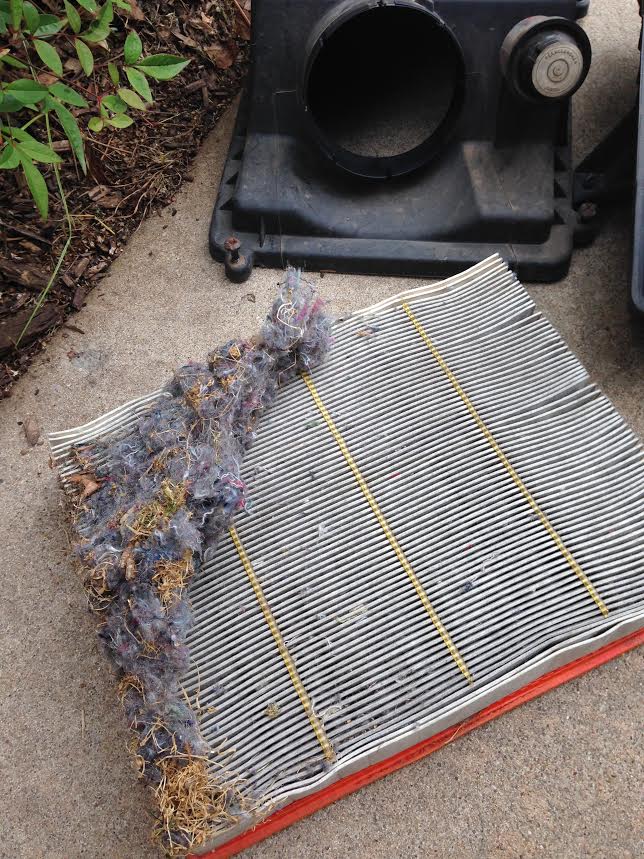

Here's a picture of the old filter, looks like rats had been living in the box

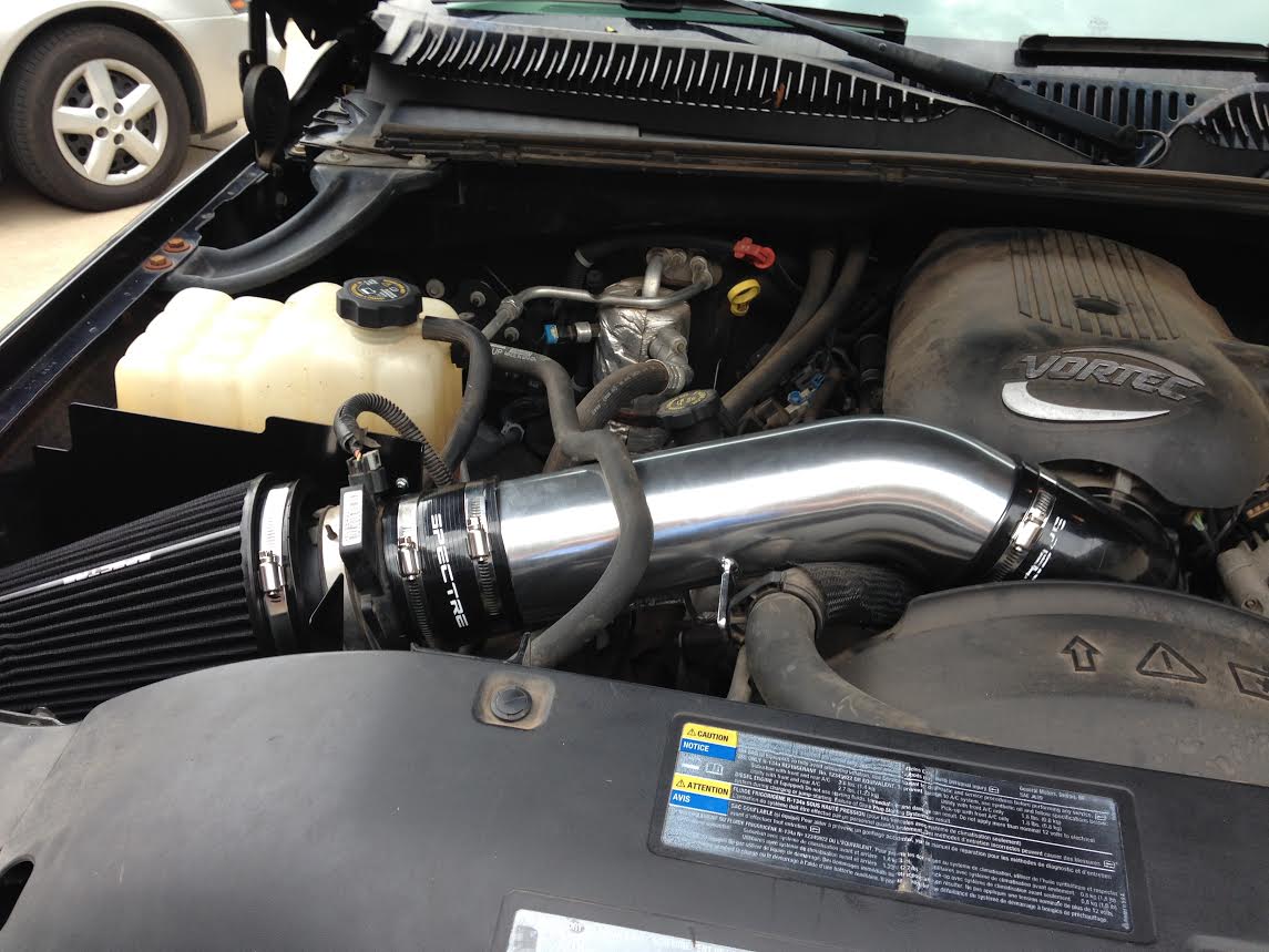

And here's a pic now, much better. I really need to take an air compressor to the engine and clean her up a bit.
