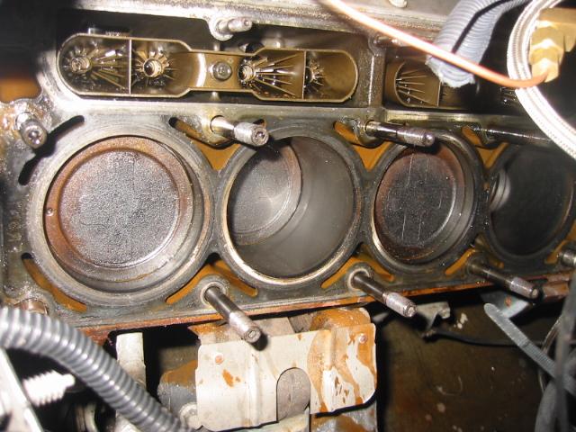

Very nice! Good work. Shortly after my 25psi run on the dyno I was wondering how the motor looked. (I also wanted to swap to a ported set of heads)It blew a fuse on the dyno we thought it died but it blew the ecmB fuse. I think it was because of the boost a pump, it needed me to upgrade the fuse and I didn't. I run 18-20psi on the the street all the time. Here is some pics of the motor, I think it looks pretty good. What do you think? I had alittle cancer in one of the cylinders from the motor sitting in someones garage for 2 years with alittle water in it.
