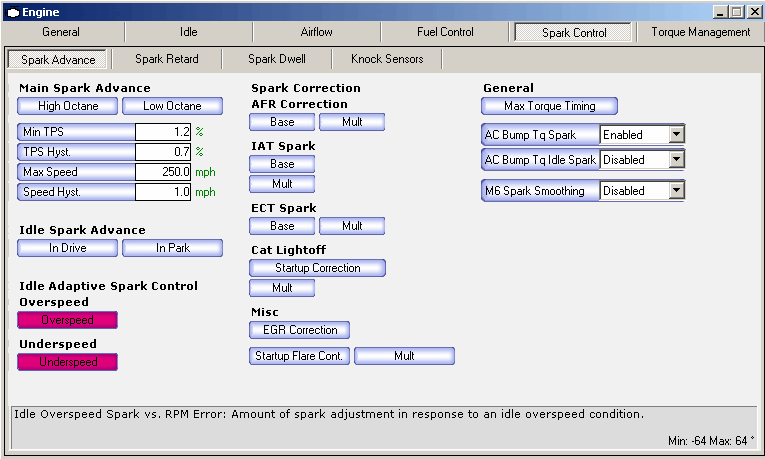

There is a underspeed and overspeed spark table that you can use to help fix this problem in the spark table section. Just pull more timing out.
he is running the factory Magnuson Cal. Fuel pressure is 55 KOEO and holds just fine. Truck was driven and Fuel Pressure did not drop below 59 @ WOT. No vac leaks, everything is installed better than any self install I have seen in 6 years. He is local (simi valley) might want to PM him for some weekend work

these?
