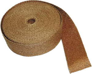

GENERATION II COPPER HEADER WRAP
Generation II Copper Header Wrap improves heat resistance up to 30% more than current technology, by utilizing a new proprietary coating developed by Thermo-Tec; improved Thermal-Conduction-Technology (T-C-T).
Generation II Copper Exhaust Wrap creates more horsepower and reduces under-hood temperatures, increases exhaust scavenging, withstands continuous heat up to 2000ºF, contains no asbestos.
Generation II Copper Exhaust Wrap is sold in one or two inch wide, 50 foot rolls with a low profile 1/16" thickness.

I painted the exhaust with high temp exhaust paint 1200* then I used 3 rolls of exhaust wrap from the exhaust manifolds to the turbo. The cats took up alot of the roll, (My cats are hollowed out) I used black 2 inch 50" feet rolls (3) I painted the wrap with wrap protecting paint high temp, and then another coat of 1200* white high temp paint again. (for the rot issue) I think it did help on spooling, I didn't gain on max boost. I know it helped my two step build boost. The paint is holding well on the turbo hot side, but (before I wraped the exhaust) I did notice paint flaking off on the exhaust near the exhaust manifolds, but I think that is because I didn't clean the exhaust before I painted it. I just put two more coats and then I wraped it and painted it.

I think the header wrap is a great idea, but eveything I had wrapped started to rust big time. Unless you have stainless pipes you will see them rust, even with the high temp coating that STS uses.
