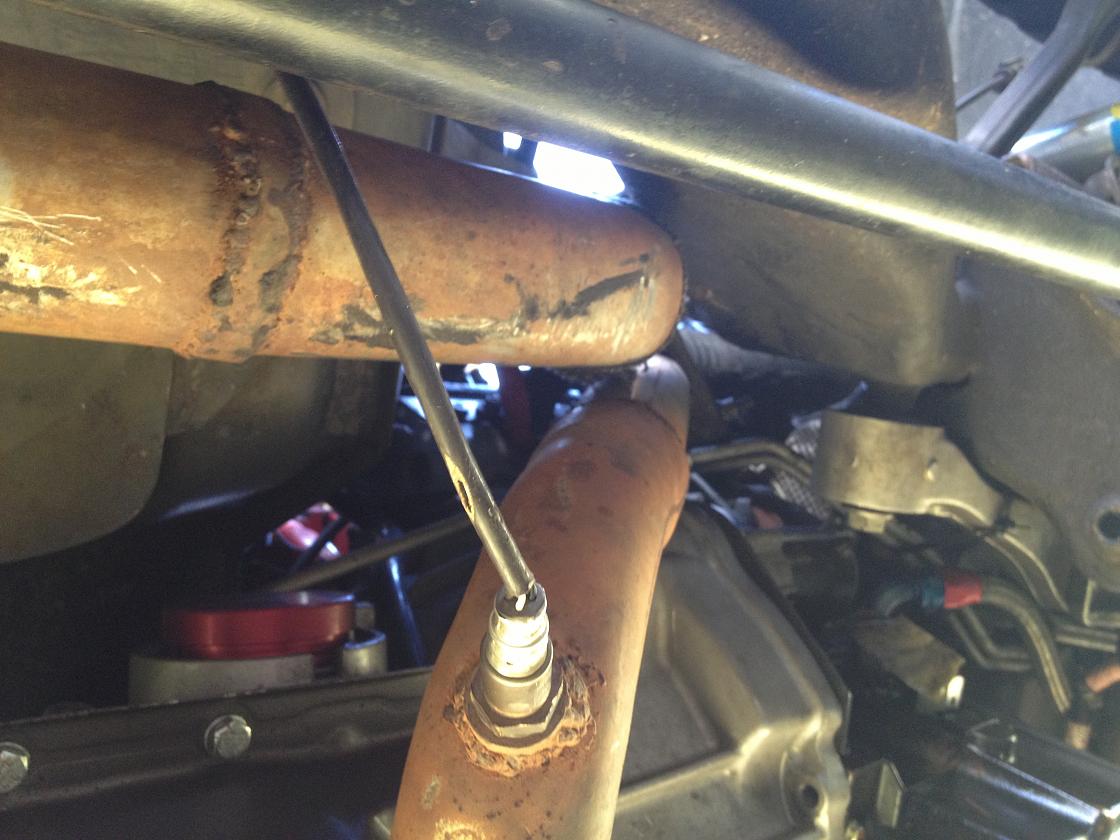

Putting the pass o2 in the downpipe is fine. Done it for many many years.
The o2 will read the same there or right before the turbo.
The glitch comes in. If both sensors are in the same area. Like driver side stock. Pass side in the crossover before the pass cylinders are included.
I will say its that or a bad injector.
Had this issue years back. Truck ran fine then started acting up bad.
Swap the stock injectors back in. Swapped the tune. Truck ran fine no stumbling at the rpms like before. Nor stumbling tell the injectors ran out.
Swapped the other injectors back in. Swapped the tune.
Stumble back.
Drivers side had a bad injector.
Wide band read fine. The computer seen a lean condition on drivers side so the PCM dumped more fuel in that bank.
The other 3 injectors picked up the slack. But one cylinder wasn't getting much. Luckily I didn't burn it up.

I bought them used from a member on ls1tech. He said they only had 1500 miles on them. Ill try fixing the exhaust leak and moving the o2 and then if that doesn't do it I'm going to order brand new injectors

Post pictures of the kit...
It won't let me..I've tried a few times. I don't have a photobucket or anything.
