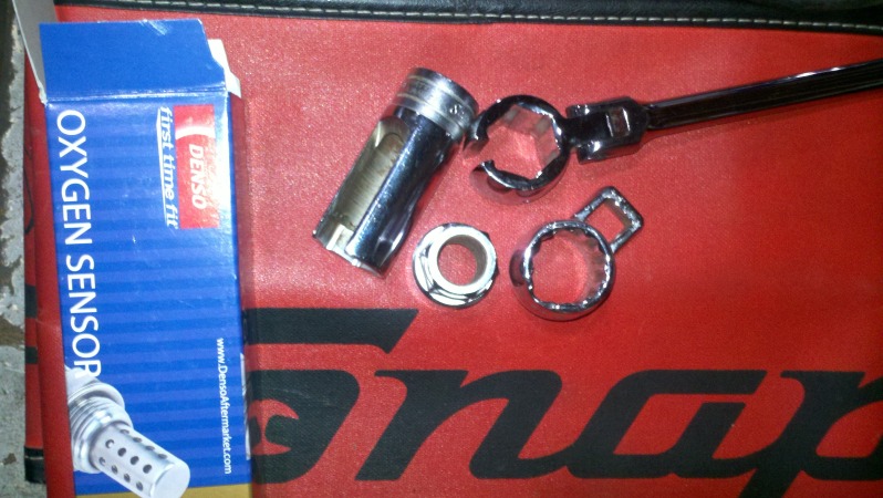

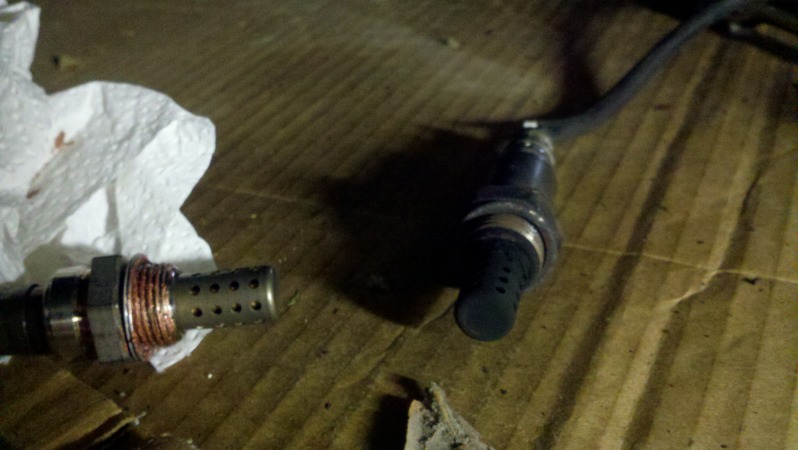

Ya, this is maintenance, but still, it'll perform better when bad o2 is gone. All carboned up, this is B1S1. B2 is worse, way worse. MPG's gotta improve by this alone, but w/. 100 extra HP or so, it's just a good idea.
The 2 on top are used only: 7/8" o2 Dp. skt. w/. slit works on my L side, but RF needs to have collector removed & exh. dropped cause o2 is so close to frame, unless I have this tool, then no exhaust droppin needed.

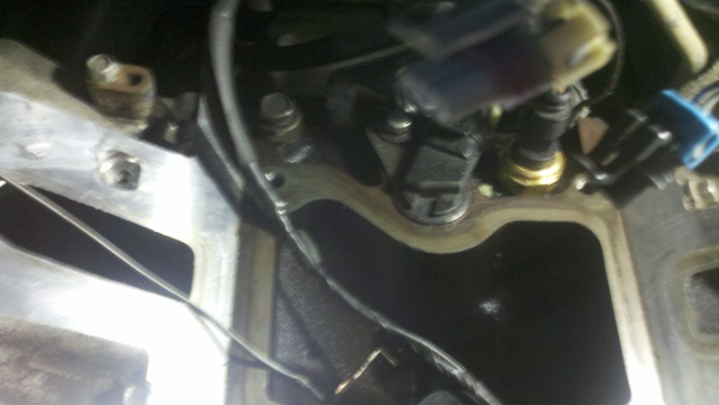

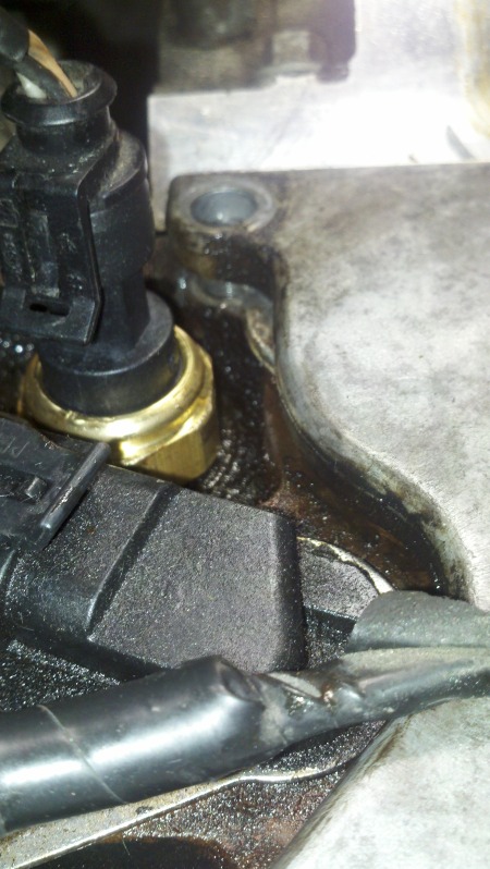

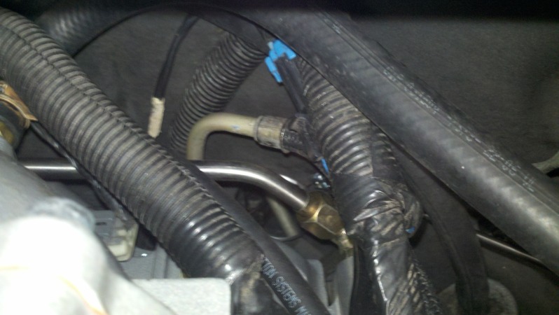

Oil Press. Sending Unit, good luck finding it. It's there tho.

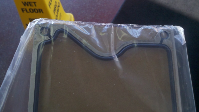

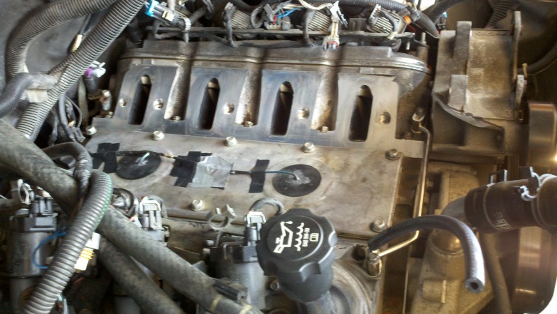

Sadly, Radix came off cause somethin was up.

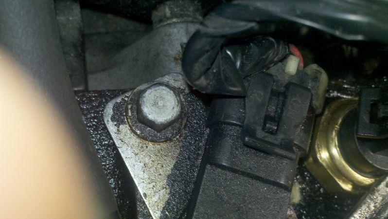

The culprit!!!
Not on your best day is it comin loose.
A better view why not.
They only go 1 way, installer error. Experience woulda likely helped me not do that, but this was all new to me. Distractions don't help either!!!

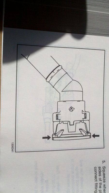

Valley Pan never had to come off, but thanks to Magnacharger for sendin me wrong directions. Twice!!!
Original was for SUV, differs some than Pickups. After callin them, they sent for TVS but I found that out after printing 70 pgs.!!!
I replaced it anyway. Cause I don't wanna go diggin back there again.

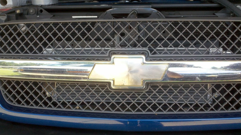

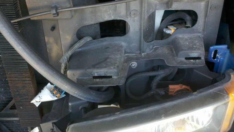

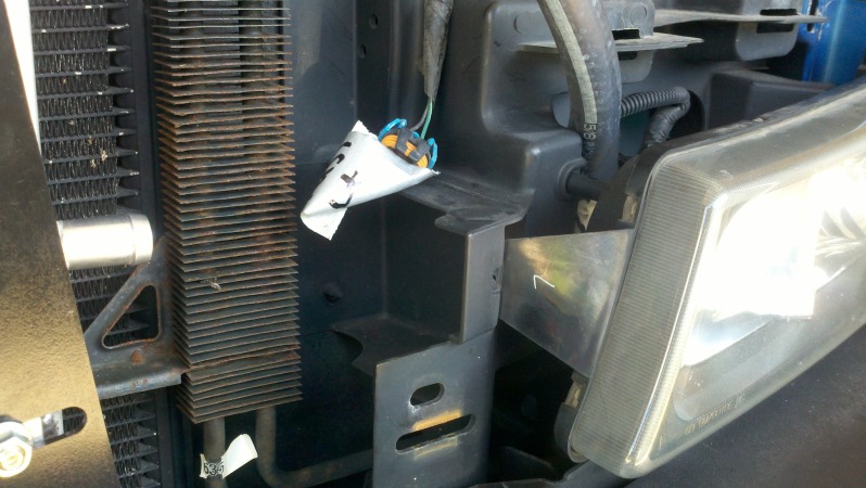

No, if Magnacharger sends u instructions for SUV, they're not same as Pickup. The 2nd set, for TVS, aren't either, but they sent to me & then I find that out after printing 70 pgs.!!!

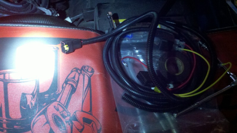

IC Pump W/H

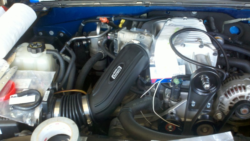

Will it work or not? Another time I'll check.

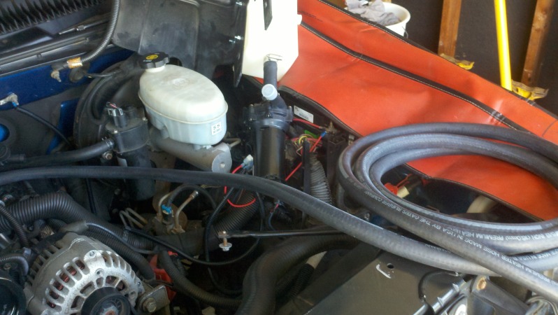

5/8" IC Hose, same as Gates Htr. Hose

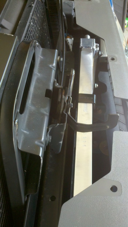

Looky there!!!
HX, My brkts. work w/. their brkts.

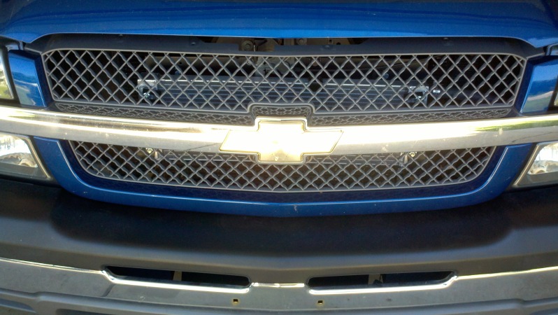

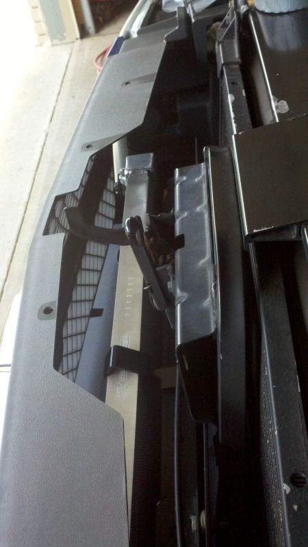

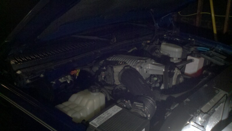

Lots of room behind grille.

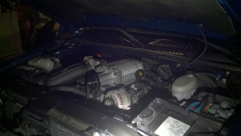

Peekaboo
There goes my Stealth Factor.
I had to take some pics, even if it was in garage at night using only a droplight.

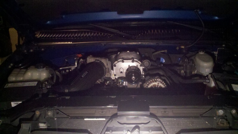

What lurks beneath?!?

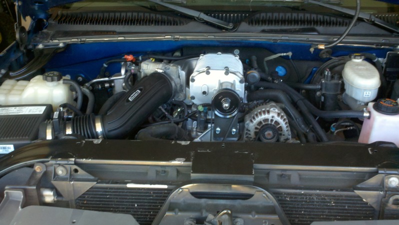

A Proper Introduction!
