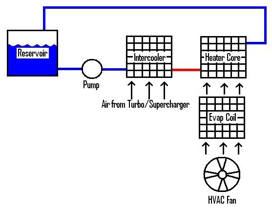

I ran my heat exchanger hoses to my heater core and i can get my IATs about 20* below ambient

+1 I've been running this setup for awhile and it kicks ***. At the end of a run with meth my IAT's were still below ambient. I didn't see the need to tap into the AC system and carry all the extra weight and cost of a killer chiller. The only downside is you lose your heater, but in the winter (about 2 months here) I just switch to a front mounted heat exchanger. IAT's are still low, and I can have heat in the cab. I might install some tee's and ball valves or something.
