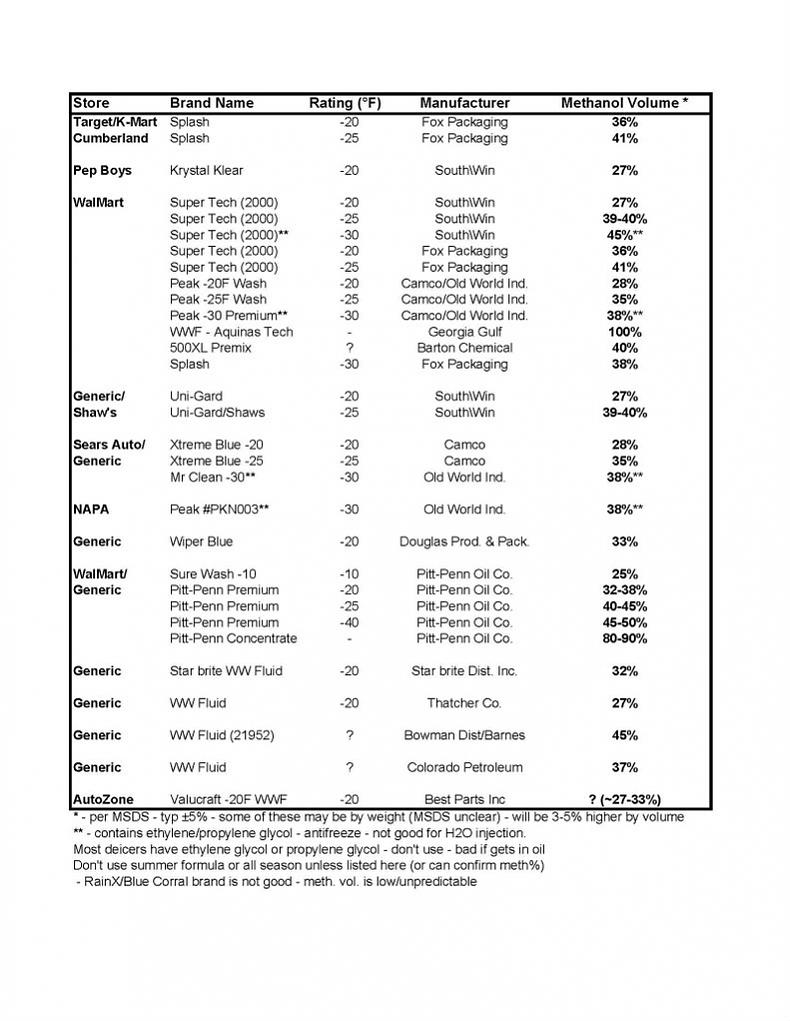

Not sure of the accuracy, but I've run across this:

I went by that for a lil while. Just ended up gettin 5 gallons of supertech -30* WWF and 25 gallons of VP1. Premixed them and put a extra 5 gallons in my toolbox so after i filled my tanks id have spare for awhile.
Just make sure you use the same mixture of the same stuff, be consistent so your tune dont need tweaking.
