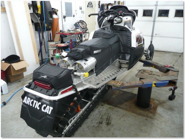

The turbo propane 2 stroke mountain sled was a kit I installed that got me started on this whole idea, I wanted to use it all the time but it was somewhat limited to mountain use and I live in wisconsin... Here is a vid and some photos of that,
