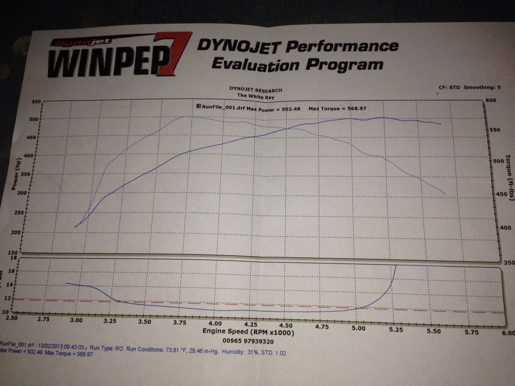

I think I understand what your saying. Is that the regulator is commanding for example 55psi but the travel and size of pipes fuel rail pressure will be lower yes makes perfect sense.. So my fuel pump and regulator are working perfectly at idle as I see about 51 psi at rail. But when I go full throttle pump can't keep up around 5000 rpm so looks like boost pump might help..
Went to dyno last night air fuel just gos lean around 5000 rpm

Yes bro .. That what im going to do first i going tonight get msd boost a pump i will do a serch on this fantastic forum how to install it will go back to dyno see if it works
But im worried that on dyno with zero g force pull it wont give real world air fuel pressure
