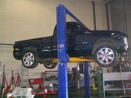

The old combo was a supercharged 408, but 3 years later after the tear down, The blue beast is is almost on its feet again.
I went with a 414 with twin 72s this time around. It is a 4 wheel drive select truck with a 40 spline Dana 60, fully built front diff, one off custom T-case with custom chains and sprockets, full built 4l80e, Baer 15 inch 6 pistons, and many other extras for most that probably don't remember the truck.
Anyways, I figured I should start posting back up on the board again since the truck is almost done and I am back in the scence.

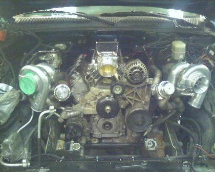

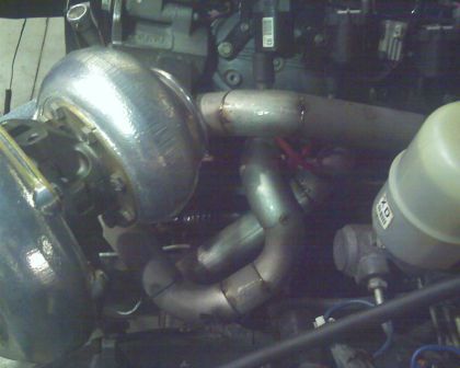

Here are some progress pics for you guys.
The hot side is built out of 316 stainless. The intercooler is made of 2 PT 900 HP cores for an efficient air to air 1800HP intercooler. The truck is running dual Meth systems with the plan to cover 30 percent of the full boost fueling with straight Meth on top of the AN fed dual 255 racetronics in-tank.
The truck is also running the new NOS boost referanced touch screen progressive contoller with a 250 shot launching of a 3,500 converter with a regressive shot that is set up to drop 10 HP per pound of boost to a max 25psi pump gas boost.

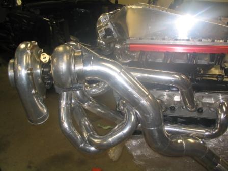

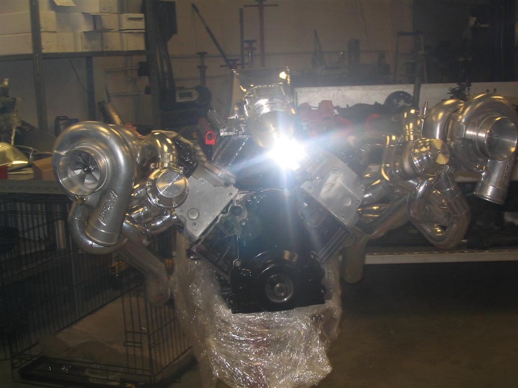

The Turbo fab
Attached Thumbnails Twin 72 414 01 silverado-drivers-manifold.jpg   Twin 72 414 01 silverado-manifold-2-large-.jpg   Twin 72 414 01 silverado-turbo-manifold-passenger.jpg   Twin 72 414 01 silverado-blue-meanie-turbos.jpg

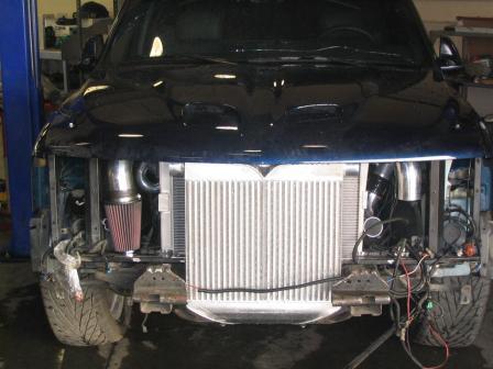

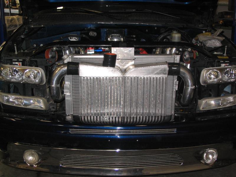

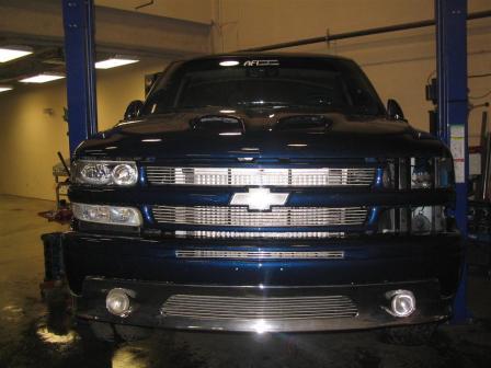

The intercooler.
Attached Thumbnails Twin 72 414 01 silverado-intercooler-cores-large-.jpg   Twin 72 414 01 silverado-intercooler-finished.jpg

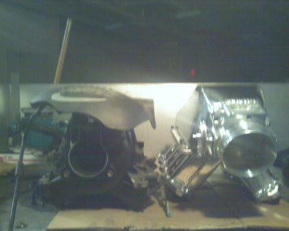

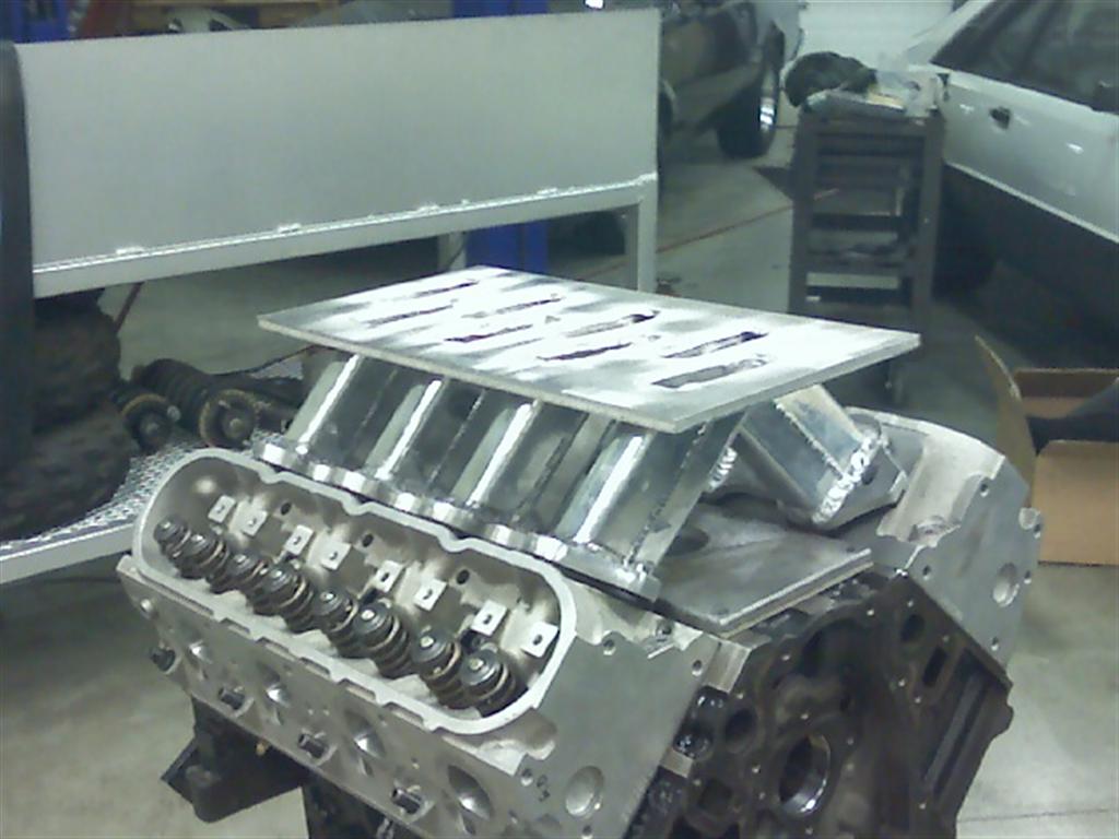

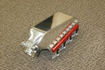

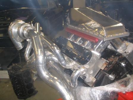

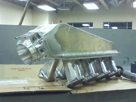

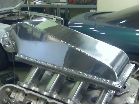

The sheet metal intake.
Attached Thumbnails Twin 72 414 01 silverado-intake-base-2-large-.jpg   Twin 72 414 01 silverado-intake-3-large-.jpg   Twin 72 414 01 silverado-intake-10.jpg   Twin 72 414 01 silverado-intake-polished.jpg   Twin 72 414 01 silverado-comparo.jpg

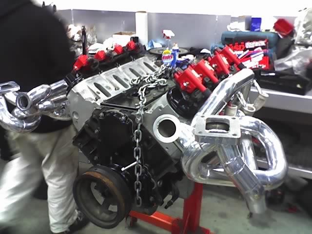

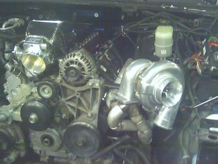

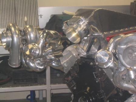

After the mock up, finish welding, and coating.
Attached Thumbnails Twin 72 414 01 silverado-17-02-08_2109.jpg   Twin 72 414 01 silverado-picture-042-large-.jpg   Twin 72 414 01 silverado-turbo-1.jpg   Twin 72 414 01 silverado-turbo-2.jpg   Twin 72 414 01 silverado-turbo-3.jpg

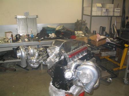

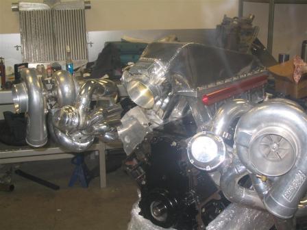

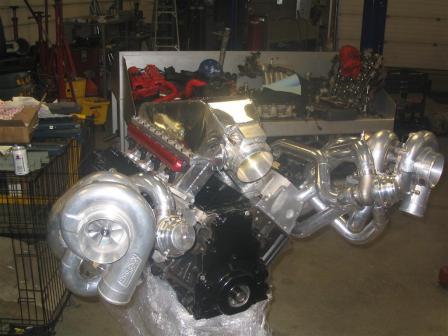

And back in after mock, finish welding, coating, and engine assembly for the last time (Hopefully, LOL).
Attached Thumbnails Twin 72 414 01 silverado-img_4762-small-.jpg   Twin 72 414 01 silverado-img_4763-medium-.jpg   Twin 72 414 01 silverado-img_4764-medium-.jpg

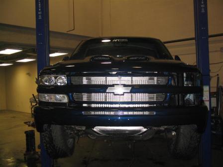

And finally the last pics as it sits. Around 12 man hours I figure away.... Which we all know means 30 LOL.
Attached Thumbnails Twin 72 414 01 silverado-picture-073-medium-.jpg   Twin 72 414 01 silverado-close-1.jpg   Twin 72 414 01 silverado-close-3.jpg   Twin 72 414 01 silverado-close-4.jpg   Twin 72 414 01 silverado-close-5.jpg
