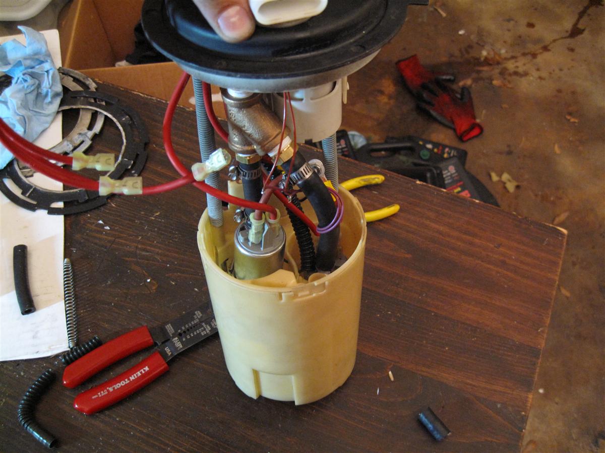

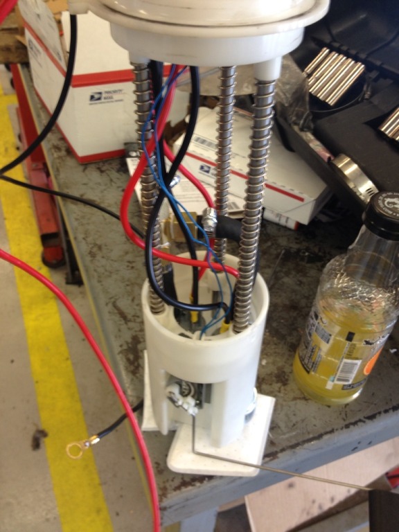

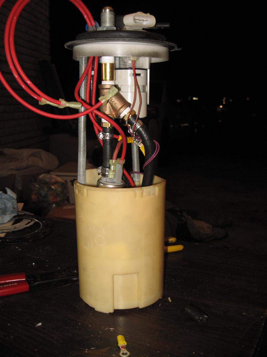

Lonnie's performance makes a nice kit. You could make your own for cheaper though
Here's some pics of mine
For the wiring, I used 10ga. 2 30a relays. I tapped into the stock pump wiring to trigger the relay. For the second pump I have a Hobbs switch in the ground for the relay. At the set pressure the switch will close and complete the circuit turning the pump on.
Is that a big crack in your bucket? Or just a bad pic?

It's a crack from where I the Bosch 044 in it

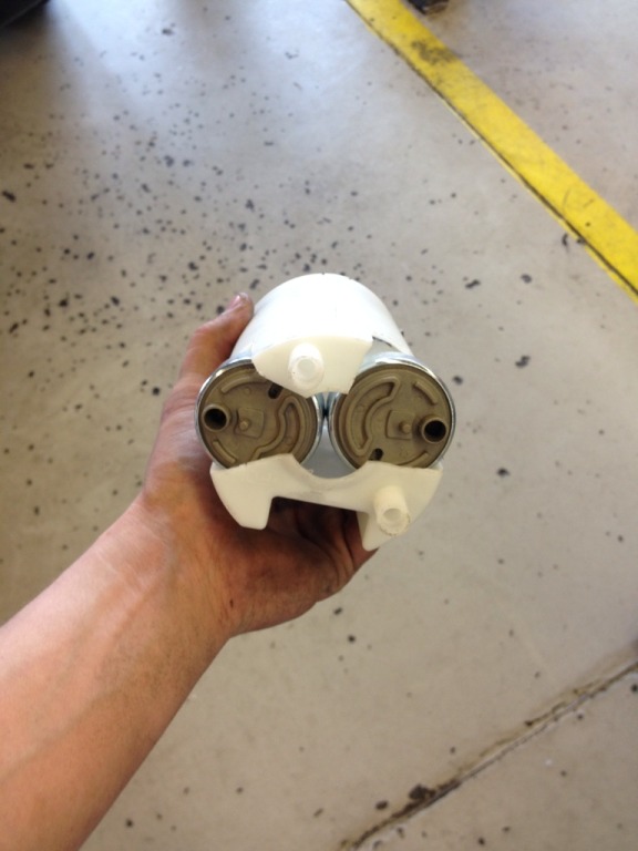

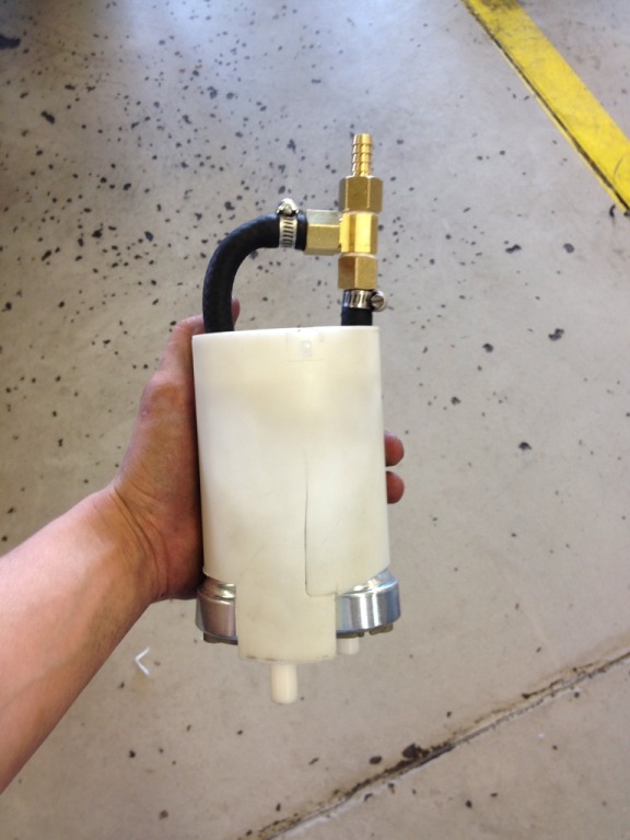

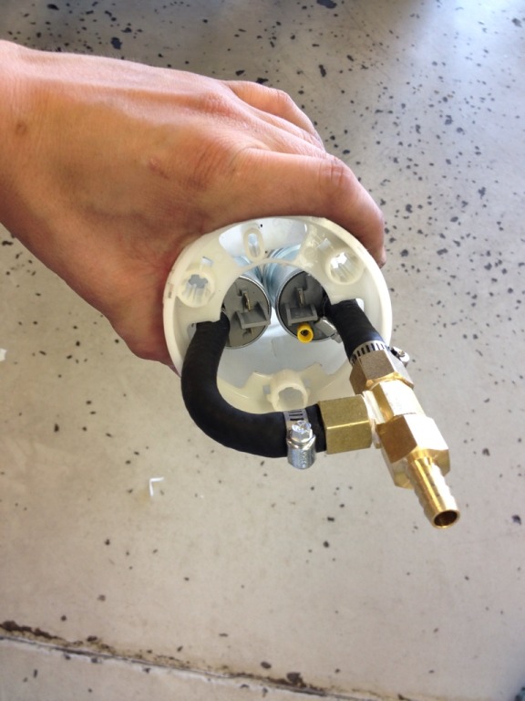

Heres mine with dual walbro 400s with a -8 bulkhead in an 05 bucket with an 07 top
