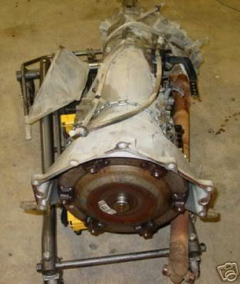

Do you knowledgable folks think this will work in my 98 4x4?

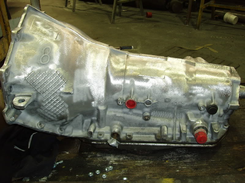

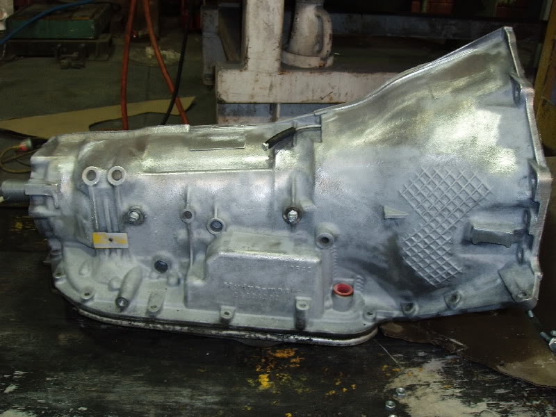

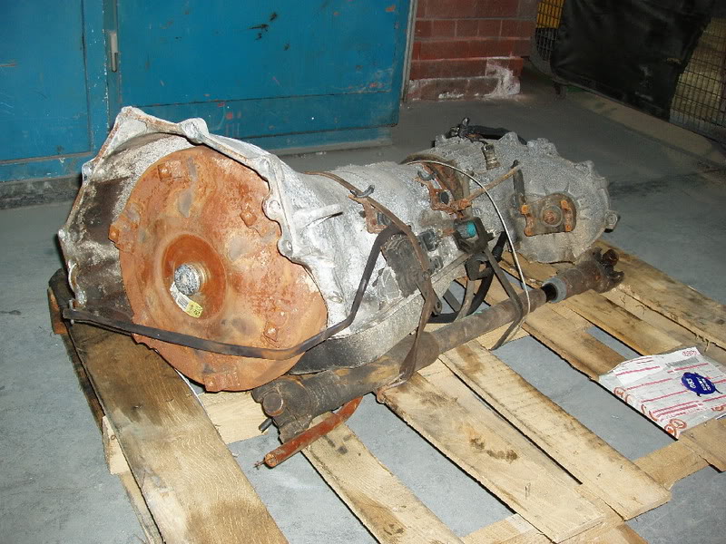

I bought a trany from PA and had it shipped here to Oz.
It had 50K on it but I didn't know that for sure so I rebuilt it.
Before:
After:

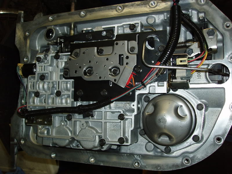

Transgo kit installed:

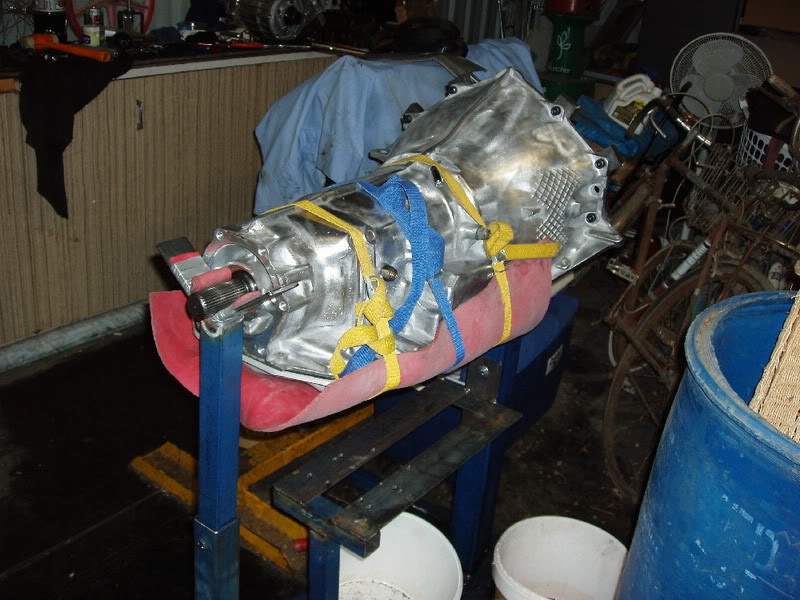

Rebuilt and ready to go in:

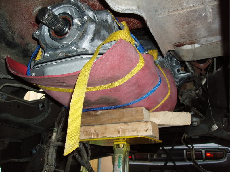

In the truck:

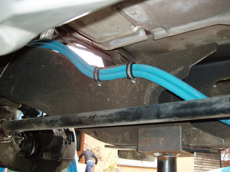

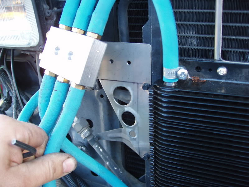

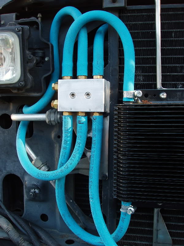

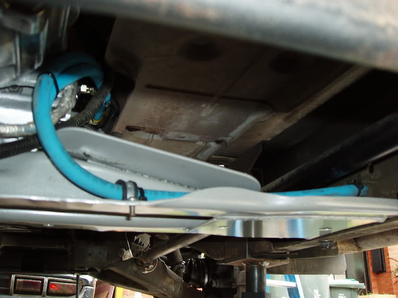

Installed some trany coolers:

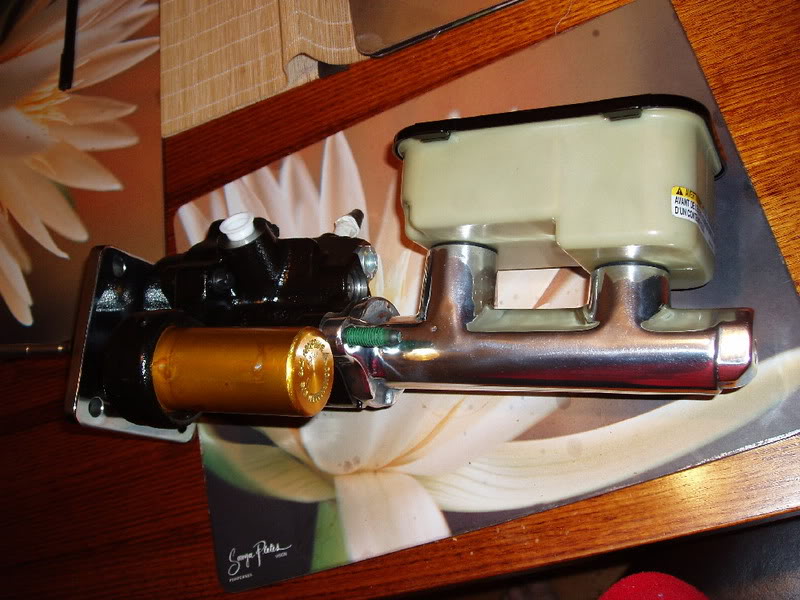

Polished up and installed a Hydroboost unit:

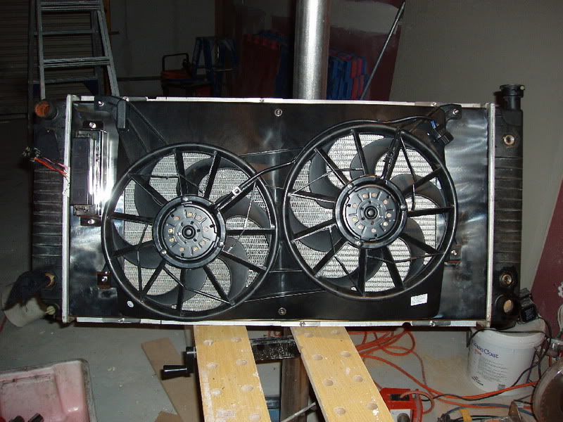

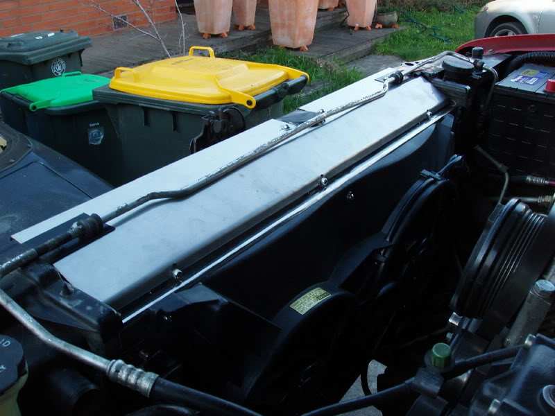

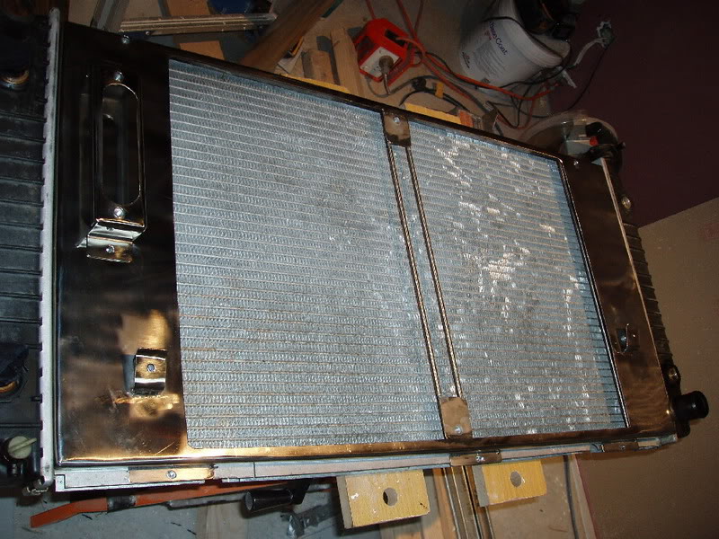

Built a stainless shroud and installed elec fans:

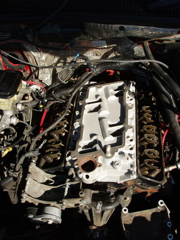

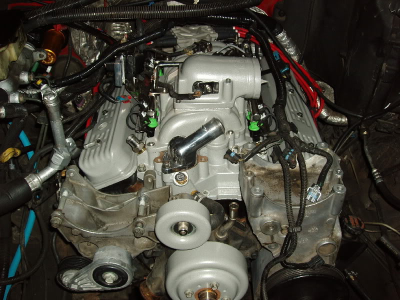

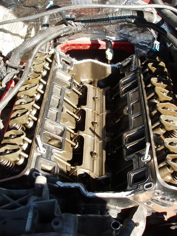

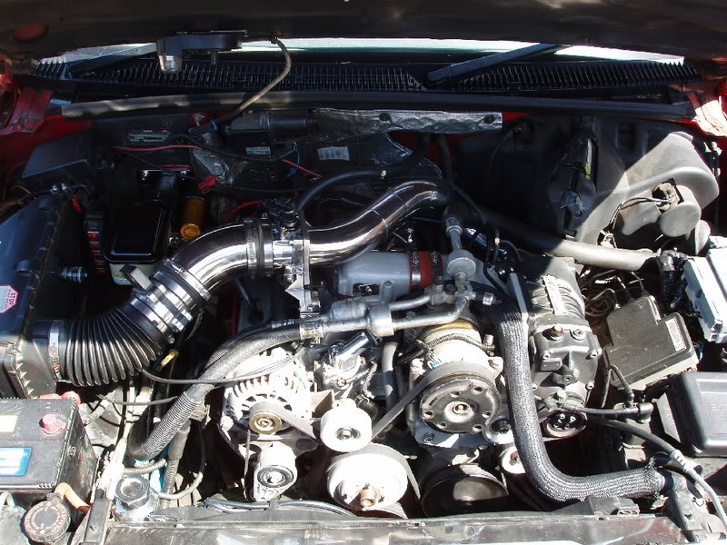

Installed the Marine Manifold:

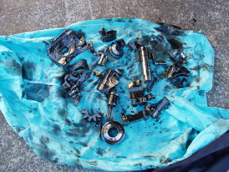

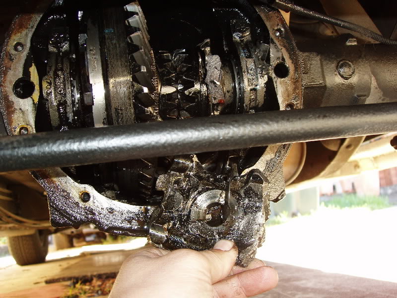

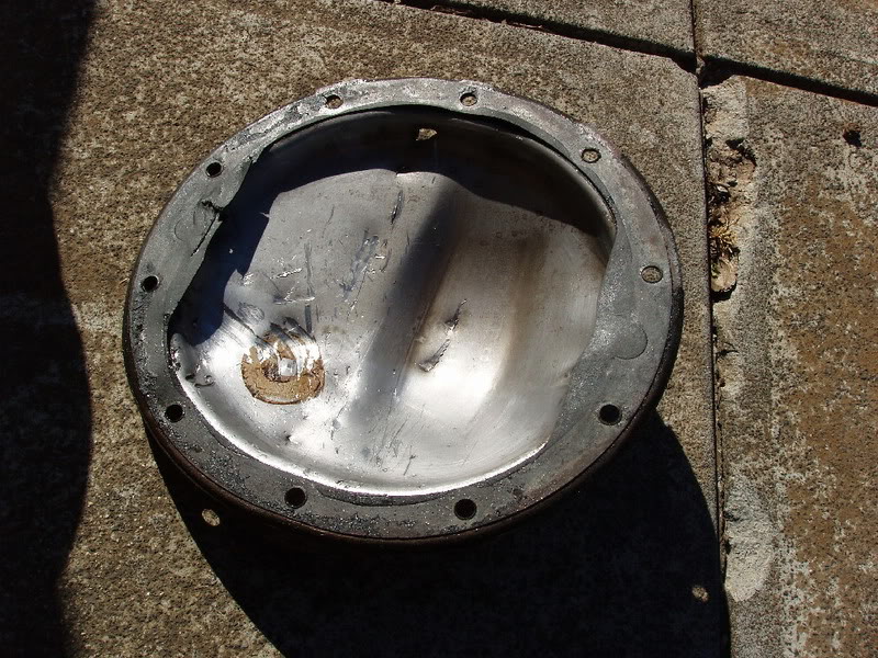

Then found out the Diff was shot!
I ordered a Detroit Truetrac and new ring/pinion. Should be here in a week.

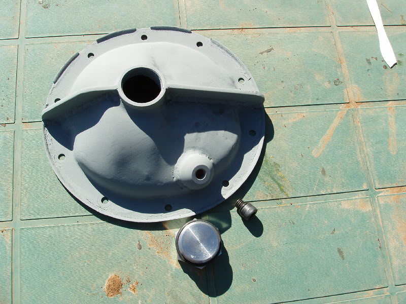

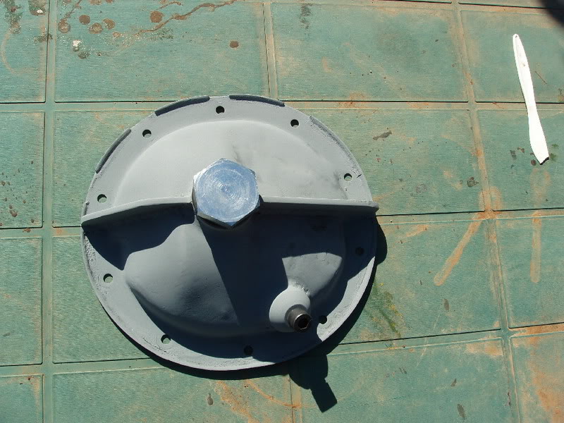

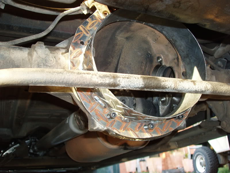

I built a new TOUGH diff cover (still to be finished and powder coated):

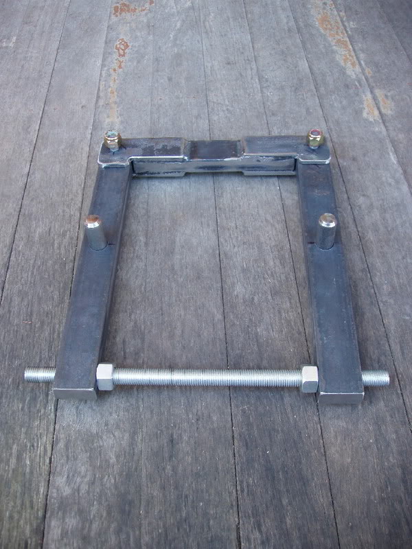

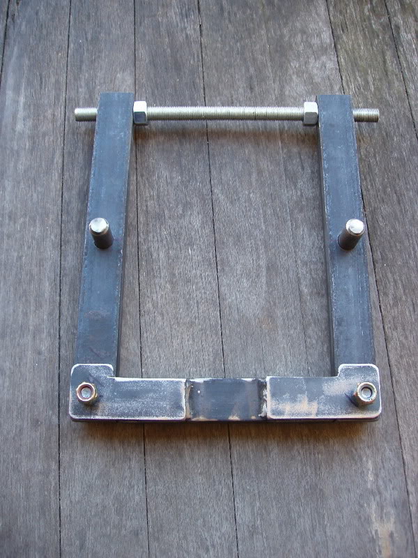

And today I built a diff spreader:

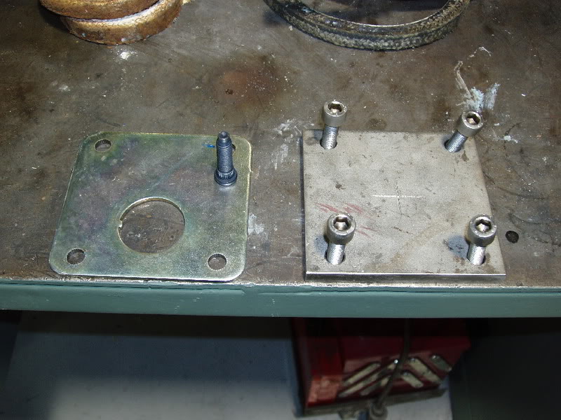

The Hydroboost adapter plate:

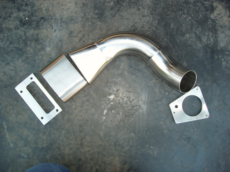

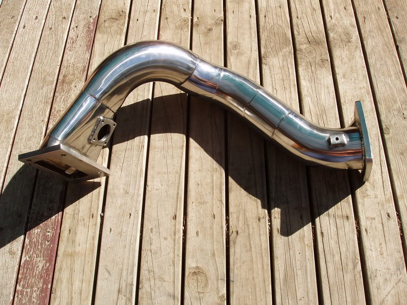

Here's the whipple inlet I had to make.

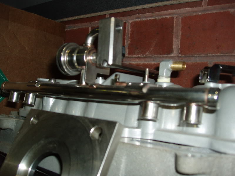

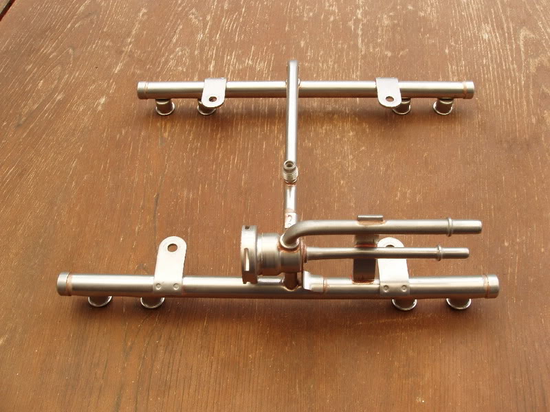

Adapted the Marine fuel rails to make them a direct bolt up to the original fittings.
Before:
After:

Yeah...I haven't found anyone else with the 80E in a Burb. Deffinately not a 4x4 petrol Burb.
All in all, it was a pretty straight forward swap.
As for the wiring. The only thing needed is to run 2 wires from the PCM to the front speed sensor in the 80E and then make some pin swaps at the PCM.
Original plug from the 60E plugs straight in.
I rebuilt the 80E...first time I've opened an Auto and it wasn't too difficult. There are lots of neat little tricks which make things alot easier and remove the need for specialized tools. I did ALOT of reading online.

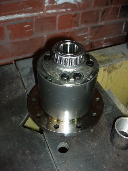

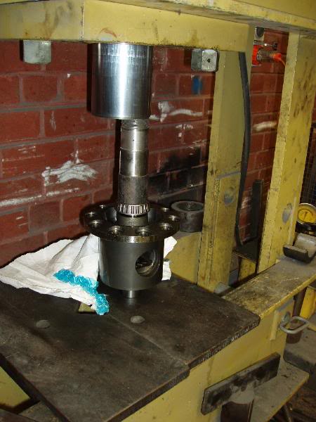

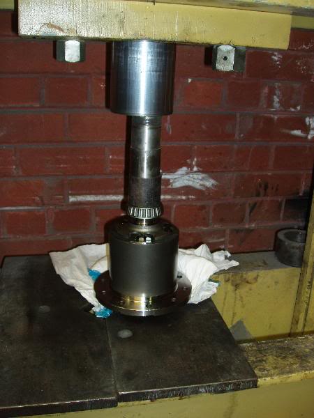

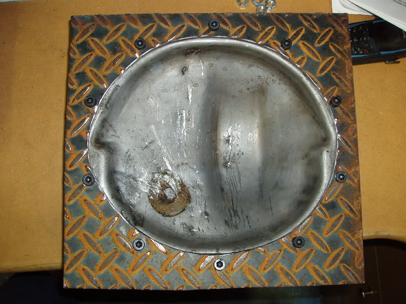

Finally received my Trutrac.
Pressed the bearings on (after going into a panic because they were different size to the G80 bearings...ID is bigger on the Trutrac).
Reworked the original cover for the moment.
