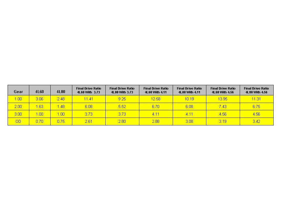

Attached a better table
Attached Thumbnails 4l80 is in.  Looking for advice on 4.10's-presentation1.jpg

In terms of drive ratios 4.56 gears will bring the final drive ratio similar to a 4L60 with 3.73. I think that is way too high for every day use but great for the track.

Maybe for the 1st gear final ratio, but the 4l80e has a lower OD gear than the 60e does. You will need a 4.10 gear with the 80e to equal the cruise of 4.56's with a 60e, roughly.
80e 1st 2.48,2nd 1.48 3rd 1:1 OD 0.75
60e 1st 3.06 2nd 1.63 3rd 1:1 OD 0.70
I hate the deep 1st gear of the 60e, when it shifts to 2nd the revs come down to far, aftershift torque recovery sucks.

Originally Posted by Jamesbond2509
Hopefully you can read the attached table. Upsizing the gears to 4.11s combined with the 4l80 will mean that the 2nd gear ratio will be identical to the 4L60 with 3.73 with a final drive ratio of 6.08. The first gear drive ratio will be a little closer but still different by 10%. I would like to hear feedback from people who have increased gear ratios on after a 4l80 swap. anyone?

Correction, your right - I meant total drive ratio in first gear. The rest are different.
