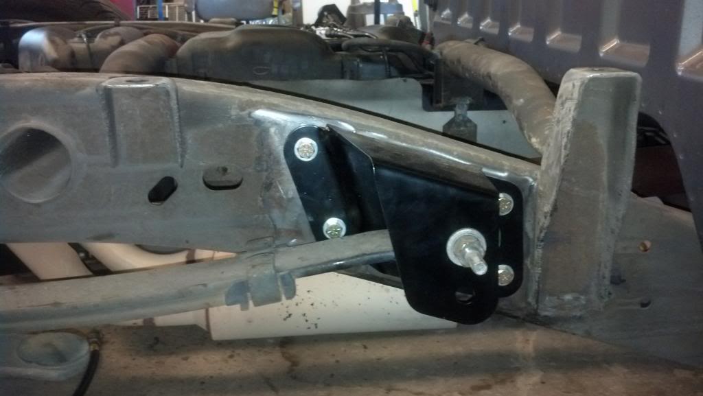

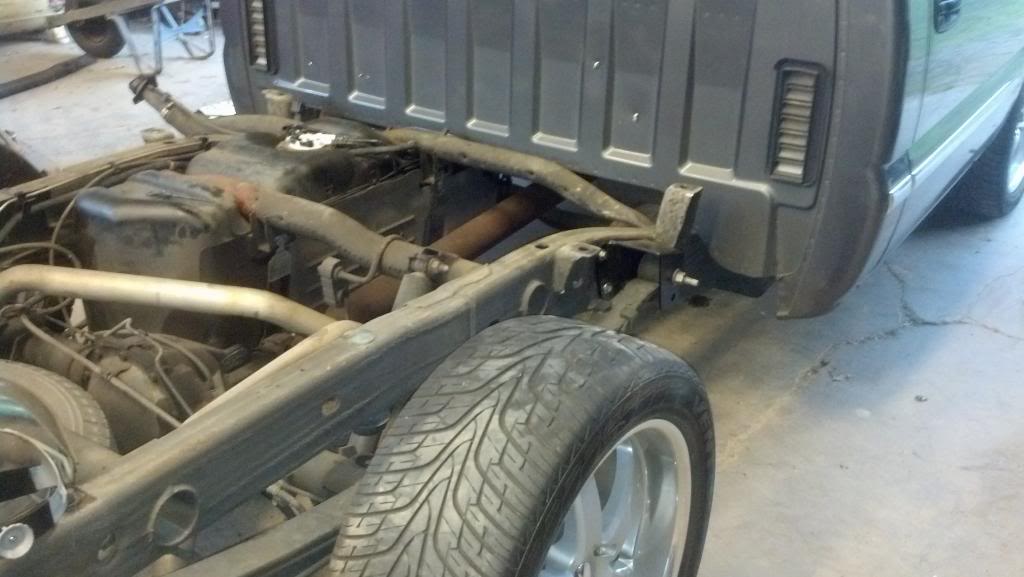

+1 on bed off, and I used a torch as well. I also cut off the lower mounting points for the stock hangers just to clean the install up.
and with the bed off, it only takes about 10 minutes to drop the tank =)
