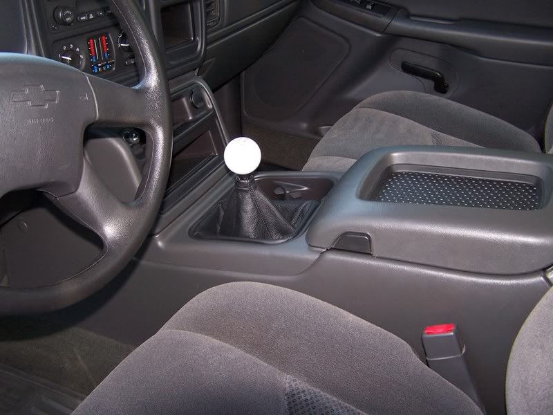

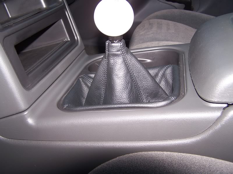

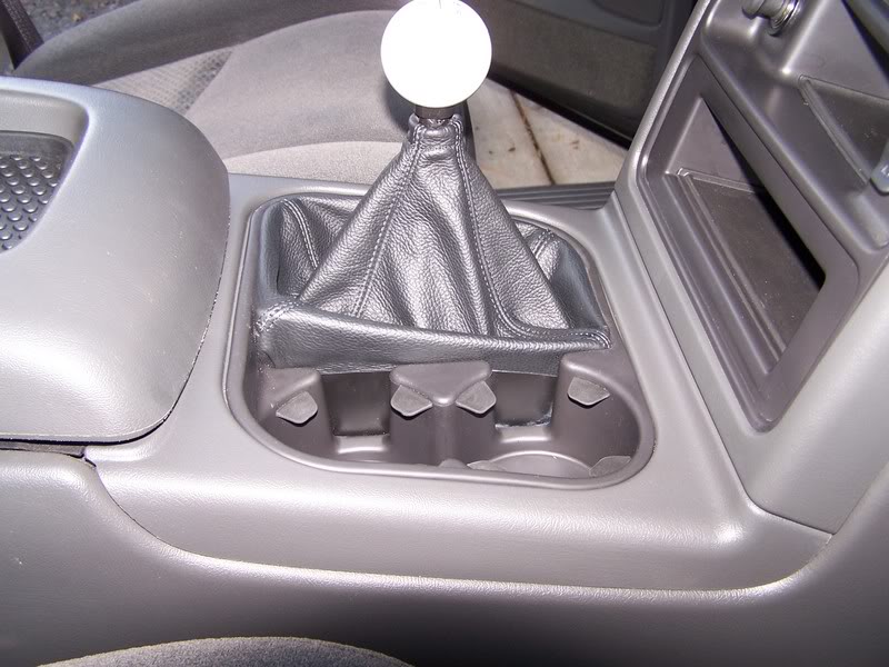

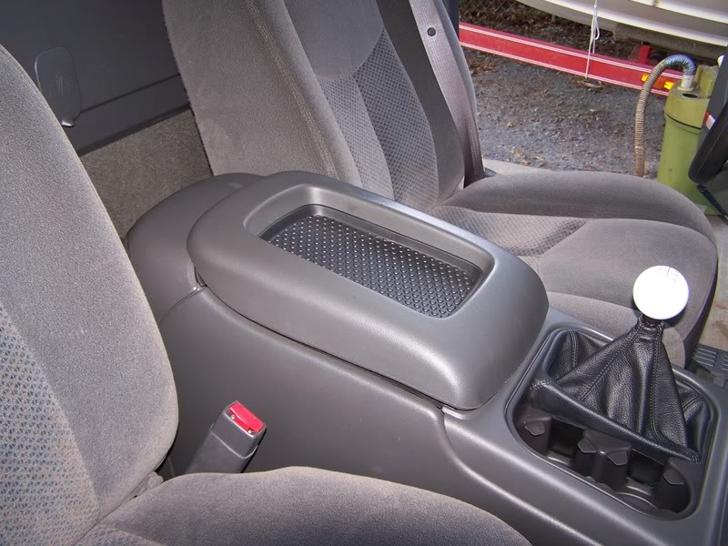

I finally finished my shifter boot!
Ended up with plan 1 since it was more simple and I finally figured out how I was going to do it.
I used steel banding like used in shipping on palets.
-I bent the banding to the shape of the inside of the cup holder compartment.
-Using clamps held it in place as I worked it.
-I began drilling 1/8" holes and installing 1/8" sheet metal screws one at a time.
-After I get all the screws in I take it back apart and install the boot with the screws.
-Once all the srews are in I removed them one at a time and put in rivets since the screw head would be too thick and in the way for the cupholder assembly to snap back in.

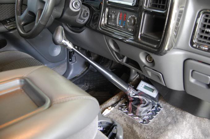

That looks great dude! If I had a console I would have done something like that but, since I don't and I used a truck transmission I went for the full on Truck style Shifter... It looks big and akward but, it actualy drives really great!!!
The whole shifter set up cost about $160...

I like yours. Good way to do the truck shifter location. The T56 is 8-12" further back. It comes up about where your cupholders are. I used to have the same center seat as you have. I was wanting to keep mine but the seat was just going to be in the way with a long shifter. Mine is a RCSB and Reg cabs don't come with the console like I have, only EC's and Tahoes.
