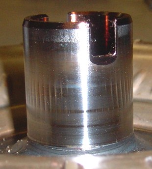

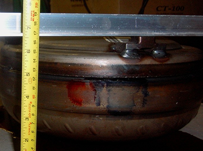

Doesn't the wear pattern look similar on your unshimmed PI TC and my stock TC? It does to me.The height of my stock TC is 6 5/8" as measured in the pic.
Yes it does. As does the wear pattern on my unshimmed PI to stock TC. The mark goes down about 9mm from end of snout on both. This is picture of the snout pump mark of my oem verter.
