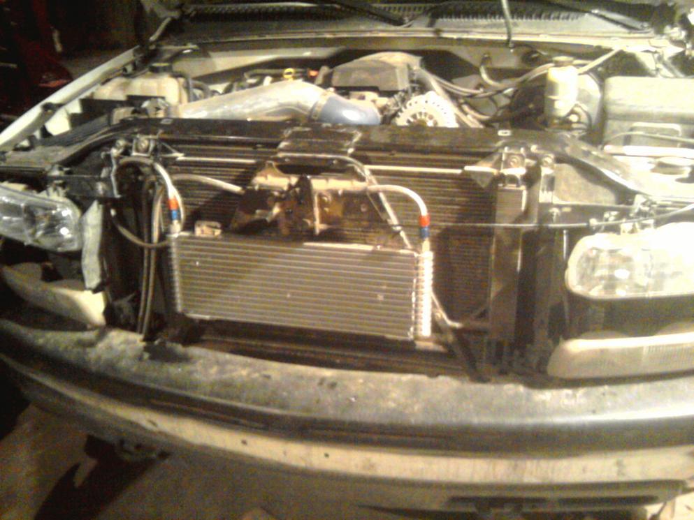

Here's how the coolers mounted.

Old 01-16-2012, 01:04 PM
  #37
11 Second Hall Moniter
AKlowriderZ71's Avatar
Join Date: May 2008
Location: Wyoming
Posts: 11,651
Received 8 Likes on 8 Posts
Do the trans temps come down when you're driving on the highway(55+ mph)?
Old 01-16-2012, 01:06 PM
  #38
Frostflowz's Avatar
Join Date: Dec 2011
Posts: 37
Received 0 Likes on 0 Posts
check for any crimps in the line, a slight clogged line will make temps jump very quickly.
Old 01-16-2012, 01:57 PM
  #39
david0982's Avatar
Join Date: Apr 2010
Location: Scott City, KS
Posts: 160
Haven't really driven it very far because of this problem but it seems like the temps just keep increasing as I keep driving. But I have not driven it for longer then 30 minutes since the swap so IDK how high the temps would get if i drove it longer. The highest its went is around 200 and that was after a 30 minute drive taking it very easy. I checked both lines to c if they were flowing properly and they seem to be fine.
