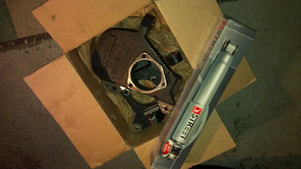

Little update got everthing installed. Rides like a dream now compared to before. Only problem im having now is my dust covers are hitting the rotors. i have to get it aligned to see if my turning radius is better. Name:  2012-11-14_16-32-30_228.jpg
Good to hear you are happy with it. Post up some pics man.
