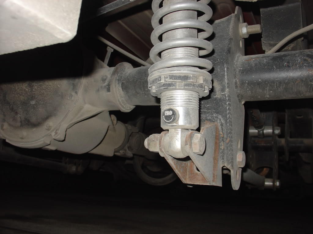

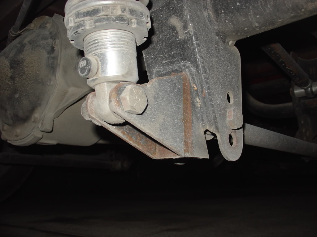

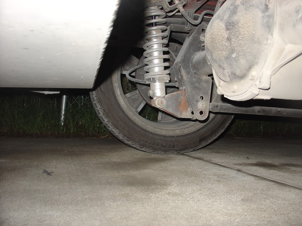

here ya go :

Thanks for the pics! pretty sweet setup you have going there!

thanks corey, it'll give ya an idea how you would have to also notch them so they'll sit right in the bracket !!
