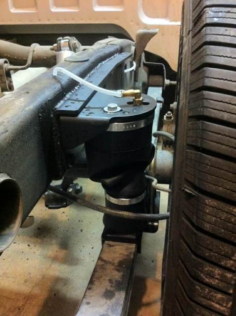

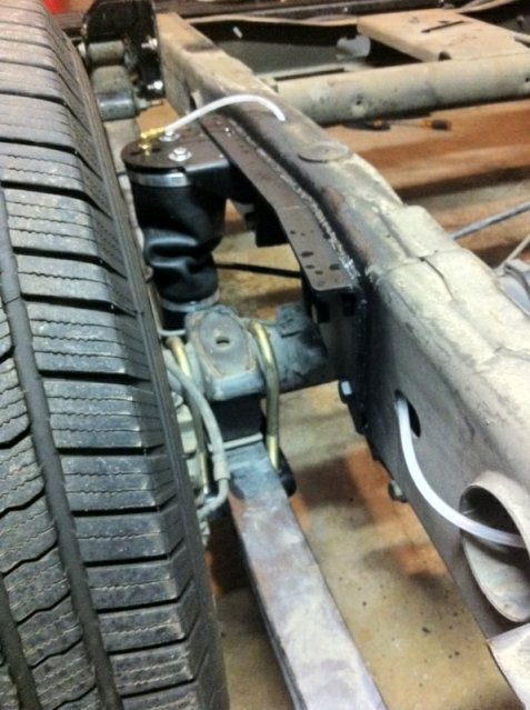

that link looks legit, but I didn't have mine as far forward as they do theirs. Not saying mine is right and that they have it wrong.
