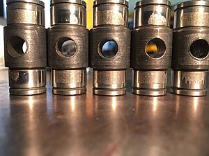

There is a long thread over at tech showing all the bearing type trunion upgrade kits wear into one side of the pivot. This is why I went with the solid bronze trunions.
