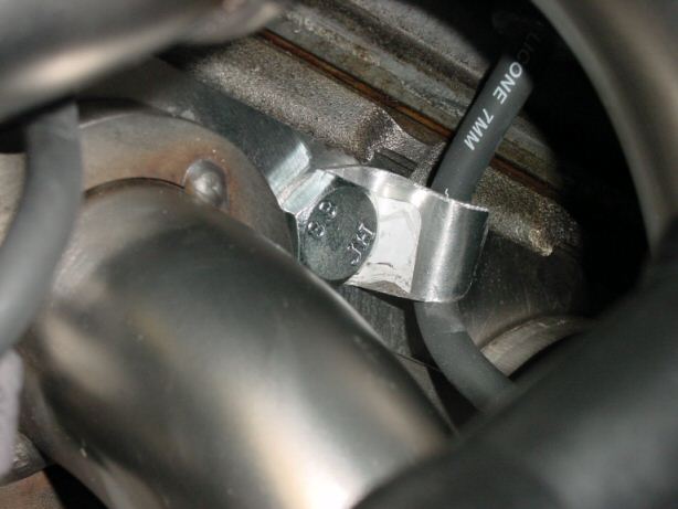

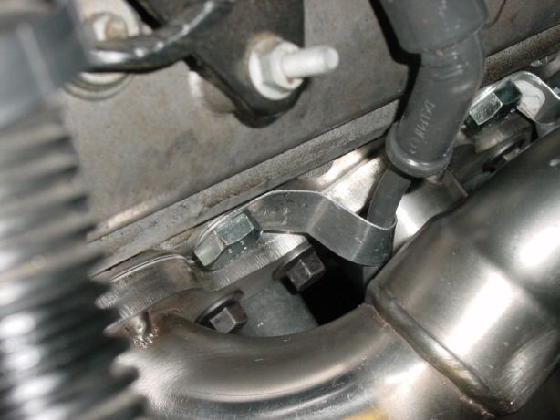

I feel your pain. I had MSD 8.5mm on the truck until I installed the SuperMaxx. The MSD boots were too long and laid upon each primary. Not to mention that the wires themselves were already more than an inch longer than the stock wires. So I bought a new stock set of wires. #5 and #7 still had some interference problems (the installation instructions actually note this). So I found some bolts and fabricated some brackets to hold them off the pipes.
Attached Thumbnails High perf wires with headers???-bracket_wire-5.jpg   High perf wires with headers???-bracket_wire-7.jpg

The stock wires work with the headers. It's just the way the #3 primary is 'sculptured'. It does a loop up and around the #5 (see attached picture), thus causing the interference.
Dynatech is aware of this interference that it causes with the #5 adn #7 wires! What burns my butt is that they are aware, and for the price you pay for the SuperMaxx, you would think these would be pieces they would supply.
The brackets were nothing more than aluminum sheet that I bent to shape. Thank goodness for those accessory holes for the bolts.
