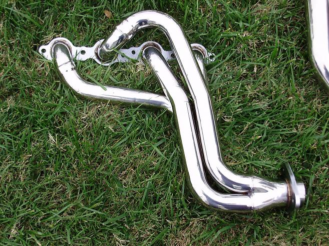

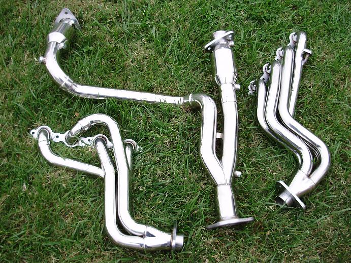

Got the headers today. Thank GOD the headers and pipes didn't look anything like the box did, lol.
I do already see an issue that'll need to be dealt with...the driver's side header has one primary tube that comes up higher than the rest (see pic), and it looks like I'll surely have a plug wire to header clearance issue there. I have everything loaded up so I can do the swap tomorrow at work. I'll try to get progress pics, but if not, I'll at least get pics of anywhere there is a clearance issue, or anything like that.
I will also put any info, pics, opinions, etc. in my own thread sometime tomorrow...
I will say that out of the box they "look" great. All welds look real nice. Header flanges are 3/8" thick, which is nice. I did notice that the Y pipe thickness is a bit on the thin side. Hopefully, that doesn't bite me in the *** sometime later down the road...

that primary is normal...they copied the old dynatech style...OBX actually has headers out now that look like the new dynatechs...

What is everyone doing for spark plug wire clearance on that cylinder?
Any idea?

Most are using a protector sleeve/boot thingy
Crap. I better grab a handful of old plug wires for the drive home, lol...
Originally Posted by BarryW.
Are those 1 5/8 primary tubes?
No sir.
They are 1.75" primary tubes with 2.5" collectors. The Y pipe also has 2.5" pipe back to the merge, which is just in front of the catback flange. After that merge point, it's 3".
