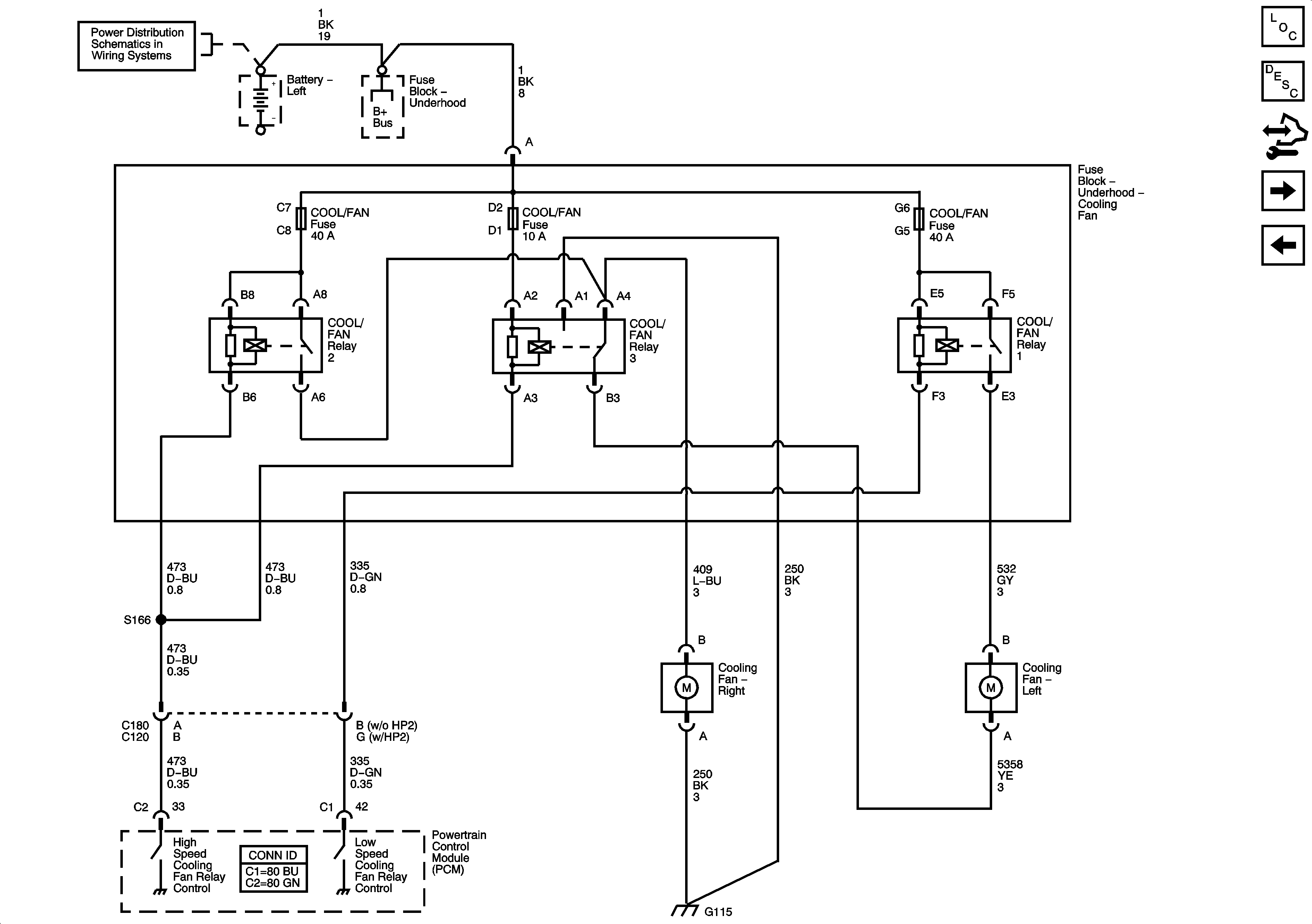

Anyone know the polarity of the fan electrical connectors? Which one is positive, negative?

The connectors have two pins: A and B
A is Ground
According to the schematic
https://www.performancetrucks.net/fo...ne-05efans-gif

I think the driver side of each fan is Positive..
