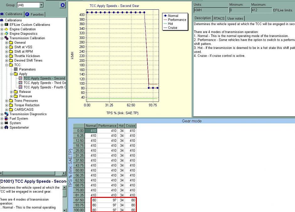

Originally Posted by AKlowriderZ71
Yes, that's what a damaged converter clutch looks like from the outside. I locked mine at WOT, since others claim higher mph. Well, after 5 or 6 pulls, I smoked the 3-4 clutches. This is what I saw when I pulled the transmission.
Looks familiar. Could be related to this stock 80E tune table which I found after the fact- had to scroll down to the bottom to see it on my notebook. Wasn't paying attention to the graph up top, which is also pretty small on the notebook. Initially flipped through the tables when I did the segment swap and saw no TCC lockup in 2nd and said I'm good to go - NOT!
In Tootall's pic it looks like the area may have been painted over. Mine looked like Roger's, just a little more fried. Can't see the hub, but if it is for an 80E there will be 2 flats instead of 2 notches on the hub. The long snout/3 lug could be an 80E converter built to bolt up to a 60E flexplate.
