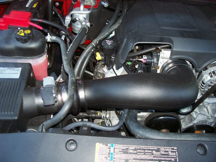

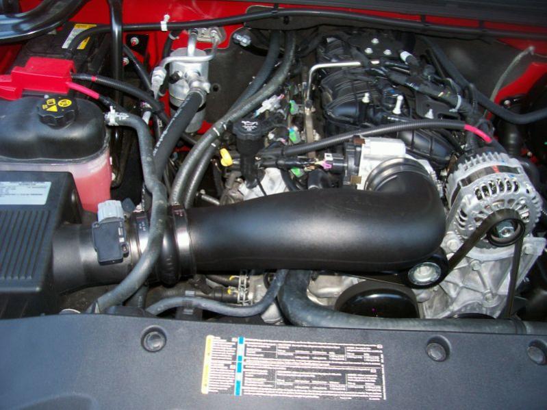

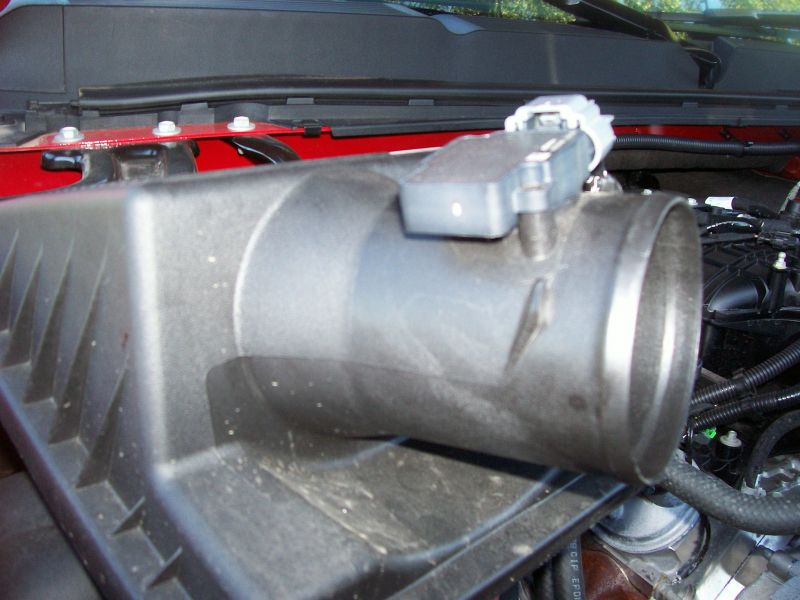

Got it on today.
At gnasty's request, heres some pics.

It took 20-25 minutes, I could do another one in 10 minutes. A couple of tips for the next guy.
The instructions say to disconnect the breather tube from the valve cover. They don't tell you that there is a plastic clip that has to be released with a small screwdriver.
When the instructions say disconnect the radiator hose from the clip, don't. Just push the clip down out of the factory intake.
It's almost too short for for an '11. I don't know if the '07-'08' MAFs take a little more space than the later models with the molded in MAF or if they expect you to buy a (useless) TB spacer but it's a pain to get both ends completely seated. It is possible, it just take a bit of working around to get both the MAF end and the TB end all the way down and clamped. An extra pair of hands would have helped.
Oh, one more thing, take your time when screwing the vent hose adapter into the MIT. The threads in the MIT are cast into it and not cleaned. It'll go but be careful with it. You would think that they would spend 15 seconds hand screwing a tap into it to clean uo the threads but they don't.

Looks great. Thanks for the pictures. Hopefully I can get one soon.
