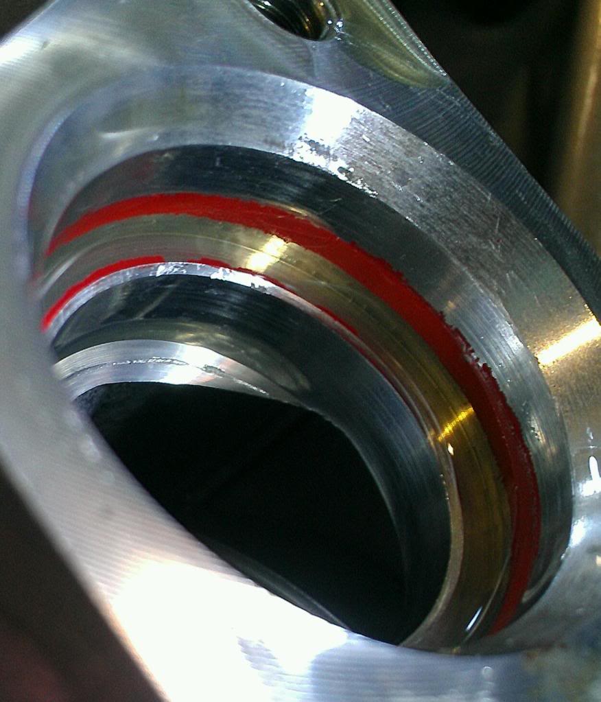

Just to update everyone, the O ring was fine. When I put it in, the engine was upside down on an engine stand so I was pretty certain that it seated in OK. There was debris on the pump and tube from the old O ring. I am not sure if that contributed to the problem, but I cleaned the snot out of it anyways. While the pump was off I ported it, and installed a shim under the spring. When I had my machine work done the shop ordered my bearings for me. They weren't tri metal ones, and I installed them anyways just because there was so much success with stock bearings. Well after Richard chewed his up the other day I decided to get tri metal King bearings. I will plastigauge them when I install them. Hopefully everything together will boost up my idle pressure to around 40 PSI.

Here is what the debris from the old O ring looks like for those who haven't seen it. I used brake cleaner, and had to scrub it pretty good for it to come off.
