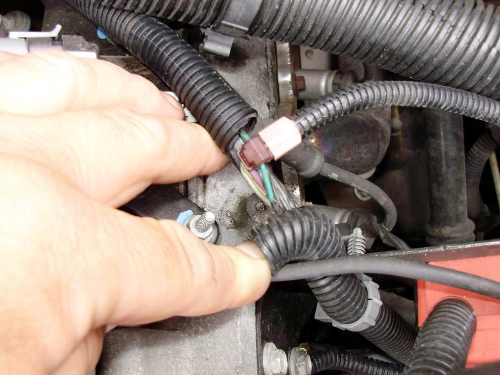

Originally Posted by nickleahy23
i cant really see the wires going into the ac...does anyone know forsure which wire they tapped into?
Wire is at front of driver's side head...Mine was solid green, but some have a stripe.

ill try that one..i have a dark green, light green, and green with a stripe all right there lol..
