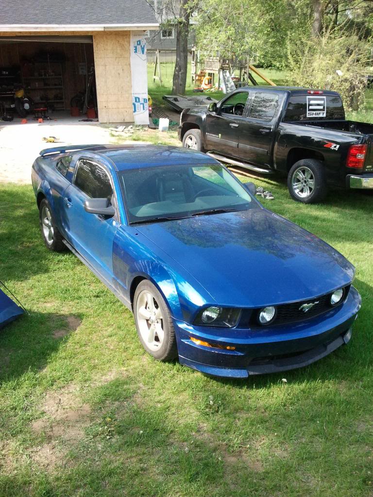

Never mind the work in progess gt, have since upgraded to a Shelby GT500
