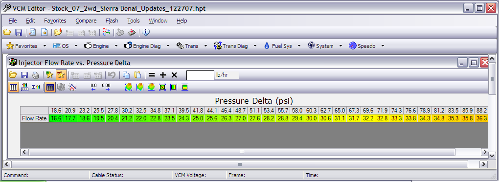

From: League City, TX
5.3 flex fuel

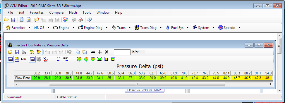

6.2

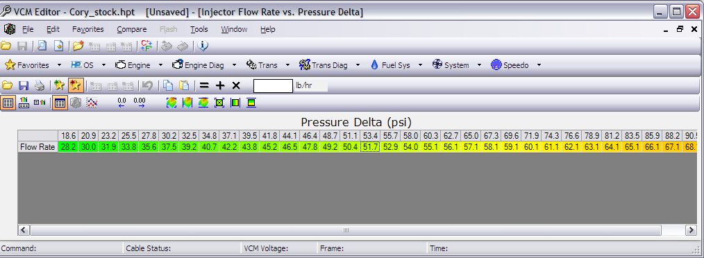

6.2 flex fuel
