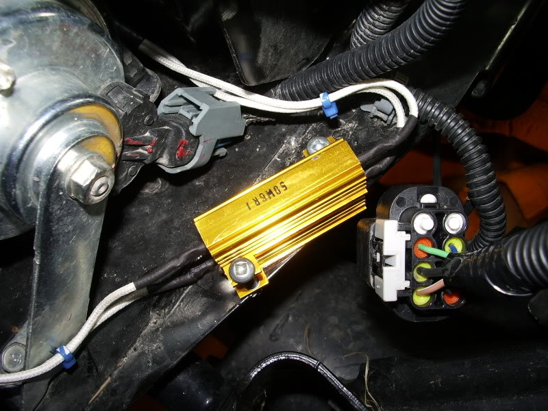

Hey guys i installed my led switchbacks on the weekend, finally have a bit of time to post some pics. Most of the time spent was taking the actual headlights out, and figuring which wires to splice between. All is well now

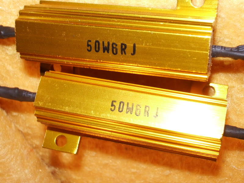

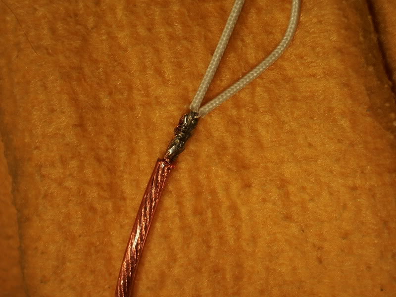

the resistors: 50w 6ohm
soldering some longer wire to both resistors

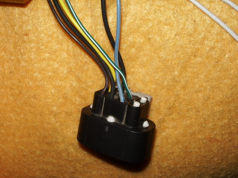

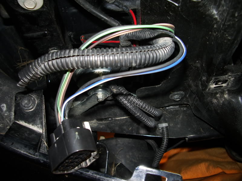

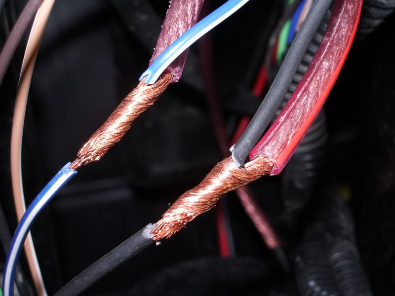

drivers side plug (black, and light blue is what we wire between)

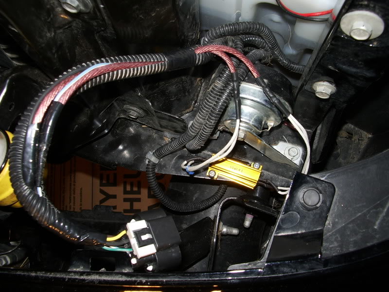

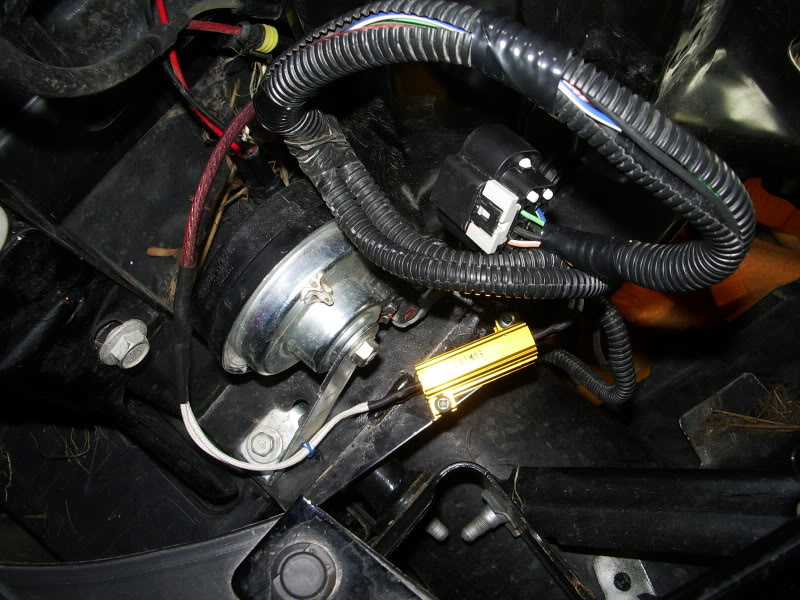

drivers side installed

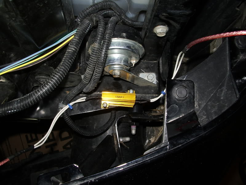

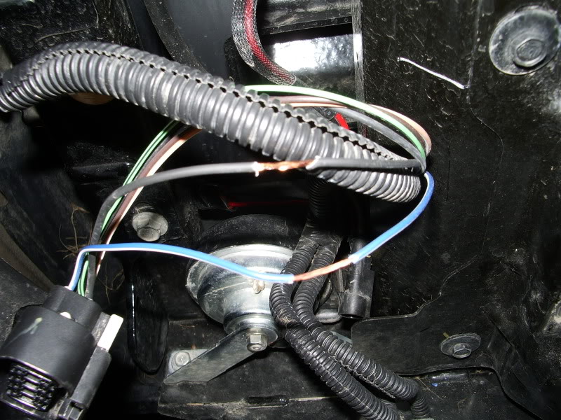

passenger side (black, and darker blue)

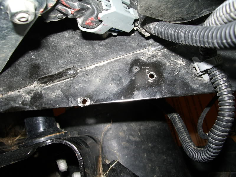

pre-drilled holes

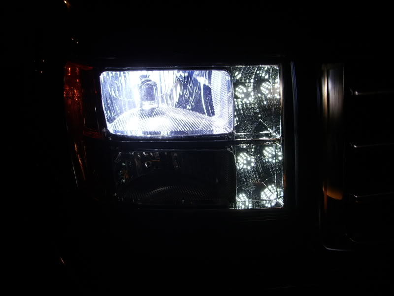

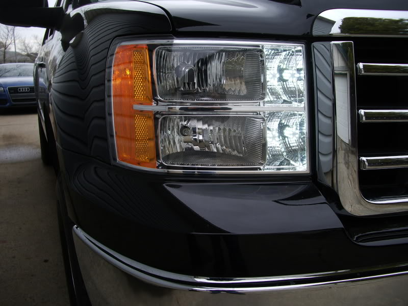

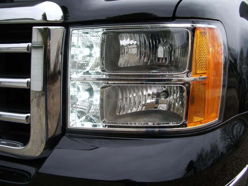

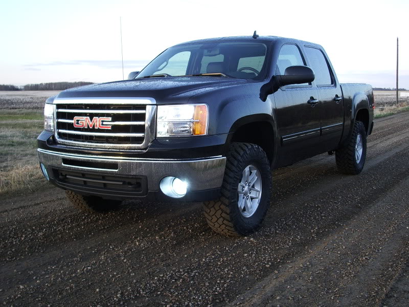

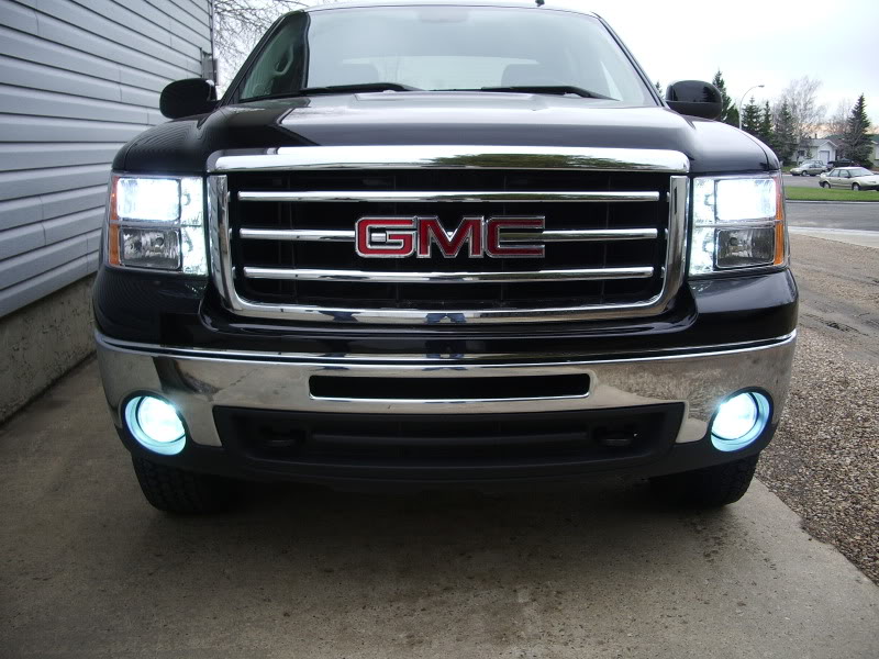

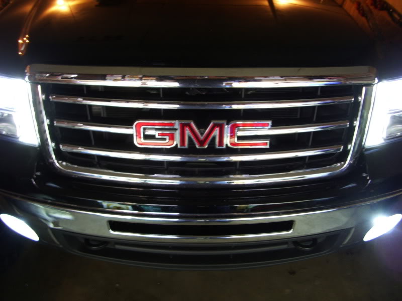

Finally, here's what they look like
got my nitto trail grapplers on too

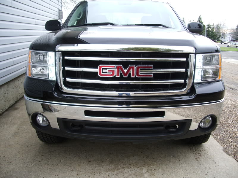

forgot, a quick side by side with the orange

got em off ebay, cheap. $30 for 8 of them, got extras in case
2 3157 60 SMD LED Switchback Turn Signal Lights Amber White 12V | eBay
Originally Posted by A Low Dime
I dont see an orange switch back in any pic.
The last picture looks like it may have a hint of orange, but its pretty much white to me.
ya for some reason the white stays on while you signal, and the orange leds flash
Originally Posted by Wyttrash96
Those are pretty cool! Do they help the headlights at all during night driving? My wife's Grand Prix needs help in the light department...
get some hids lol the leds don't do much at night
