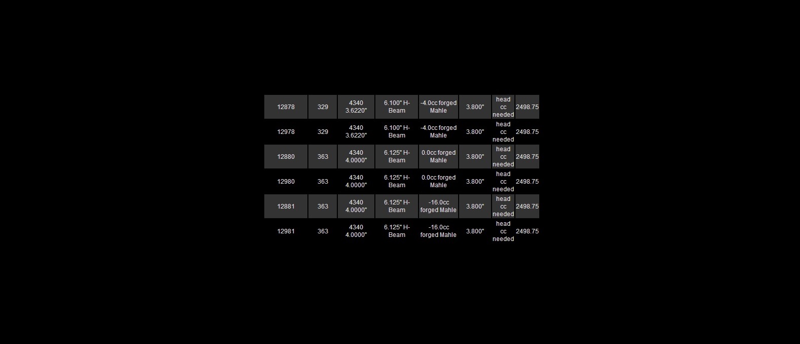

Eagle has a new stroker kit for the 4.8/5.3s. Nets you 363cid with a 3.800" bore,4.00"stroke and a 6.125" rod. Pretty interesting I thought. Wonder how that would do with a 2.3 whipple........

The link doesn't directly show it. I had to search, so I screen shot and clipped it.
IMO, I think most people that will spend that kind of money are gonna do so with a larger block.
