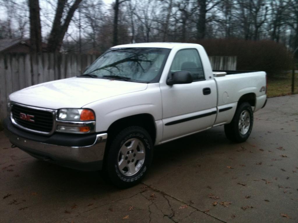

Getting ready to start my build on my 2000 GMC Sierra SBSC 4WD.
The build is ideally going to be turbo'd, stock internals, cammed, 4L80E swap, Ford 9". Power goal is between 700-800whp.
My concern is the front differential. Being that it is a 4WD I would like to lauch in 4-high whether I'm at street or strip. I know the factory 10 bolt rears are junk, I've already broke one of those on STOCK power , I just didn't know if the front diff's shared the same lack of quality?
Will the front diff handle 800whp?
If not, Can I do a 3/4ton front diff swap?
or should I do a straight front axel swap and get rid of the Independent all together?
Anyone know of anybody on the forums running a boosted 4WD 1/2 ton making close to 700whp that might be able to give me a little insight?
Any insight/help you can give I greatly appreciate!
Thanks
Here's a couple pics of it now.
Will post more build pics later
