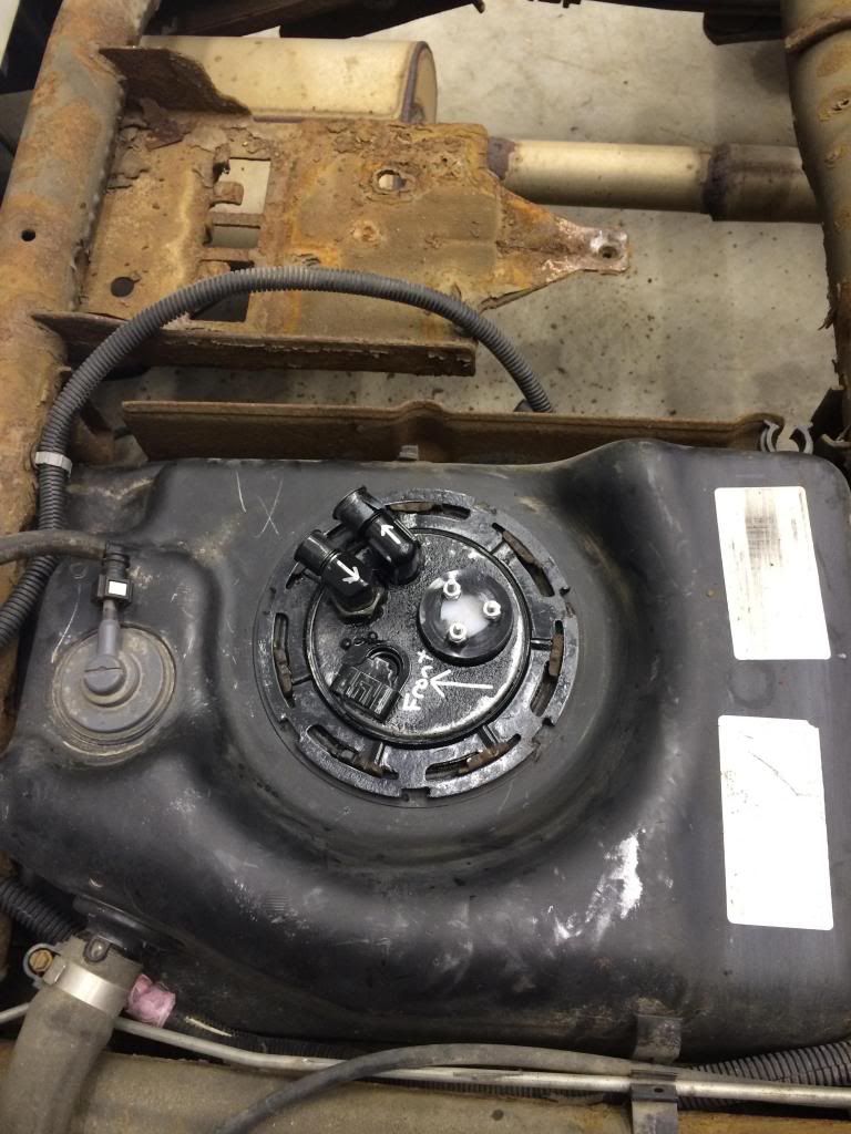

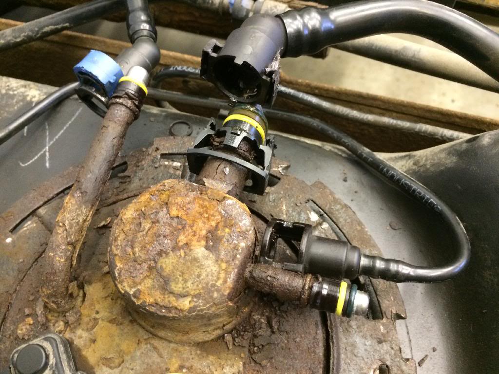

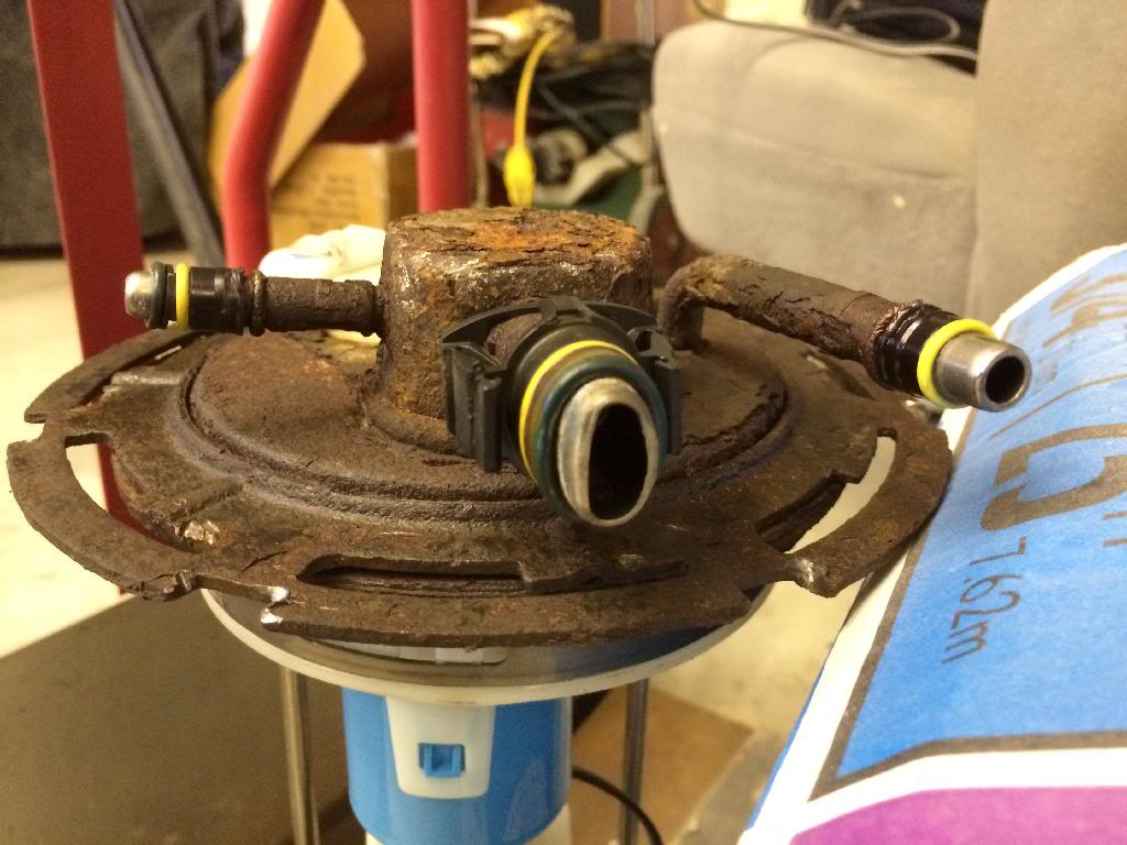

I am starting to wonder why I am modding a Minnesota truck. Rust has fought me with almost every part of this so far. Now it's the fuel pump assembly, it's basically rusted out. Lines were stuck on tonight. Yes, plastic was stuck to the steel. It's looking like I may need to get a couple new lines now and assembly. I don't really feel comfortable reusing this thing.

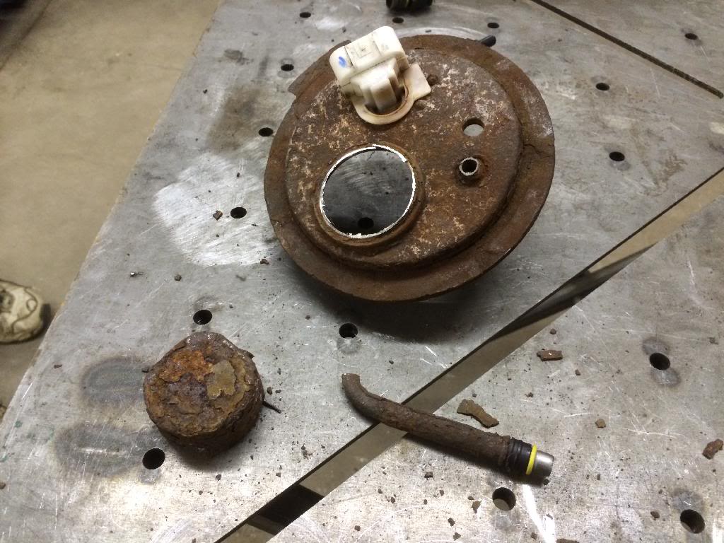

I am pretty sure these lines should have came off in one piece, not leaving the sleeves and O-rings like they did. Also, notice the oval large port that goes to the canister. That happened from the pliers trying to yank the line off.
![Name: EBB3B765-AA9C-4D7E-AB73-C98E633F1EA7.jpg
Size: 123.9 KB](https://www.performancetrucks.net/forums/attachments/projects-gallery-189/103822d1501263988-%7Bproject%7D-white-noise-2005-ecsb-2wd-silverado-forged-402-4l80e-pte-88mm-turbo-ebb3b765-aa9c-4d7e-ab73-c98e633f1ea7.jpg)
Powercruise is crazy, best to get in before they start restricting it more. I've been the last 2 years. First with the stock 4.8 and last year with NA 402. Sad thing is (maybe it was my tuning), a lowered 4wd 5.3 reg cab was dead even with me all down the straight last year.
![Name: B6666C8C-B221-433B-89BF-70644C1C6F25.jpg
Size: 97.1 KB](https://www.performancetrucks.net/forums/attachments/projects-gallery-189/103823d1501263988-%7Bproject%7D-white-noise-2005-ecsb-2wd-silverado-forged-402-4l80e-pte-88mm-turbo-b6666c8c-b221-433b-89bf-70644c1c6f25.jpg)

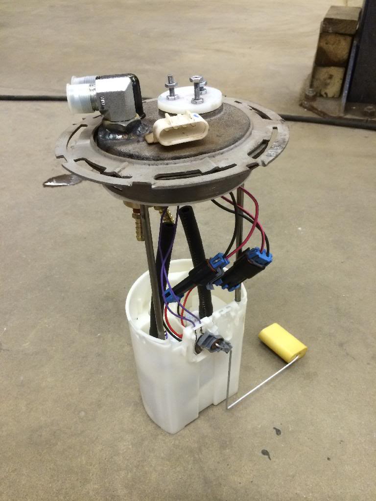

UPDATE

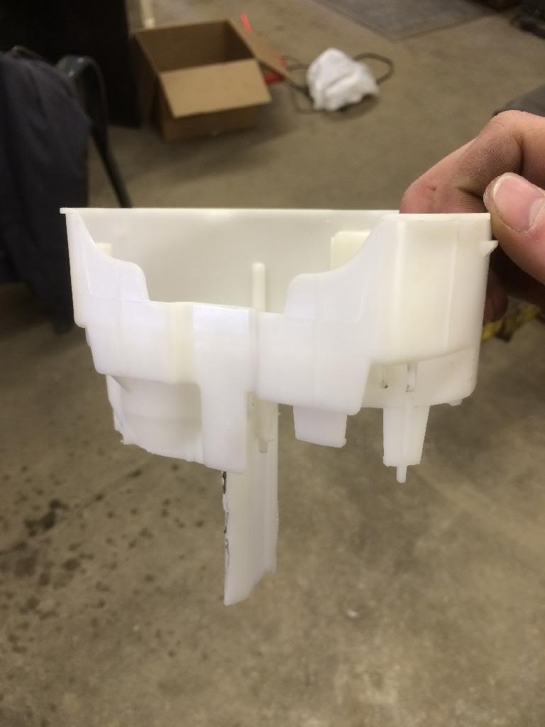

I got something figured out with my machinist friend. He's really smart, all his idea. Instead of buying a brand new ebay pump to mod, we used the original and cut everything off of it. To start fresh.

There was a cylinder shaped piece hanging from here and we cut 3/4 of it off and left a finger for mounting the pumps to.

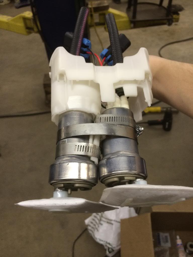

Pumps mounted and clamped.

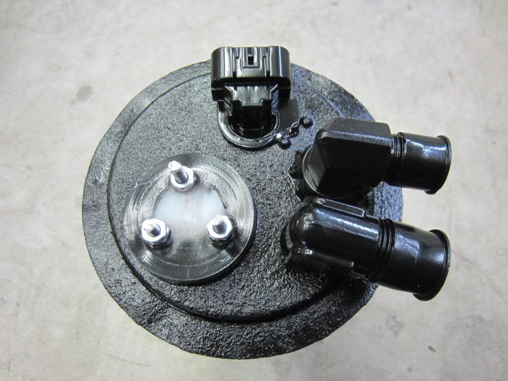

Detail on the top of the pump. Mike (machinist) made two plastic discs on a lathe that use a factory O-ring and sandwich into the pump using 3 threaded rods. This also doubles as the electrical pass through to the pumps inside. The two smaller holes were then drilled to accept -10 and -8 an bulkhead fittings. EVAP is deleted, still has the same stock level sender plug.

Inside of the hat, you can see how it all works. The feed bulkhead was threaded on the inside to accept 3/8npt which is how the splitter plumbs in from the rubber line.

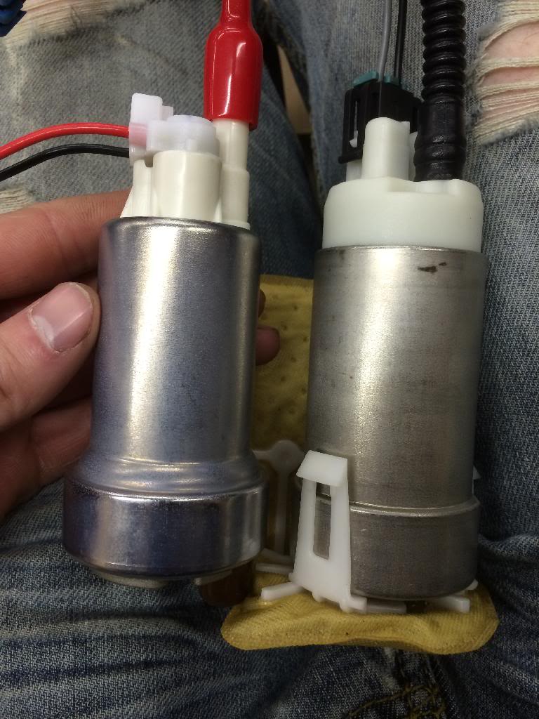

Walbro 450 on left and stock pump on right.
![Name: 48594802-3037-4020-AB81-03C15C32B459.jpg
Size: 113.0 KB](https://www.performancetrucks.net/forums/attachments/projects-gallery-189/103561d1501263517-%7Bproject%7D-white-noise-2005-ecsb-2wd-silverado-forged-402-4l80e-pte-88mm-turbo-48594802-3037-4020-ab81-03c15c32b459.jpg)

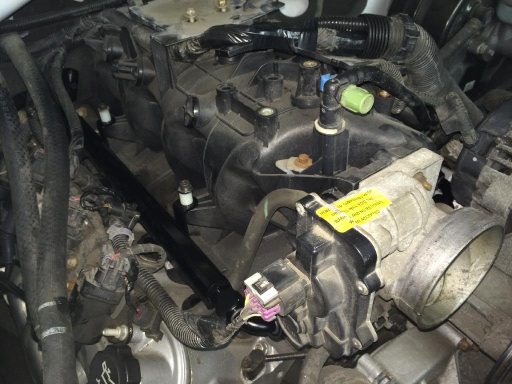

Test fitted the aftermarket ebay rails.

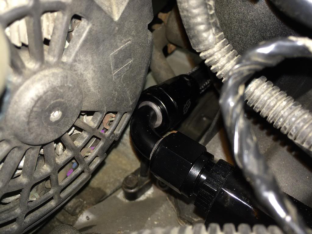

Very close on the alternator! There's about 1/8" at a different viewing angle.

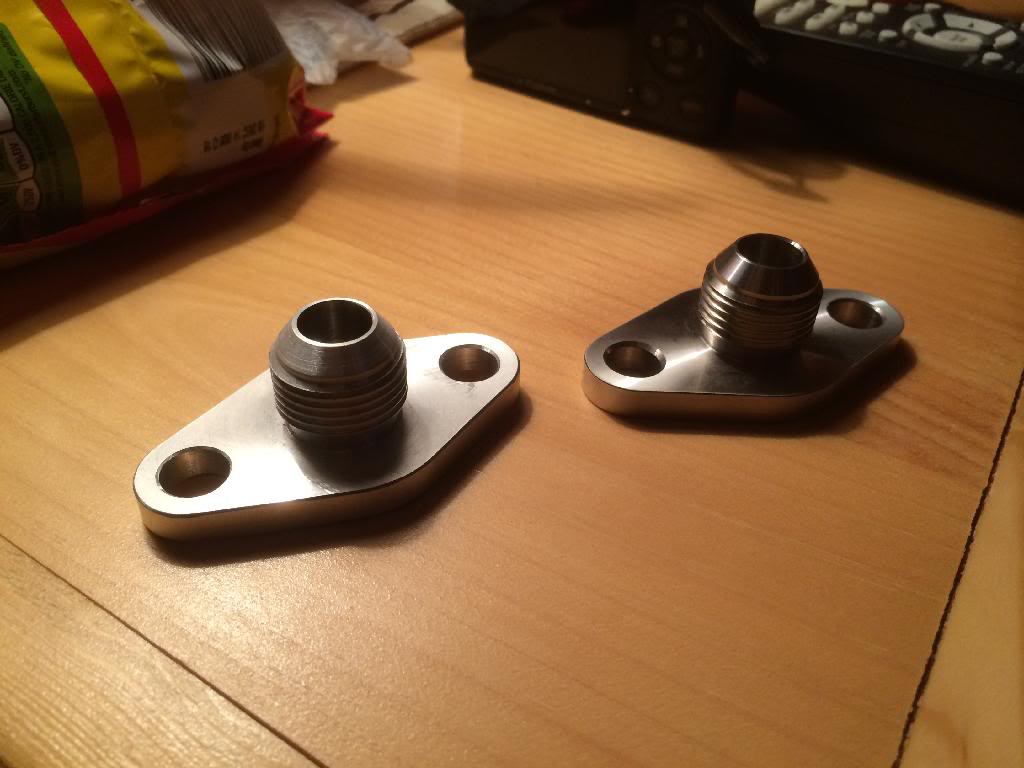

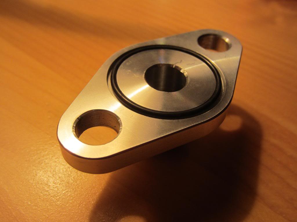

Mike also made these custom drain flanges for the PT88 turbo since the hole on the center section is so big, a normal flange on ebay was too narrow. I have 3 aluminum and 6 stainless steel flanges that are for sale for anyone needing one with a PT88 also. -10AN
![Name: 555900F4-EFF3-42D5-9EDD-B0BEFE355420.jpg
Size: 67.7 KB](https://www.performancetrucks.net/forums/attachments/projects-gallery-189/103564d1501263517-%7Bproject%7D-white-noise-2005-ecsb-2wd-silverado-forged-402-4l80e-pte-88mm-turbo-555900f4-eff3-42d5-9edd-b0befe355420.jpg)
O-ring seal
![Name: IMG_1103.jpg
Size: 48.7 KB](https://www.performancetrucks.net/forums/attachments/projects-gallery-189/103565d1501263517-%7Bproject%7D-white-noise-2005-ecsb-2wd-silverado-forged-402-4l80e-pte-88mm-turbo-img_1103.jpg)

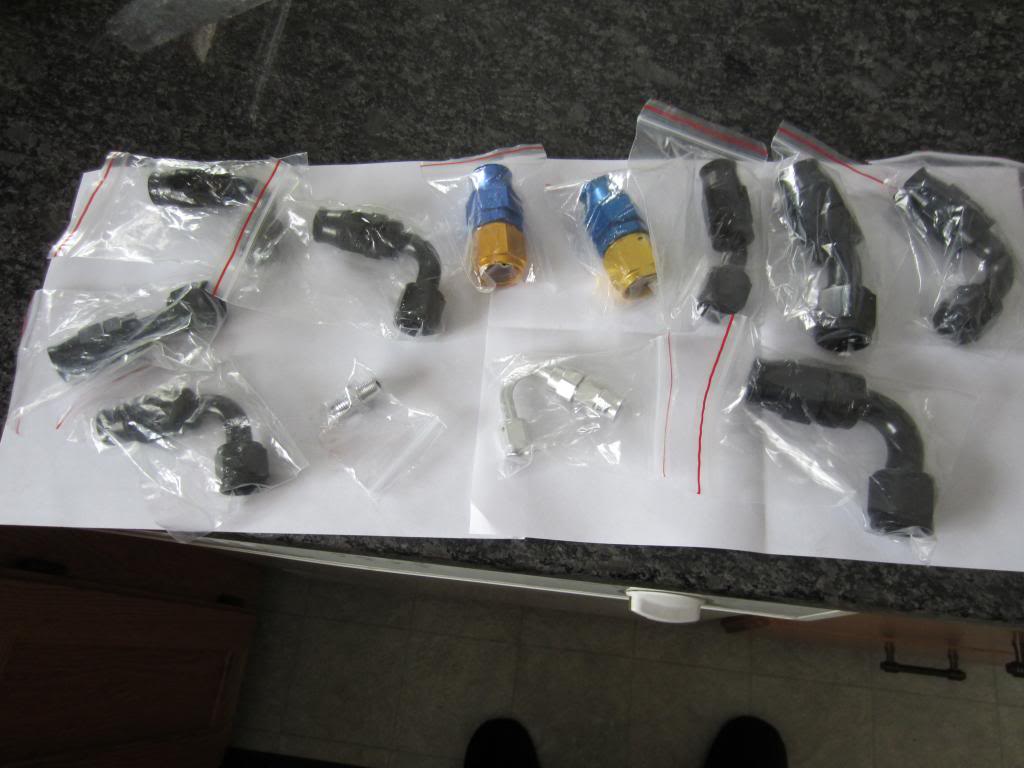

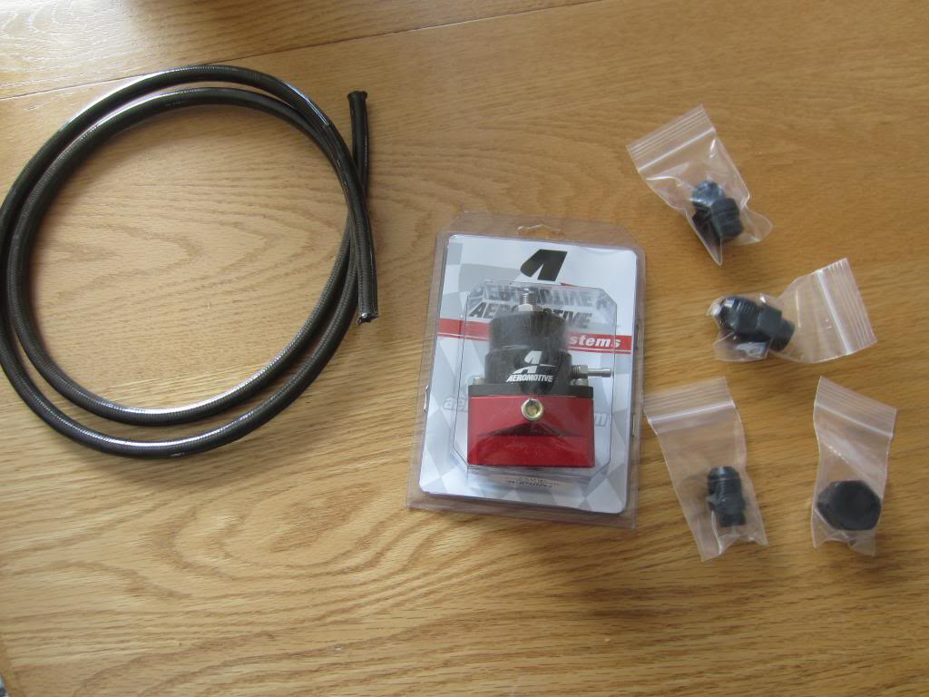

Got a bunch of the fittings to finish off the fuel system, only waiting on the -10an Russel filter at the moment.
![Name: IMG_1115.jpg
Size: 74.7 KB](https://www.performancetrucks.net/forums/attachments/projects-gallery-189/103567d1501263517-%7Bproject%7D-white-noise-2005-ecsb-2wd-silverado-forged-402-4l80e-pte-88mm-turbo-img_1115.jpg)
-4 turbo oil feed line, Aeromotive A1000 regulator and proper fittings.
