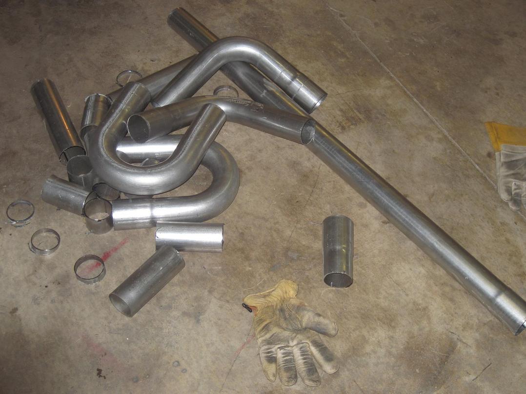

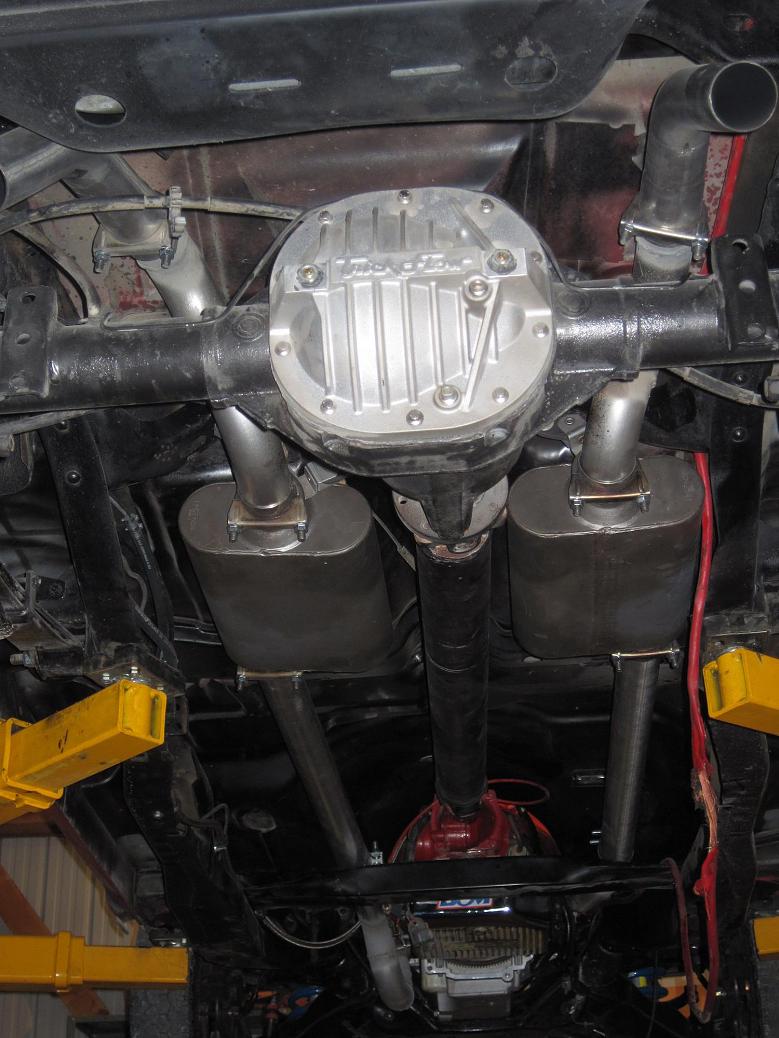

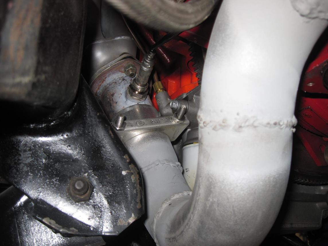

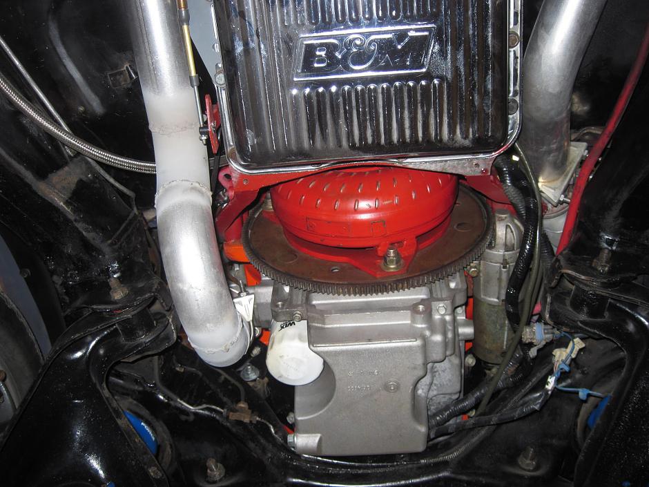

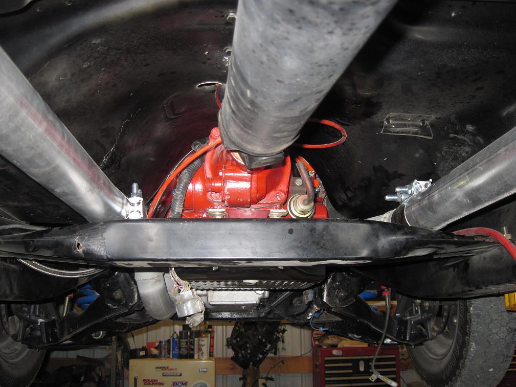

Exhaust finished
After all the muffler shops acted like there puss was hurting, I desided to build my own exhaust system.
Bought a 2 1/2" U-fit Jeg's kit and a Pair of S/S 40 Flowmasters. Even though my welds look like hell, I think it will do the job! Cleared the trans crossmember without cutting it up.
And after. Needs tune really bad!

Thanks man. That Blazer tank makes Tail pipes a little tough to route. Thats why mine dump after the axle.
I should be getting my new ecm w/tune back from PCMforless.com Monday or Tuesday. Said they can get my tune on spot, we will see if that is true. Anything would be better than what I have now. Way Rich! Idle sucks, and stumbles a little. Pulls hard as hell!
She is a blast to drive, With that new Tune Ruby will be one nasty Bitch!
