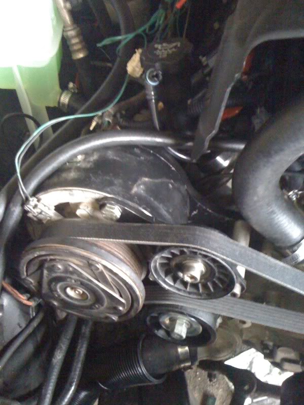

Hey man good build i wanna see some vids! where did u install your ac? i have a 95 with a turbo now an i have no room for a compressor! lol thanks man
passenger side just like the factory put it. you can do like the 99+ and put it on the lower side of the motor but you'd have to notch the frame and box it in.
ill get up some videos, but it's nothing special lol
