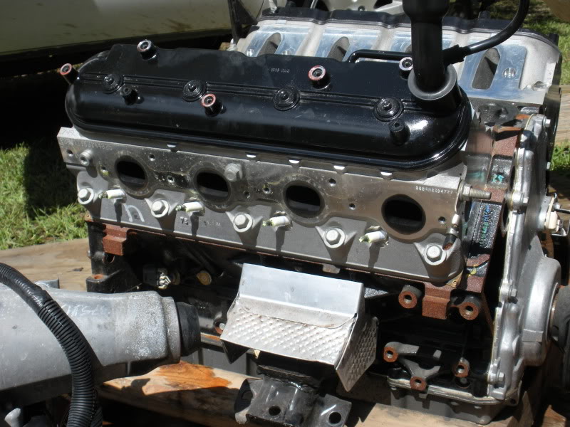

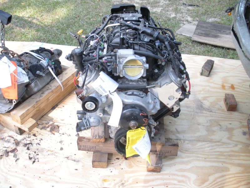

small update
enjoy.

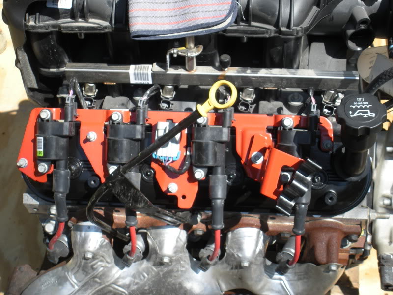

2008 5.3 1,000 miles

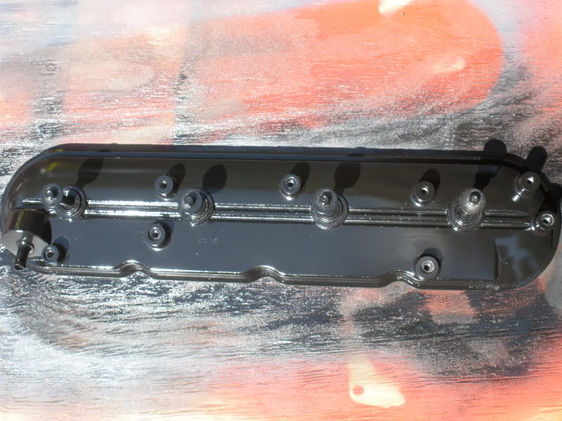

i don't know why it looks like the top of the valve cover has runs in it. it's in the cast i'd guess. oh well, you can't see it anyways.

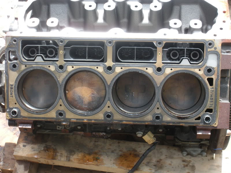

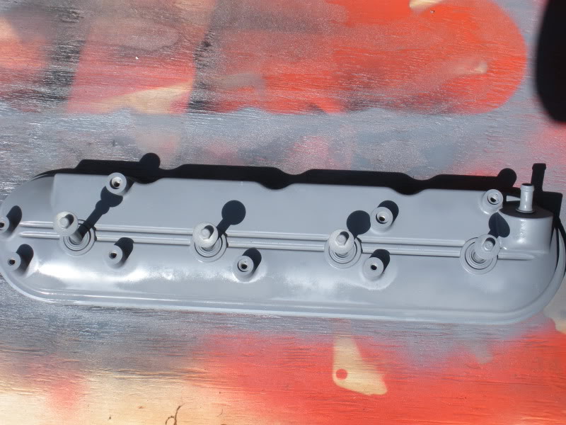

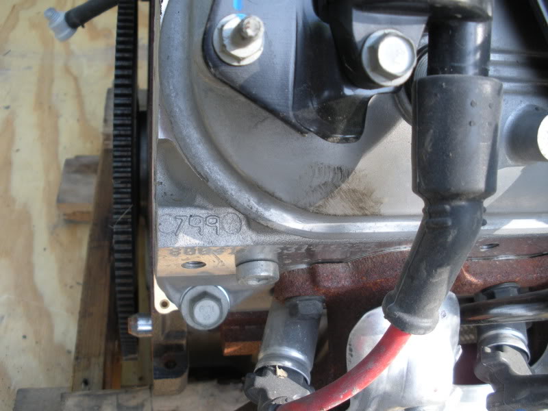

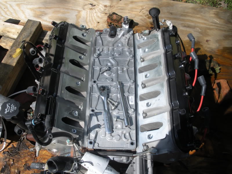

Old 09-27-2009, 01:31 PM
iamkeniff's Avatar
Join Date: Apr 2007
Location: Gonzales, la
Posts: 5,365
Received 3 Likes on 3 Posts

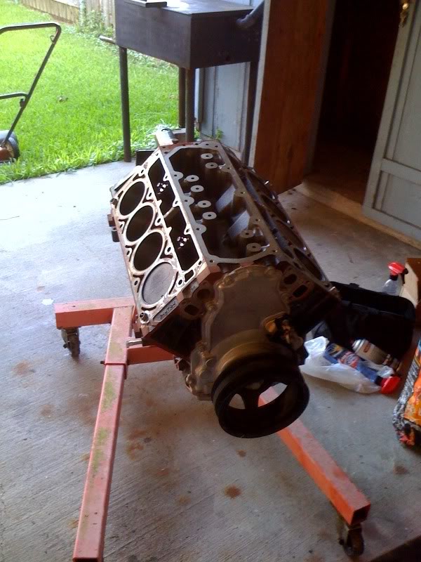

the block isnt that color, its the old head gasket still on there.
gotta love flat top pistons :twisted
:whistle: i dunno what that's all about :twisted
