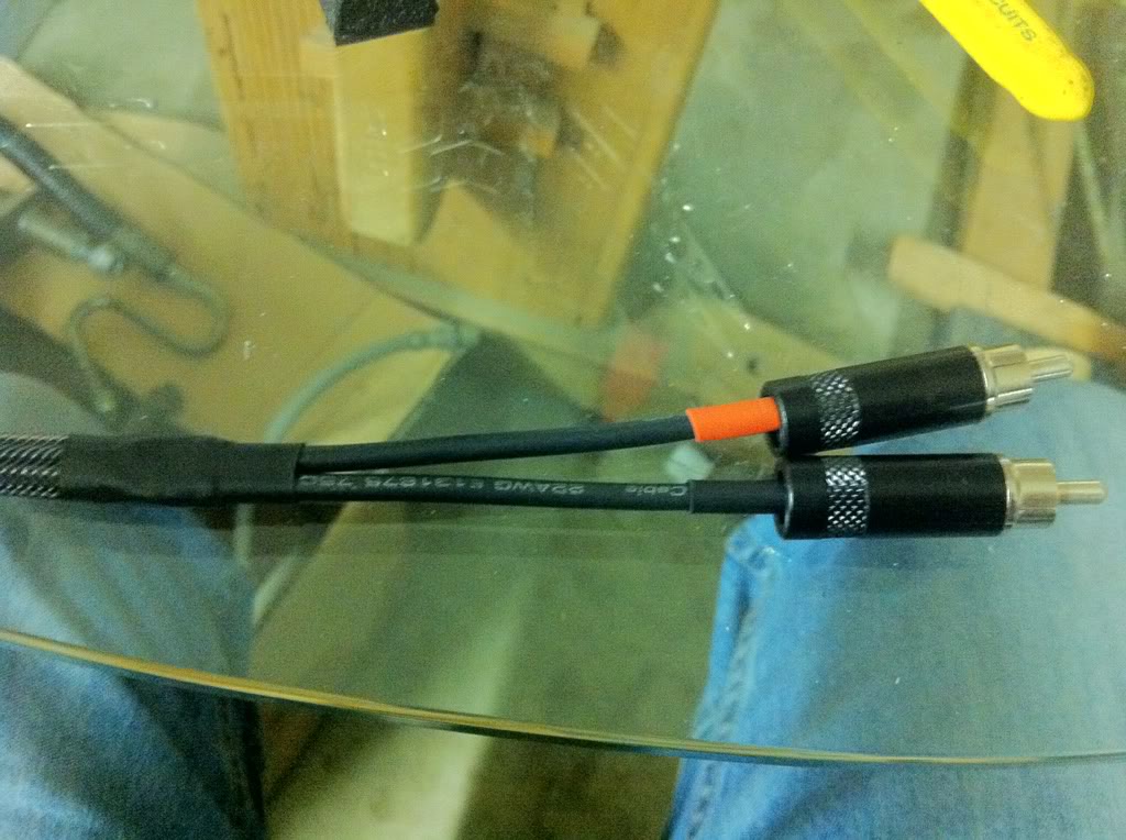

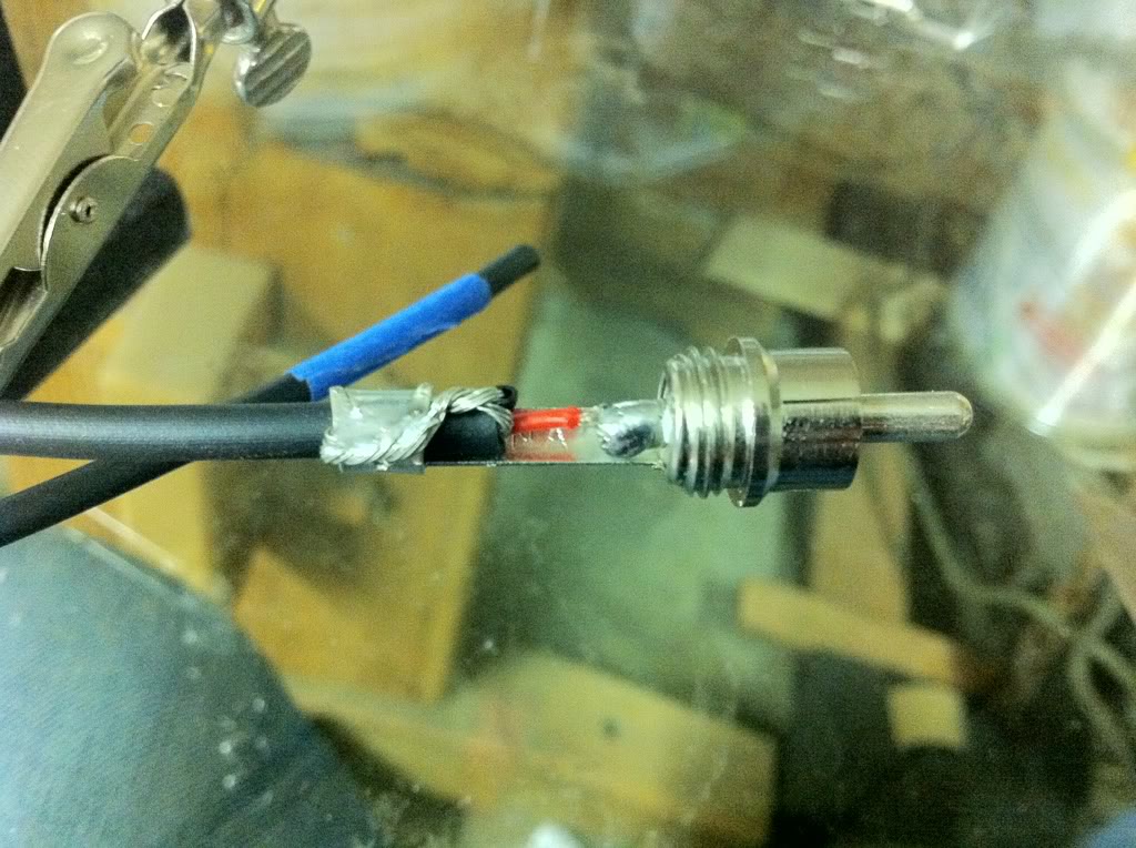

The first thing I did was run my wire from point a to point b to get the appropriate length.
Then I cut another wire the same length and put them both inside some techflex.

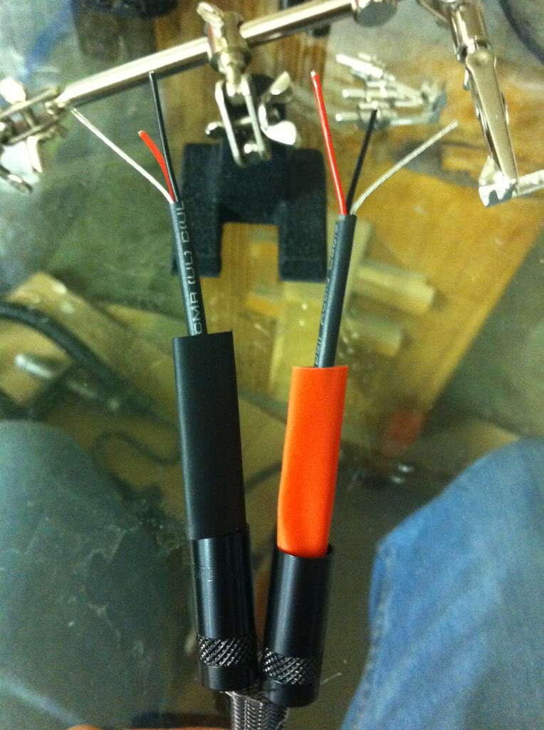

After that, I scored the wire and pulled the housing off exposing the red, black and drain wire.
I learned it was best to do it this way to ensure that the RCA ends are the same length. Otherwise, if they're different lengths, it'll end up pulling one connector out.
I stripped the black and red wires. The red wire gets soldered to the center, the black to the outside. My connectors didn't have holes in them for the black wire, so I folded the wire over and crimped it down. Then I added a bit of solder to hold it into place.
One thing I wanted to mention is to connect the drain wire to the ground with the black wire. I've read that you only do this on the signal source end. I don't think it matters what end you connect it to though as long as you don't connect the drain wire on both ends.
The reason for this is because if you were to connect the drain wire to both ends it would no longer act as a shield and instead be a conductor.
So since I didn't buy left and right connectors, I bought red and black shrink wrap instead.

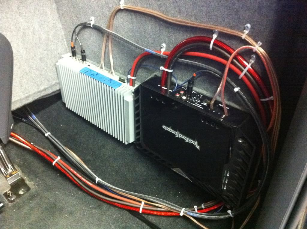

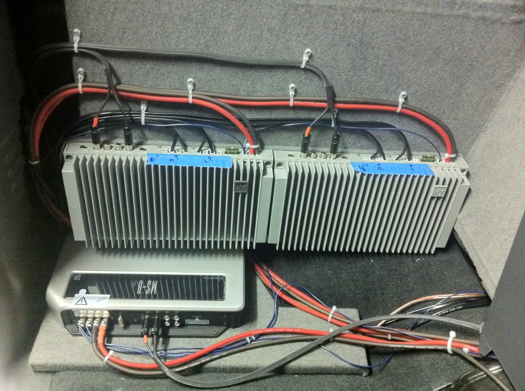

I cleaned up the drivers side amplifiers a bit.

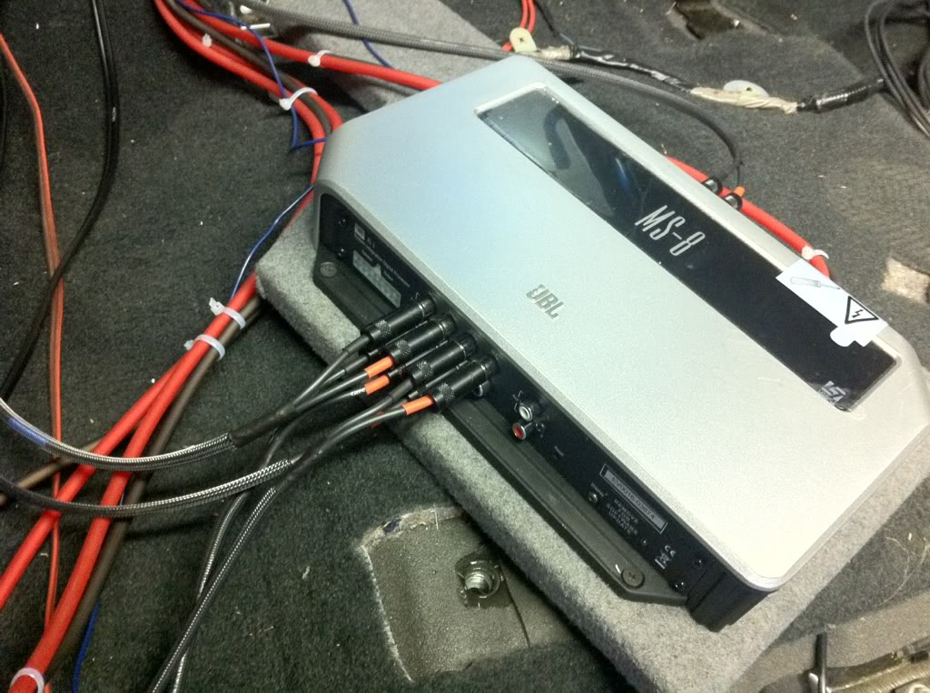

I finished building my RCAs and got them all hooked up to the MS-8.
So I went to turn the system on...nothing. I started chasing down wires and found out that my cd player's remote turn on output isn't functioning.
After messing around with that for a bit, I disconnected it and soldered the remote wire to 12v+ on ignition. Not ideal, but it'll work.
I was running out of time but I wanted to hear it play. I put on the headset microphones and let the MS-8 do it's sweeps.
I did get to hear music, it sounded alright until I turned it up. There's a weird clicking that sounds like it's coming from the right tweeter. Every time I hear the click, the lights on the head unit would dim.
I pulled the RCAs out of the MS-8 that fed that amplifier. Still heard clicking. I'm going to mess around with it more when I have more time. From what I did hear, it sounded great. I have a spare amplifier so hopefully it'll be as simple as swapping them out. If not, I'm going to have to run one amplifier 4 way (1" and 4") and the other 2 way (6"). I wish I had more time.

So after a lot of digging, testing and diagnosis it turns out 3 of my 4 PQ10 amplifiers don't work. One cuts out at loud volume, one doesn't turn on and only the right channel works on the last one.
So some rewiring was in order. What I did was power the tweeters off of the MS-8 and power the 4" and 6" off of the one PQ10 that works.
My install just became a lot simpler. LOL.

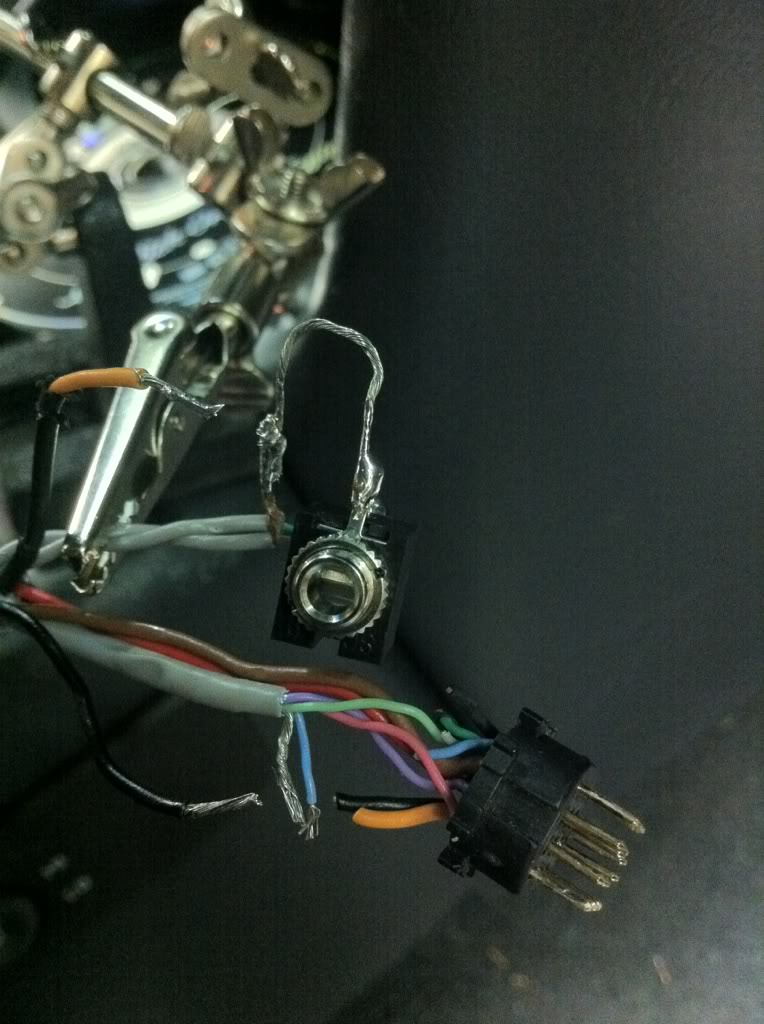

So, what's a guy to do if he has an incredible SQ deck that he's in love with from 1996 but wants to listen to mp3s on an iPhone or iPod?
Simple. You tear apart the cd changer's 13 pin cord.
After ALOT of testing and experimenting I finally got it to work properly, sort of.
I found out what pins carry the audio signal and I found out how to get the receiver to switch over and play that signal. The problem is once its switched over, you can't switch back.
To remedy this, I'll need to install a switch as well as the aux input. Flip the switch and listen to aux in, flip it back and the cd player and radio function again.
I'm going to look into a different style headphone jack. Maybe there's one that when you put the headphone cord into the jack it switches on and when you pull it out, it switches off. Circuit closed with the cord plugged in, open when removed.

I wired in a switch with my headphone jack. So that seems to be working now. I also ordered some abs plastic from parts express. I'm hoping it will be in tomorrow. Then I can start messing around with how I'm going to mount the switch.
