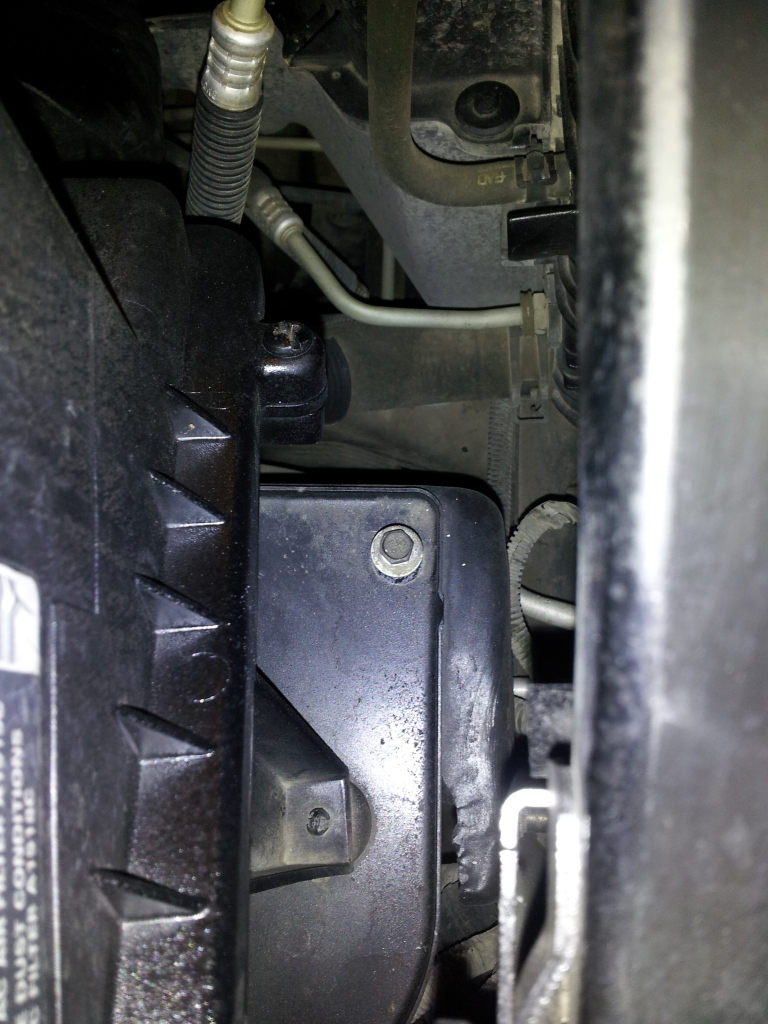

Well I got the lights mounted and they are awesome. My pattern isn't adjusted the greatest but since these denali lights done have left to right adjustment I might just have to live with it. Heres a few pics. It was late when I finished so I dont have any of them in the truck yet.
Started with the 4-hi mod so I could used the hi/lo feature of the morimoto projectors. On the pass side I used this bolt by the air box.

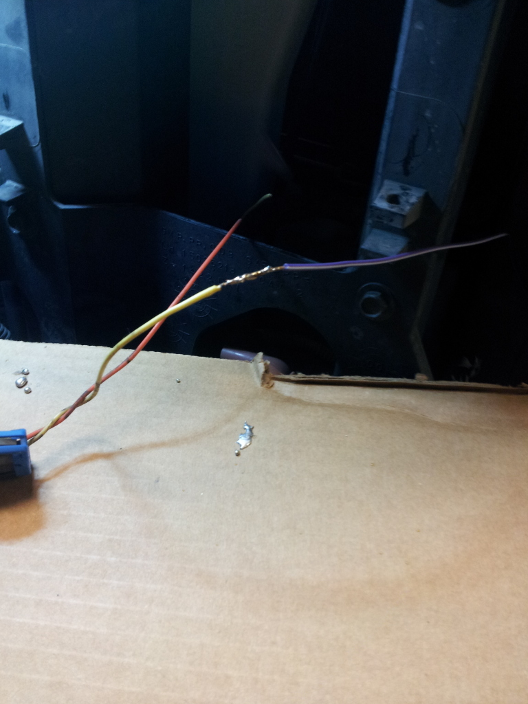

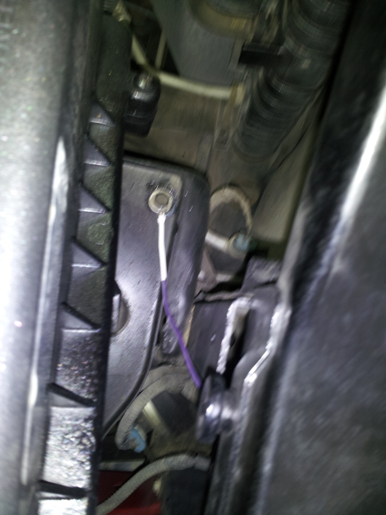

and I had heard of people lucking out and only having to ground 1 yellow wire, but it didn't work out for me.
Pass side
Drive

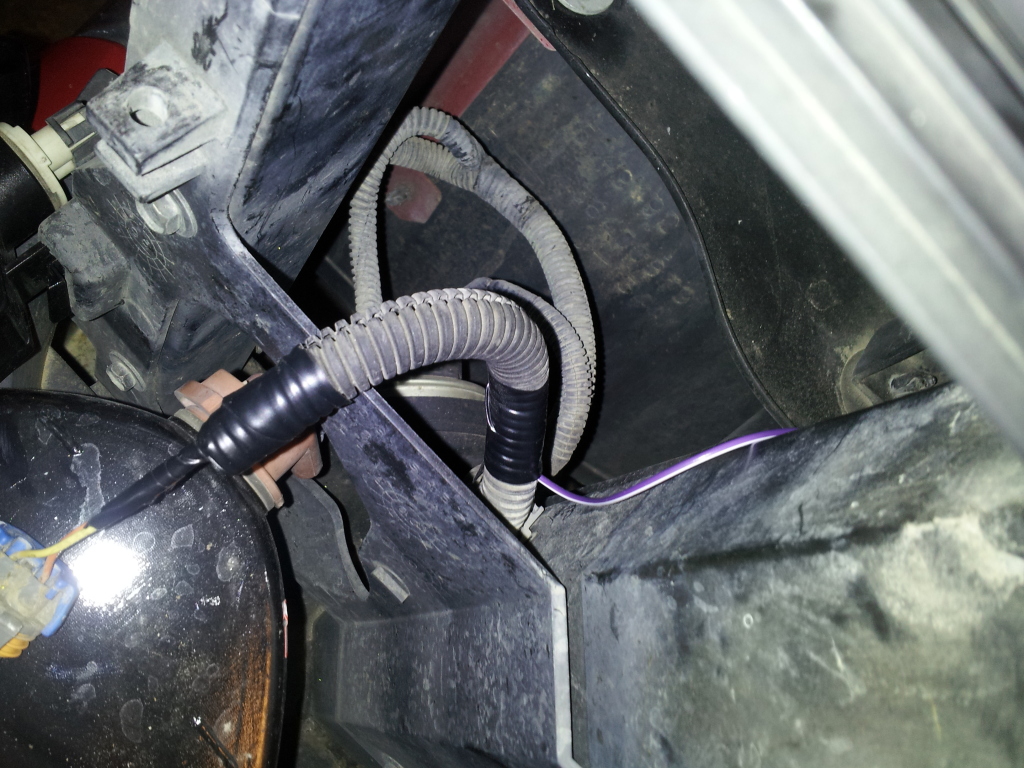

So I ended up having to do the driver side, which I used a bolt down on the side of the rad support. There are a couple under the battery that would work on the batt tray, but I didn't want to pull my battery out if I ever had to redo anything.
Here's where I cut my wires to add the new piece to ground. I searched for some yellow wire before finally giving up for this sweet purple wire I found.

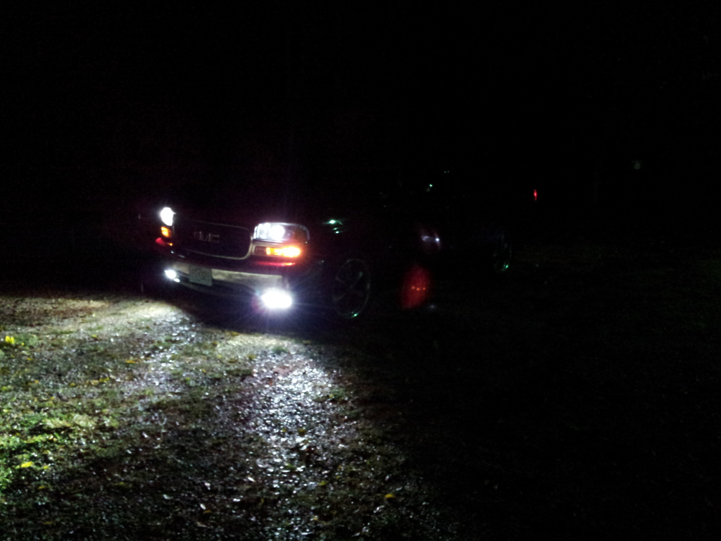

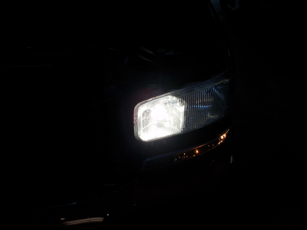

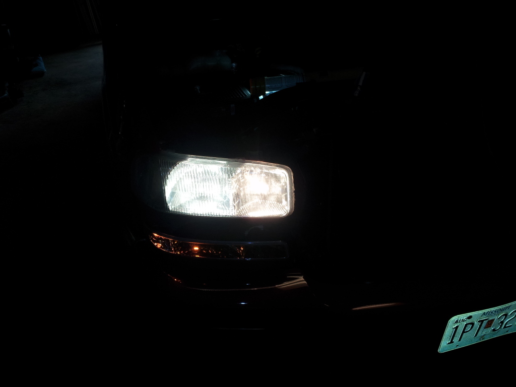

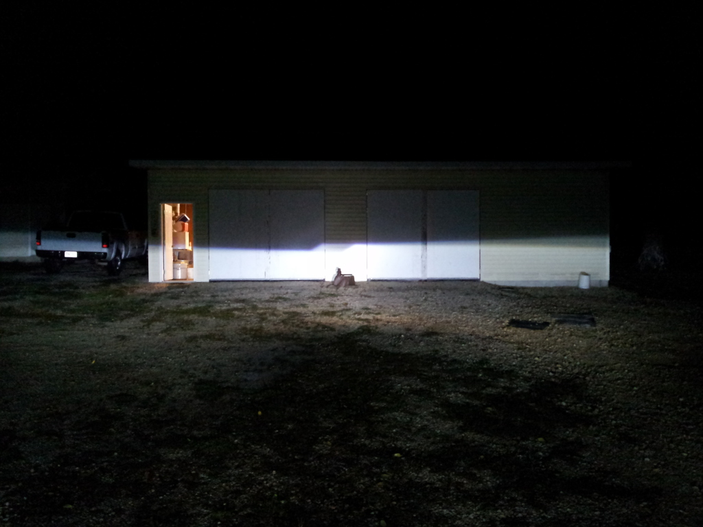

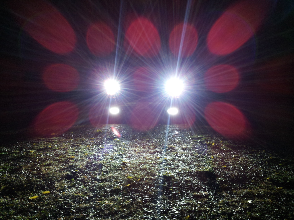

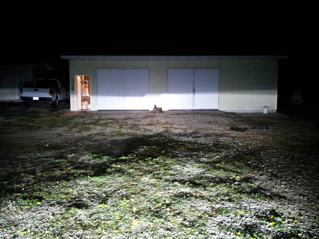

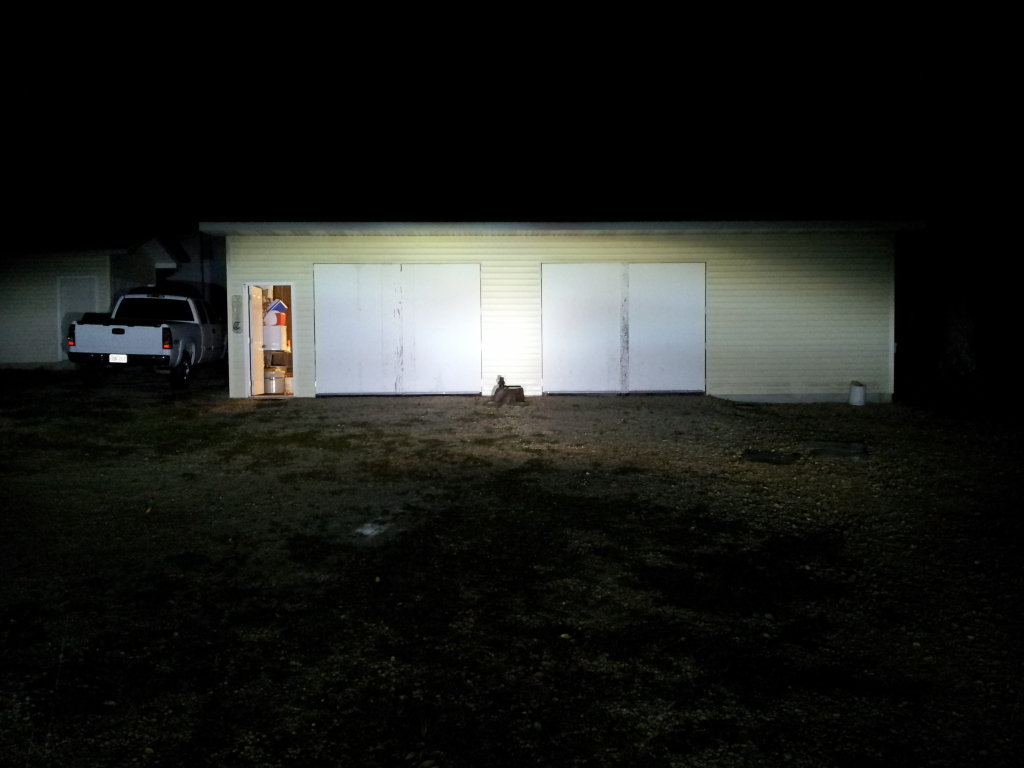

Finally got a few pics of the lights up and work
This is as close as I can get them since there's no left to right adjustment on the denali lights, and I can't rotate the projectors with the adapter plates i'm running.

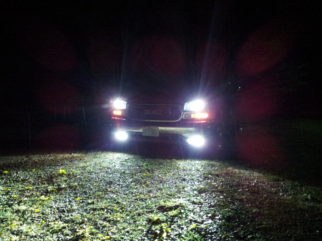

Low beams
lows with fogs
High beams
Few pics of the truck
below the cutoff

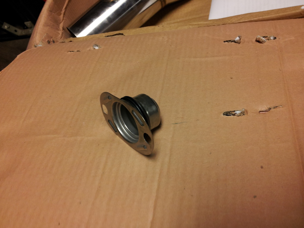

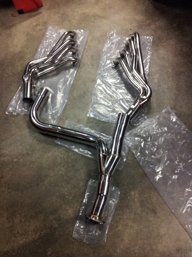

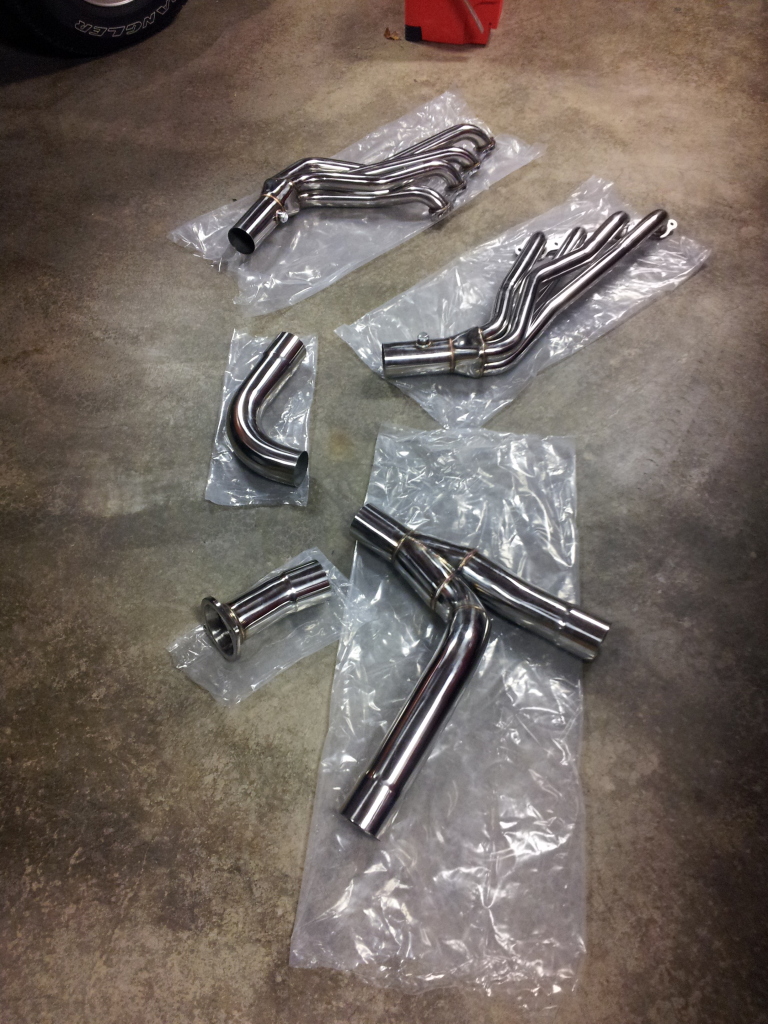

Got my headers and egr block off in, now I got to get to work. And ship out my comp to blackbear

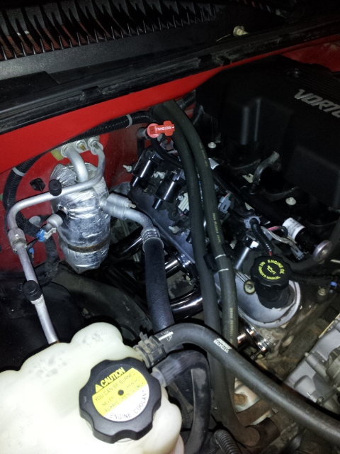

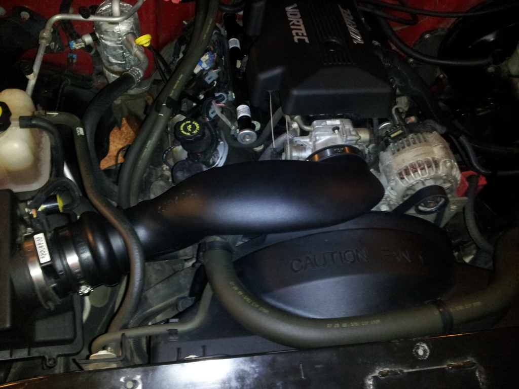

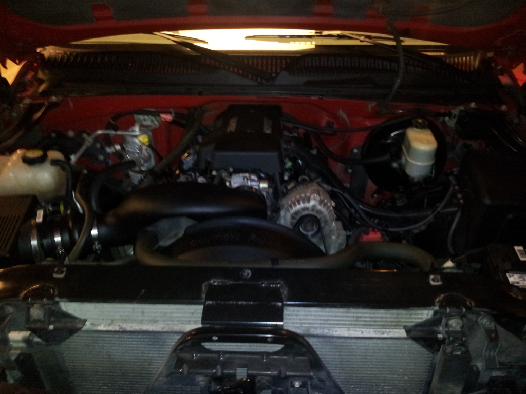

Forgot I moved my airaid jr intake pics in photobucket and broke a few links. Heres those pics.

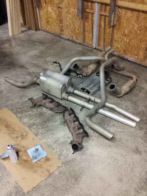

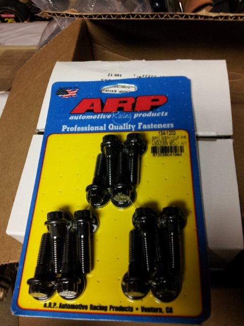

Also started installing the headers. Hit a few snags so it'll be awhile until she's up and running. Need to order some new manifold gaskets and spark plug wires. Also sending in my comp to black bear and they are going to sema this week, so thats another set back.
Did get the old exhaust removed though

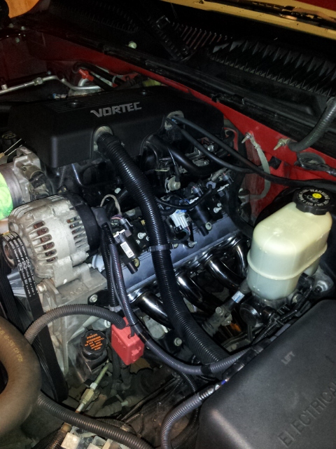

Also got the headers in position. Had to put the driver side in through the top, the pass side went right in from the bottom.
