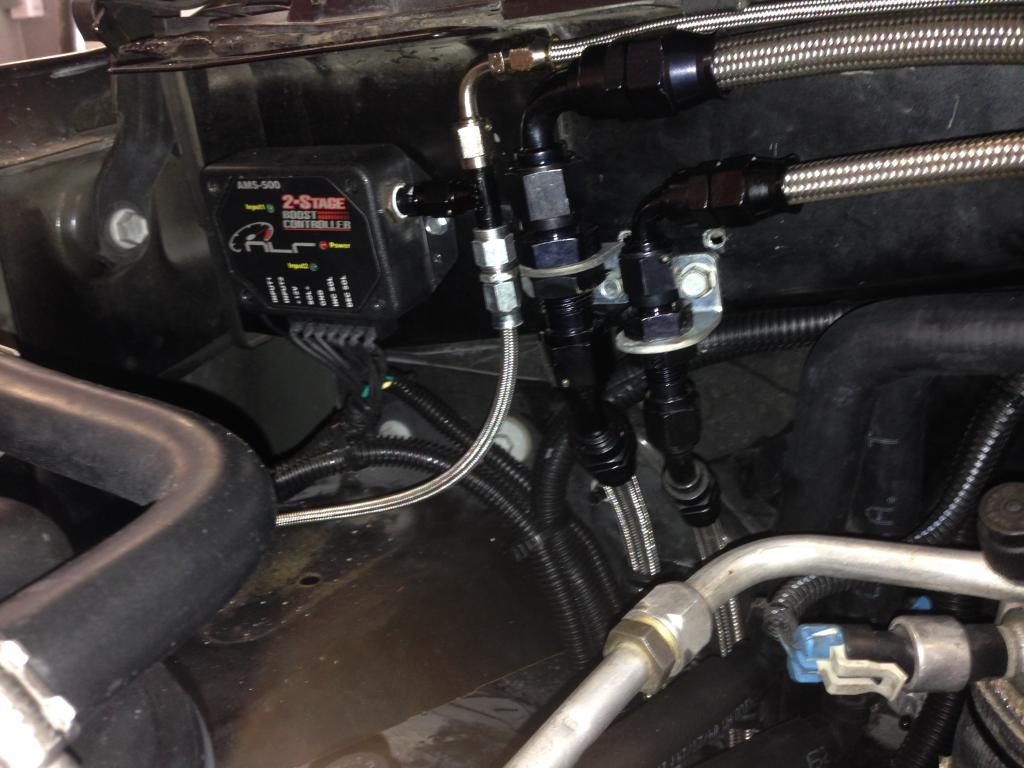

Ok so i fixed the damn noise. It was the fuel lines being attached to the firewall as seen in this pic. I removed them from the firewall and noise is gone.

Do you just have holes in your firewall now?

Yep..
