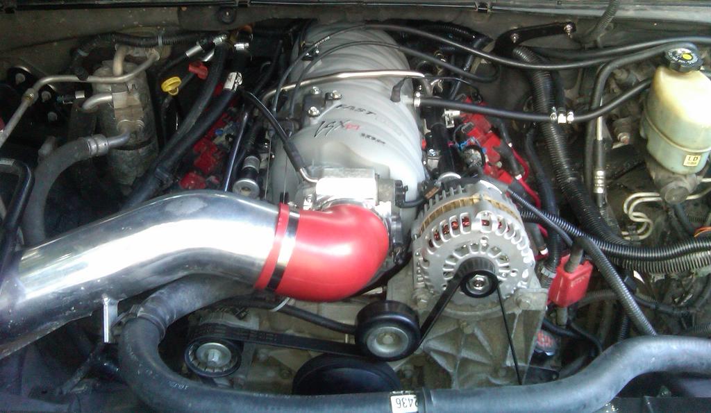

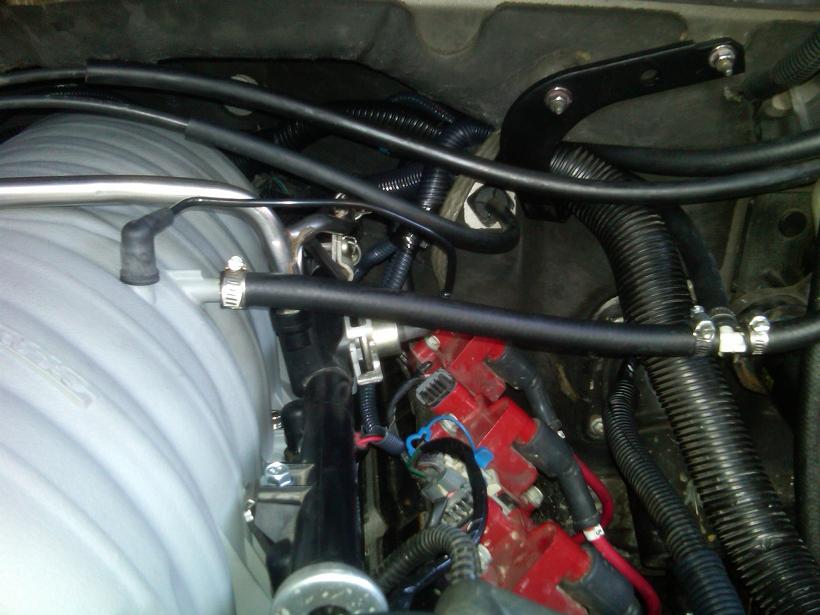

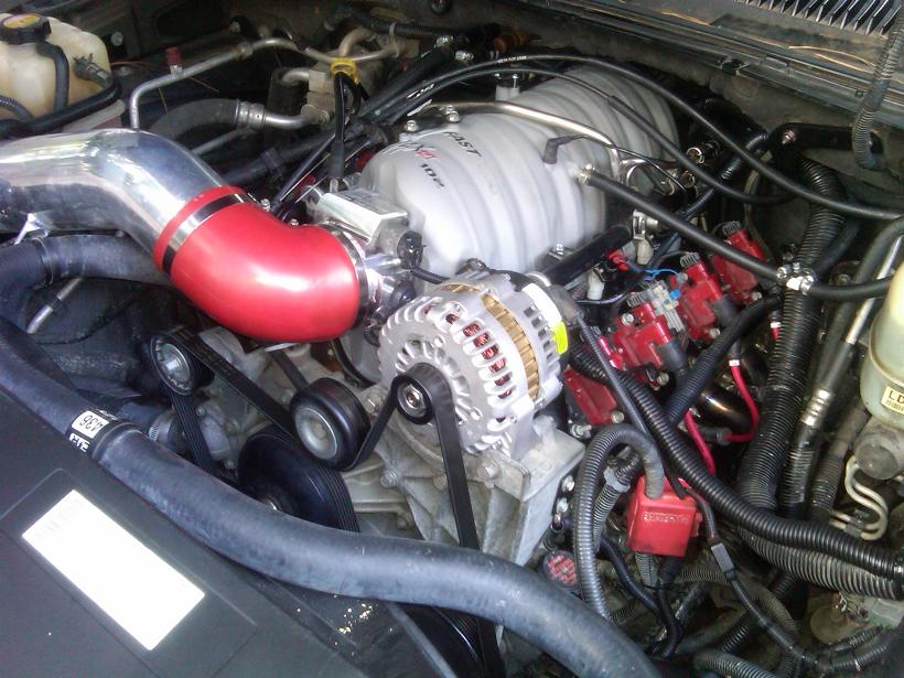

Put new copper TR6 plugs in and re-routed some more wiring. Still a rats-nest of wiring and tubes, but that's as clean as it'll get in this chassis.

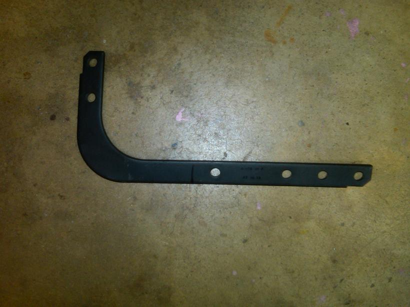

made this bracket to hold the main wiring harness out of the way. The EVAP solenoid is also behind there.

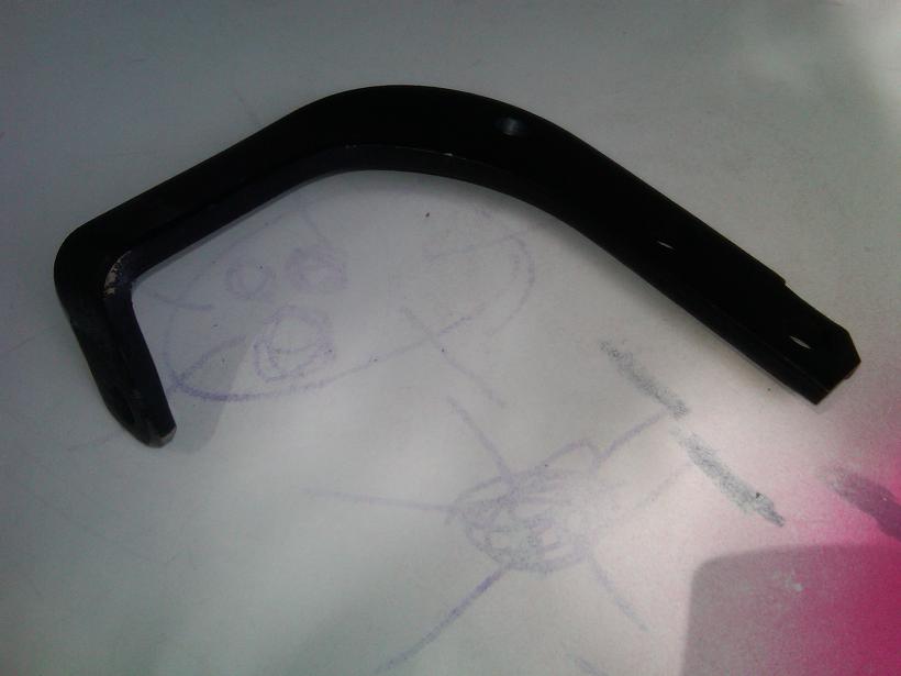

Started life as a garage door bracket.
a little cutting bending and drilling:

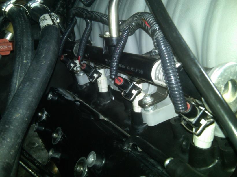

I also eliminated the injector plug adapters and soldered the connectors directly to the harness. I'm running FAST 36lb injectors.
