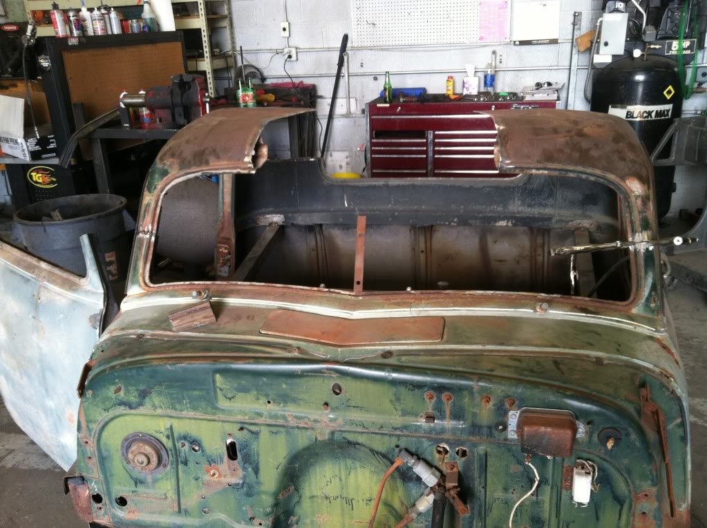

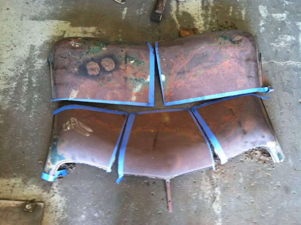

Finally have some things to update. Since last time, the holidays have come and gone, and we popped out our second kid in march. Finally home life has calmed down enough for me to get away to the shop to progress on this undertaking. Previously I had whacked 4" out of the top. But that is the easy part. The hard part is making it all fit back together again.
Cut lines to make it all fit

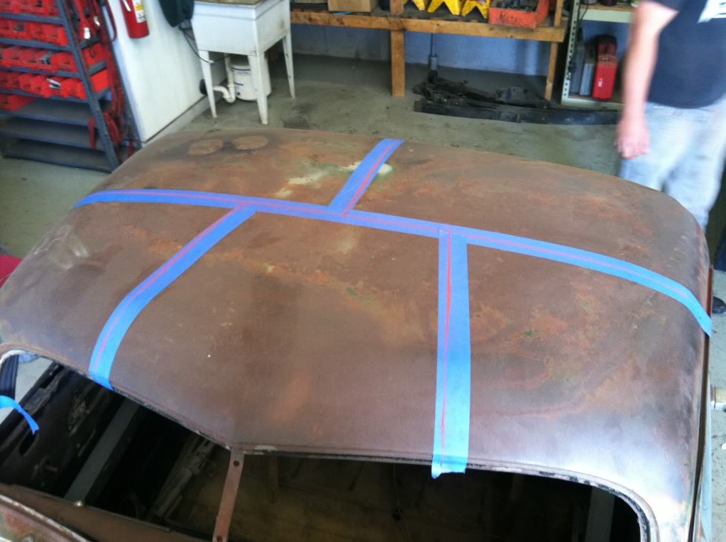

Cut into pieces
![Name: null-5.jpg
Size: 129.9 KB](https://www.performancetrucks.net/forums/attachments/projects-gallery-189/116414d1501288379-dont-call-rat-rod-null-5.jpg)

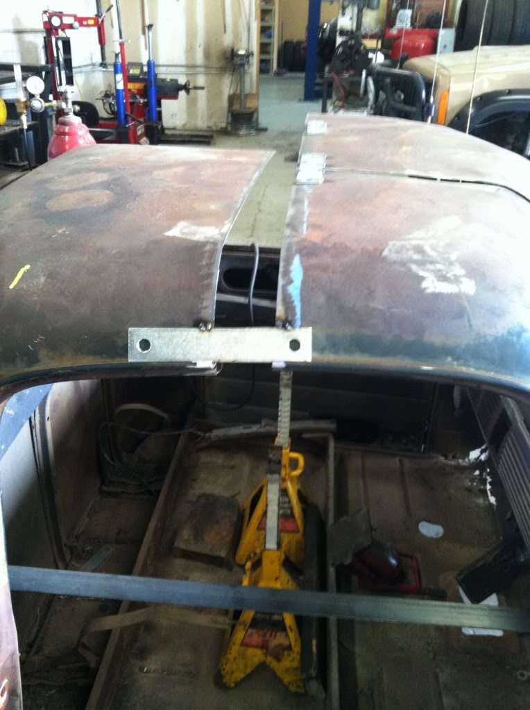

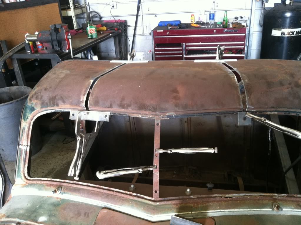

Started at the windshield posts
![Name: null-7.jpg
Size: 157.4 KB](https://www.performancetrucks.net/forums/attachments/projects-gallery-189/116415d1501288379-dont-call-rat-rod-null-7.jpg)
Center getting put in place

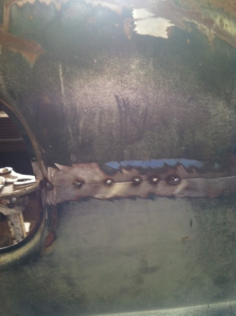

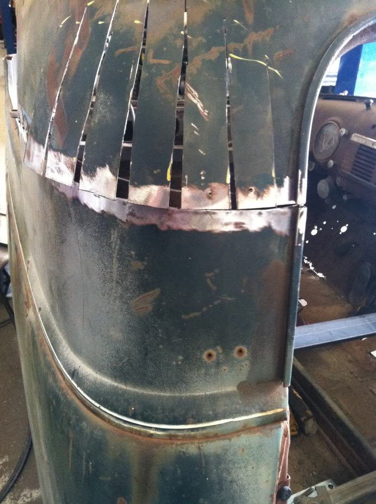

Relief cuts to get it to line up
![Name: null-21.jpg
Size: 156.1 KB](https://www.performancetrucks.net/forums/attachments/projects-gallery-189/116419d1501288379-dont-call-rat-rod-null-21.jpg)

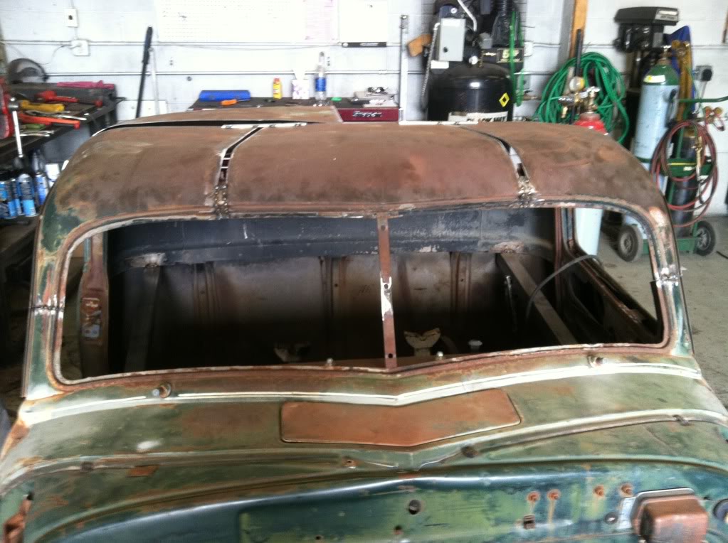

And near back window tacked in
![Name: null-4.jpg
Size: 95.3 KB](https://www.performancetrucks.net/forums/attachments/projects-gallery-189/116413d1501288379-dont-call-rat-rod-null-4.jpg)
Cut into pieces
![Name: null-5.jpg
![Name: null-7.jpg
![Name: null-21.jpg

So I still need to fill all the gaps with sheet metal and put the door frames back together. Lots left to do, but I ran out of energy and helping hands for today.
