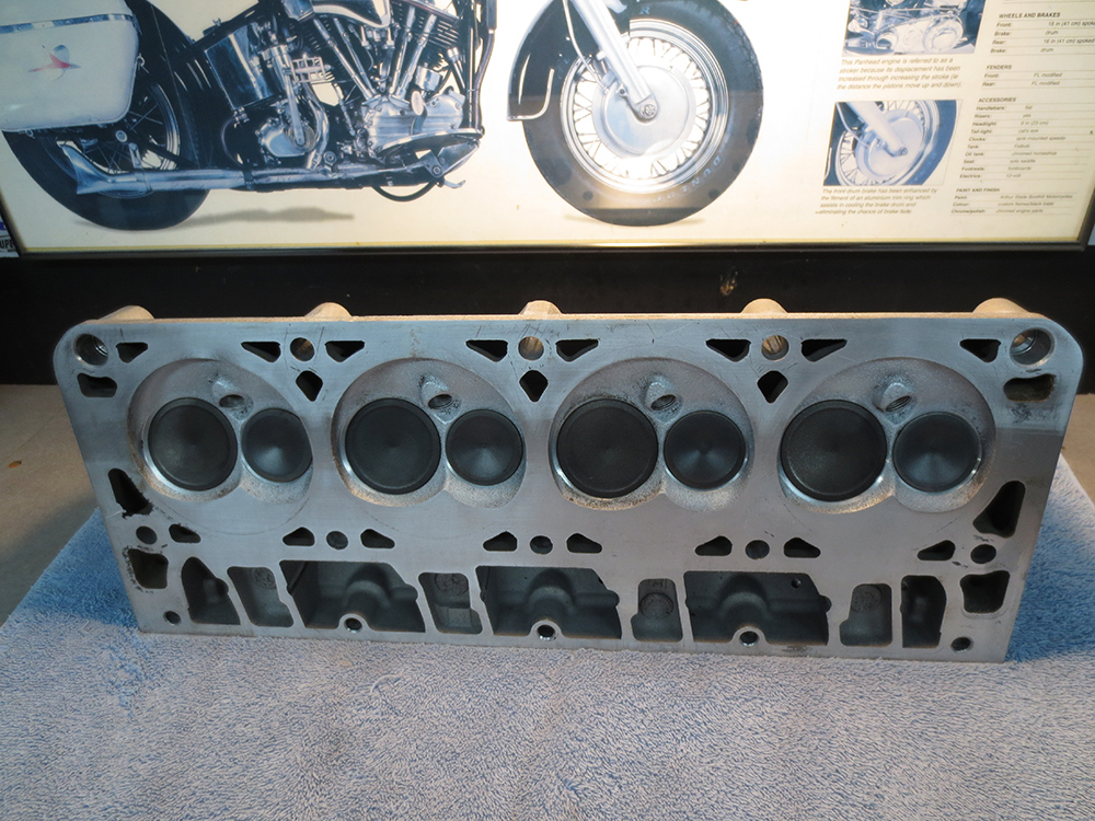

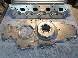

Tear down and cleaning
![Project "Rebel Yell"-7rmwmi1.jpg](https://www.performancetrucks.net/forums/attachments/projects-gallery-189/154884d1683126909t-project-rebel-yell-7rmwmi1.jpg)
![Project "Rebel Yell"-hjzlhna.jpg](https://www.performancetrucks.net/forums/attachments/projects-gallery-189/154885d1683126909t-project-rebel-yell-hjzlhna.jpg)
![Project "Rebel Yell"-fpjztim.jpg](https://www.performancetrucks.net/forums/attachments/projects-gallery-189/154886d1683126909t-project-rebel-yell-fpjztim.jpg)
![Project "Rebel Yell"-8nasjww.jpg](https://www.performancetrucks.net/forums/attachments/projects-gallery-189/154887d1683126909t-project-rebel-yell-8nasjww.jpg)
![Project "Rebel Yell"-cazk2nx.jpg](https://www.performancetrucks.net/forums/attachments/projects-gallery-189/154888d1683126909t-project-rebel-yell-cazk2nx.jpg)
![Project "Rebel Yell"-znlufbb.jpg](https://www.performancetrucks.net/forums/attachments/projects-gallery-189/154889d1683126909t-project-rebel-yell-znlufbb.jpg)
![Project "Rebel Yell"-ilhq6i5.jpg](https://www.performancetrucks.net/forums/attachments/projects-gallery-189/154890d1683126909t-project-rebel-yell-ilhq6i5.jpg)
![Project "Rebel Yell"-k6ge4lz.jpg](https://www.performancetrucks.net/forums/attachments/projects-gallery-189/154891d1683126909t-project-rebel-yell-k6ge4lz.jpg)

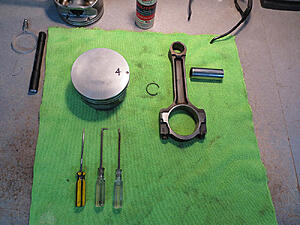

Assembly begins:
![Project "Rebel Yell"-9langmm.jpg](https://www.performancetrucks.net/forums/attachments/projects-gallery-189/154892d1683126909t-project-rebel-yell-9langmm.jpg)
![Project "Rebel Yell"-da2touv.jpg](https://www.performancetrucks.net/forums/attachments/projects-gallery-189/154893d1683126909t-project-rebel-yell-da2touv.jpg)

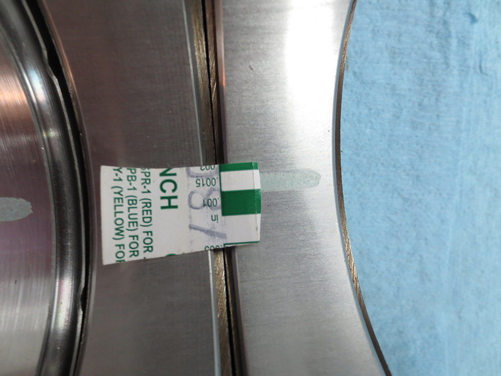

Sloppy Stage II cam 228/230 .585/.585 112* with PAC 1218 springs.
![Project "Rebel Yell"-fdybzn3.jpg](https://www.performancetrucks.net/forums/attachments/projects-gallery-189/154894d1683126909t-project-rebel-yell-fdybzn3.jpg)
![Project "Rebel Yell"-6dt51md.jpg](https://www.performancetrucks.net/forums/attachments/projects-gallery-189/154895d1683126909t-project-rebel-yell-6dt51md.jpg)
![Project "Rebel Yell"-5qaeoep.jpg](https://www.performancetrucks.net/forums/attachments/projects-gallery-189/154896d1683126909t-project-rebel-yell-5qaeoep.jpg)

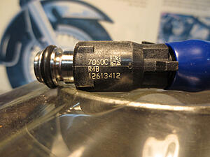

New Throttle Body and 50lb Flex Injectors
![Project "Rebel Yell"-soavdvt.jpg](https://www.performancetrucks.net/forums/attachments/projects-gallery-189/154900d1683126909t-project-rebel-yell-soavdvt.jpg)

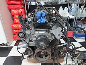

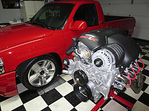

Finished with the engine
![Project "Rebel Yell"-9mns5fs.jpg](https://www.performancetrucks.net/forums/attachments/projects-gallery-189/154871d1683126909t-project-rebel-yell-9mns5fs.jpg)
Speed Engineering Headers and Tru-Duals
![Project "Rebel Yell"-qzni1ge.jpg](https://www.performancetrucks.net/forums/attachments/projects-gallery-189/154872d1683126909t-project-rebel-yell-qzni1ge.jpg)

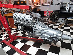

LQ9 and Transmission on the hook.
![Project "Rebel Yell"-t1samco.jpg](https://www.performancetrucks.net/forums/attachments/projects-gallery-189/154878d1683126909t-project-rebel-yell-t1samco.jpg)
![Project "Rebel Yell"-hxzmuod.jpg](https://www.performancetrucks.net/forums/attachments/projects-gallery-189/154879d1683126909t-project-rebel-yell-hxzmuod.jpg)
Installed most of the harness and pressed on the power steering pulley. Waiting for new Knock Sensors and Harness to arrive. Test fitted the intake to see where the modified V6 to V8 fuel line fit.
![Project "Rebel Yell"-5hqa07k.jpg](https://www.performancetrucks.net/forums/attachments/projects-gallery-189/154880d1683126909t-project-rebel-yell-5hqa07k.jpg)

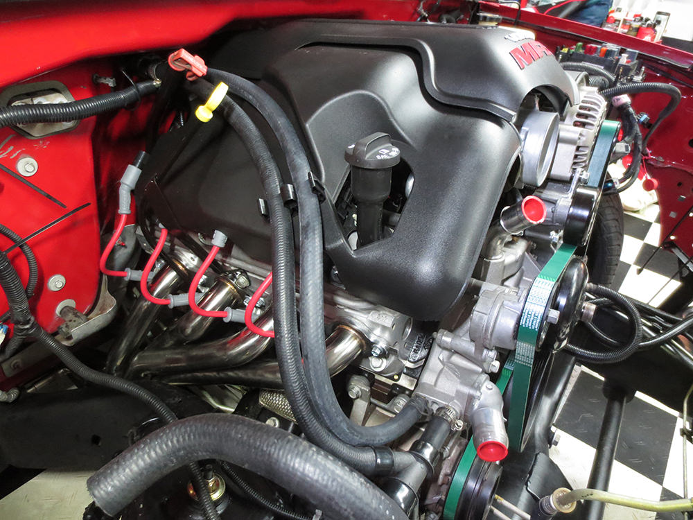

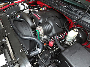

Today's finished work: AC Delco knock sensors installed, intake, injectors connected & coil packs, new PRNDL switch, trans wired, torque converter bolts, starter, crossmember, belts, test fitted CAI tube & fan for clearance = ok. (some owners with the AFE CAI have fan clearance issues)
Tomorrow: Install header & exhaust, o2 sensors, plugs & plug wires, heater hoses, driveshaft, core support, radiator & hoses, fan & shroud, a/c condenser, a/c accumulator, a/c lines, trans cooler, CAI, PCM, fluids, battery.
![Project "Rebel Yell"-10771mg.jpg](https://www.performancetrucks.net/forums/attachments/projects-gallery-189/154865d1683126909t-project-rebel-yell-10771mg.jpg)
![Project "Rebel Yell"-joo0tz4.jpg](https://www.performancetrucks.net/forums/attachments/projects-gallery-189/154866d1683126909t-project-rebel-yell-joo0tz4.jpg)
![Project "Rebel Yell"-ol94xon.jpg](https://www.performancetrucks.net/forums/attachments/projects-gallery-189/154867d1683126909t-project-rebel-yell-ol94xon.jpg)

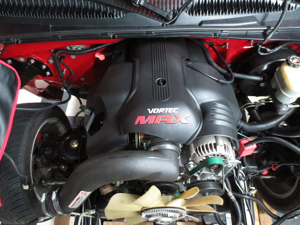

Next on the list after I bust some gas. I need to find a 34" radiator too.
__________________________________________________ ________
Today: Installed header & dual exhaust, o2 sensors, driveshaft. Then filled oil filter to finish underneath.
Up Top: plugs & plug wires, heater hoses, oil dipstick.
Should finish up tomorrow: core support, radiator & hoses, fan & shroud, a/c condenser,
a/c accumulator, a/c lines, trans cooler, CAI, PCM, front bumper, fluids, battery.
![Project "Rebel Yell"-65lr1ge.jpg](https://www.performancetrucks.net/forums/attachments/projects-gallery-189/154859d1683126909t-project-rebel-yell-65lr1ge.jpg)
